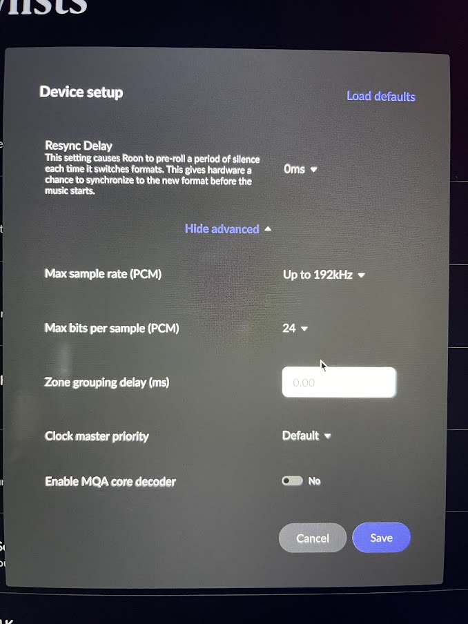

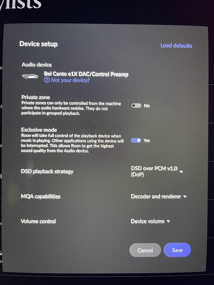

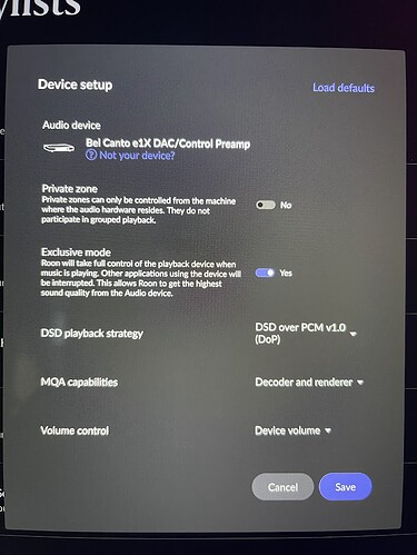

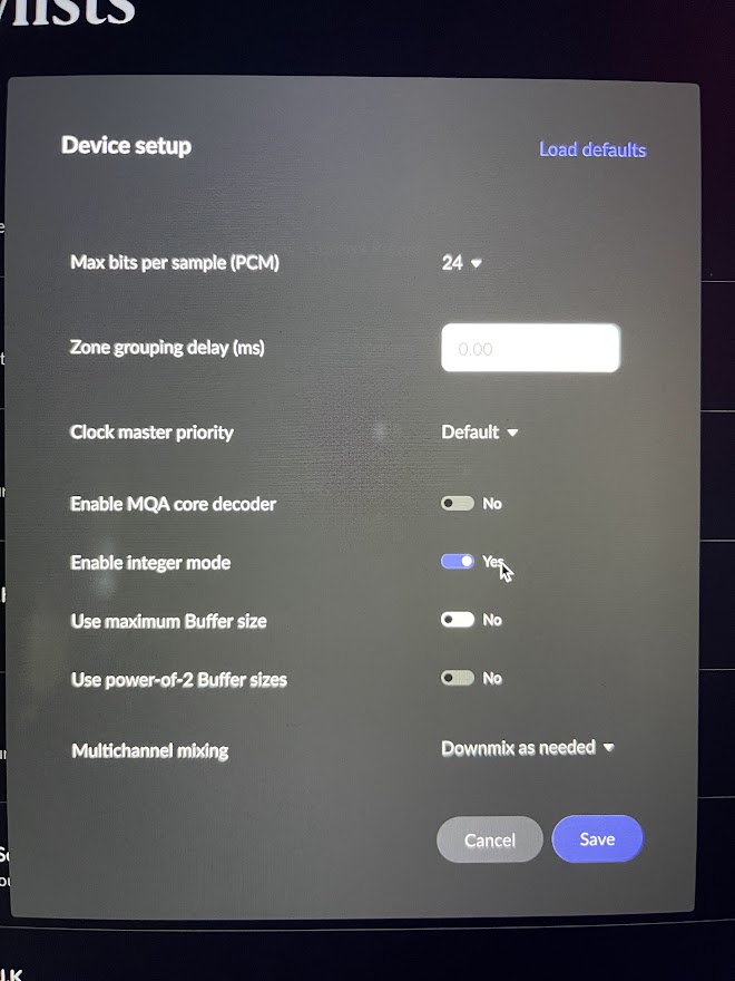

Bel Canto E1X DAC setting :
  • Exclusive mode
  • MQA Encoding/Decoding
  • 24bit, 192k
  • DSD DoP 1.0
  • integer…something

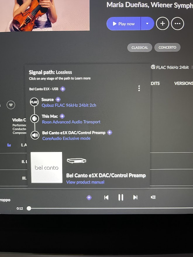

Hey @Jin_Kim1,
Interesting! Based on your core diagnostics, we saw a 30khz lowpass filter and 6db gain applied to the Bel Canto E1X.
If you could, please send over a screenshot of your signal path when the noise occurs?

It’s Device setup and Signal capture when I playing 96k with noise.
