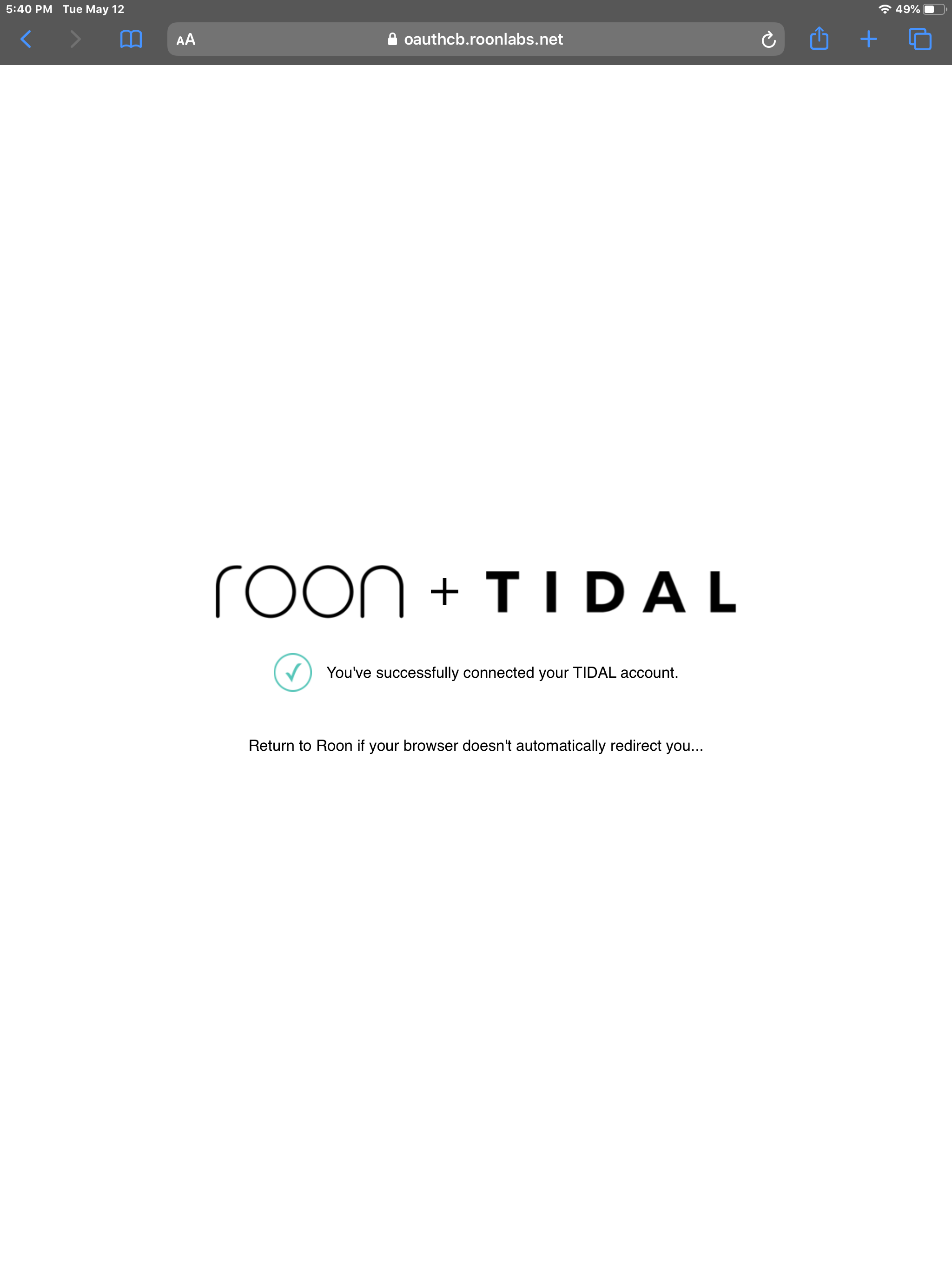

I have a 2011 Mac Mini running Core. I have been unable to connect to Tidal even though I receive the ‘You’ve successfully connected to your Tidal account message’.

When I try to login from the Mac Mini, it is stuck in Safari and does not make it to the login page. I am able to complete the login process when using my iPad and Roon app. Again, it appears to complete, however, when I check Settings/Services, it shows that Tidal is not configured.

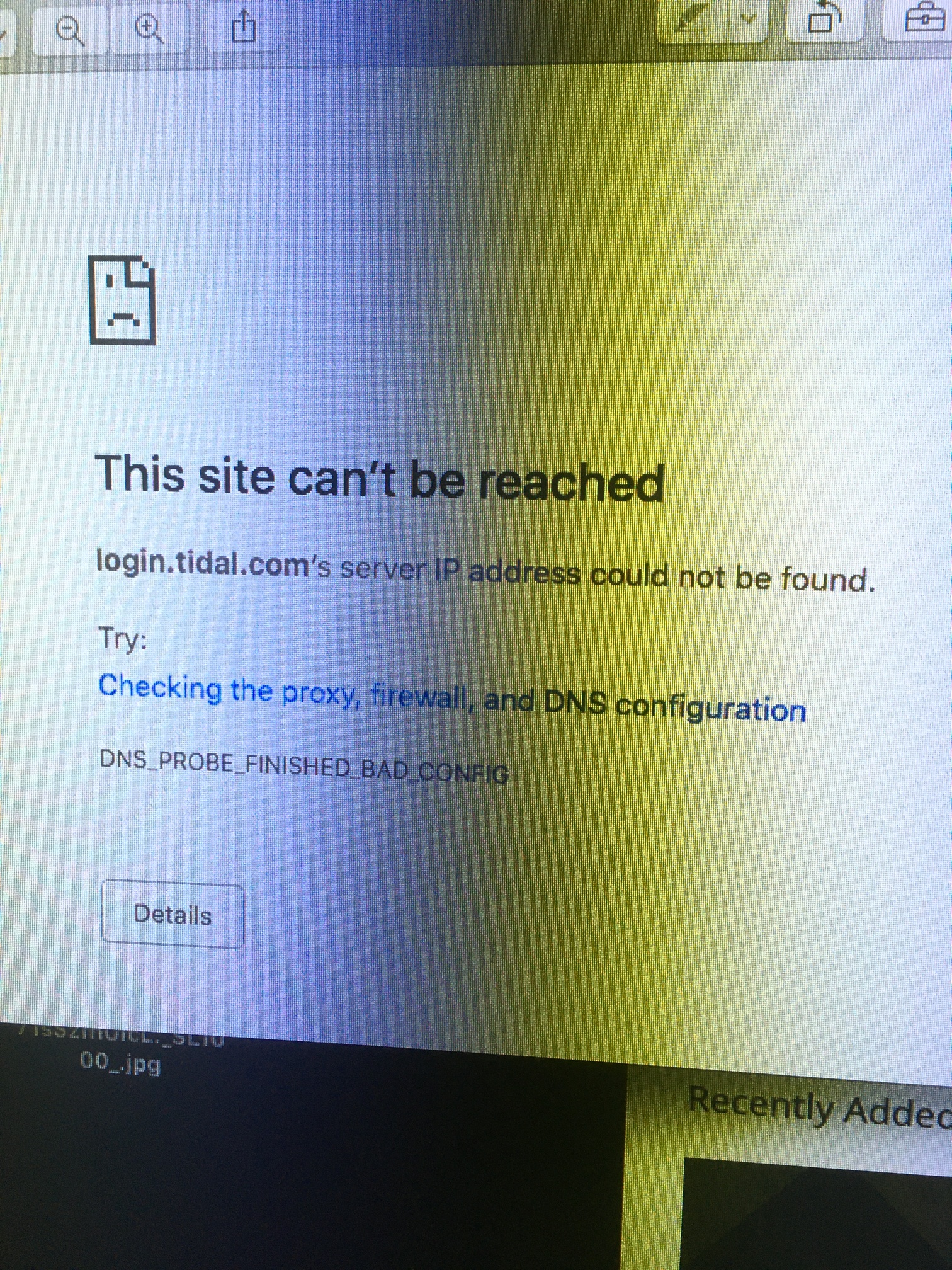

I tried a different browser (Chrome) …
login.tidal.com’s server IP address could not be found.

I just tried logging out of TIDAL and back in on my end and I’m not seeing any issues. How are your router’s DNS server set up?
You could try chaining the DNS to Cloudflare DNS, Quad9 or Google DNS, perhaps the default ones you have from the ISP are unreliable.
Can you please give this a try and let me know if it helps?

I can log in successfully using the Roon app, however, there is no change as to whether Tidal is configured … isn’t this the same as trying from the Mac mini?
Hi @Derrick_McLeod,
If you are seeing the success message, TIDAL should be logged in properly.
What are you seeing under Roon Settings -> Services, does it show that TIDAL is still logged out?
It shows Tidal as Not Configured with the Login button on the right side.

In trying to upload the zip file, I discovered I was getting the same message for other sites … I ended up going through Network Diagnostics to resolve the DNS issue. I am now able to sign on to Tidal with the Mac mini and it is working successfully. Thanks for all your help.
