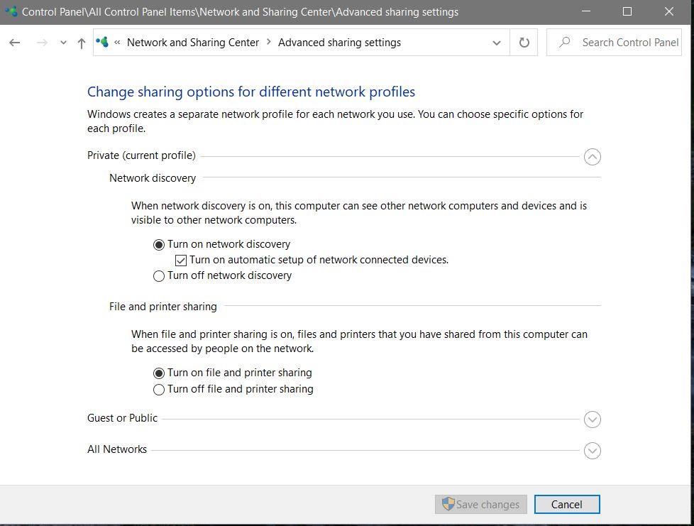

I suspect the issue may be the network configuration on the Microsoft Surface system. On the Surface, both the “Network discovery” and “File and printer sharing” are both turned on.
Do you have suggestions about the network configurations/setting? Another area to look at?

Have you added roon to its firewall?
Does any antivirus software think the surface is connected to a public network rather than home network? That caught me out a couple of days ago.
(and was my own fault for misconfiguring it in the first place… )
Also make sure other than firewall off is that you are NOT on a guest WiFi network
Hi @David_Walp,
As mentioned above, the most common reason this issue can occur is because the firewall on the device is blocking the connection. You can try disabling the firewall temporarily and if it shows up you’ll just need to enter exceptions in for Roon and RAATServer and you’ll be good to go!
