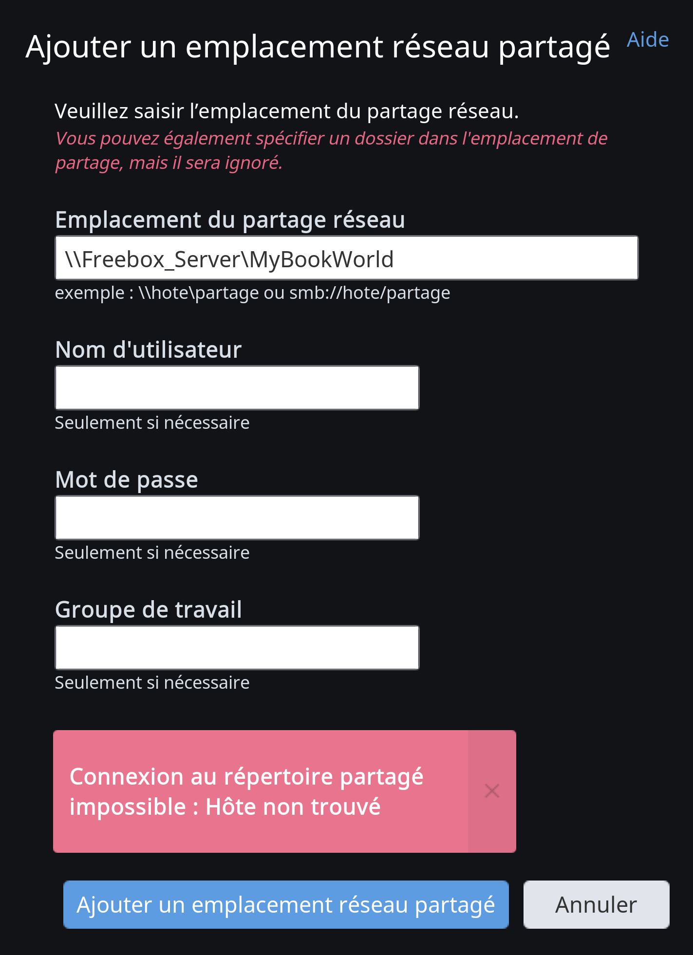

I am trying to understand my router but too many things “knew” to me…
I do not know how to find the path for Roon to find the MyBookWorld. Apparently the hard drive is known as a NAS under the name of MyBookWorld but I am not sure…
My guess, would be under Partages Windows?
GOOOOD it should be Freebox_Server but….
Not working
but I cannot even acces via internet explorer… I have to search my router setup again

Hi @Digipat,
Based on your screenshot, you may want to give these a try in Roon:
Emplacement du partage resau: \\Freebox_Server OR \\192.168.1.1\Freebox_Server
Nom d’utilisateur: (leave empty)
Mont de passe: (leave empty)
Groupe de travail: WORKGROUP
If these settings do not work, I would clarify with the router manufacturer further.
– Noris
Thanks Scott G but even if my Core is not on this computer? I use a Nuk with rock
Boris, I tried both bit no result. I am going to investigate and I’ll be back to give the solution here… I hope
