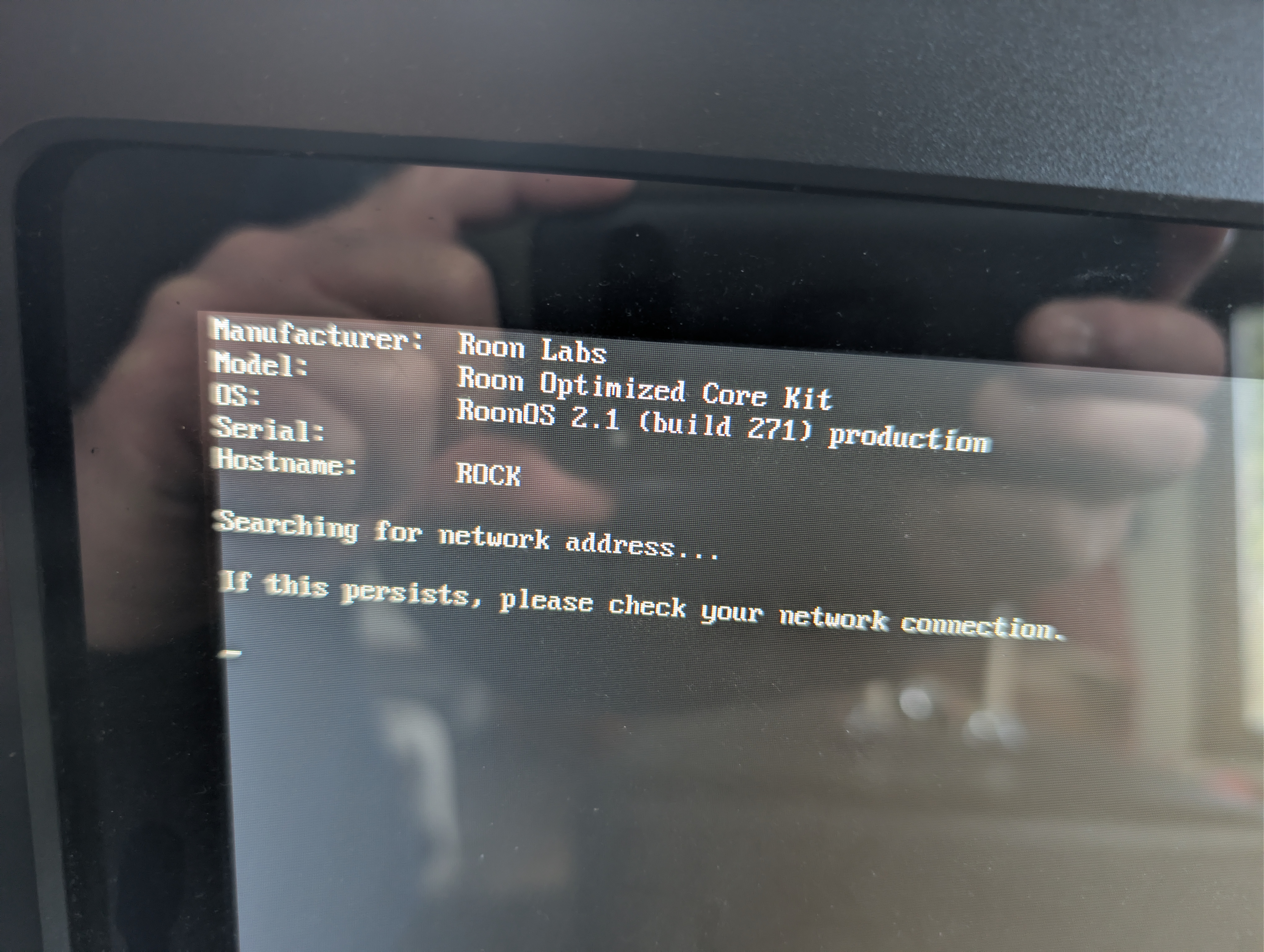

Just installed Starlink. Coming from a Rogers 5G service in which roon worked. NUC hangs during boot "searching for Network address". OS is 2.1 (build 271). NUC is hardwired to tplink switch which is working and running a separate mesh router so know it is operational. There is no indicator light on the switch showing that the NUC is connecting. I have cleaned out the NUC and cleaned the ethernet port using a swab and alcohol. What am I missing?
Starlink Mini UTR-251 ethernet cable to TP link sg105. NUC 10i5

I am confused. I am using a NUC not a Nucleus.
Same instructions apply. At the prompt in your pic..
  • Press ENTER
  • Type resetnetwork
  • Press ENTER
Thanks for that. I have done the above and when asked if i wish to reset network i hit enter and the screen went back to the picture as above.
I rebooted the system and same message.
