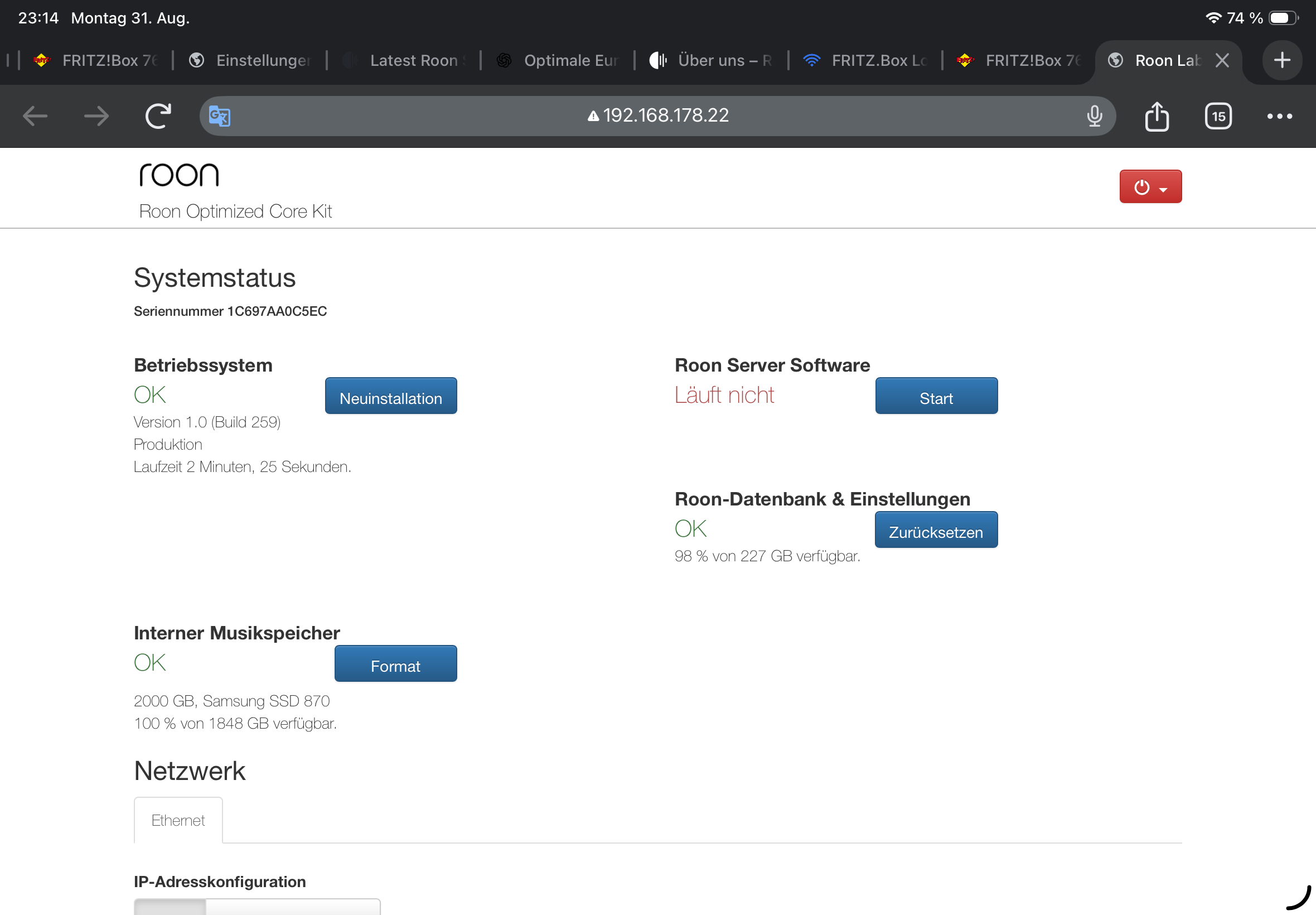

I disconnected my server yesterday around 6pm an after this- i only submitted files on my external ssd - my Nuc Server is not running anymore. i restart it via my Fritz!box. But no chance
Nuc Roon Rock 1C697AAOC5EC as Server

Thank you for reaching out and providing the screenshot. I can see from the interface that the Roon Server Software is currently showing as “Not running” (Läuft nicht).
Please try clicking the Start button under the Roon Server Software section.
If the server fails to start after clicking that button, proceed with reinstalling the operating system directly from this Web UI:
  1. Click the Neuinstallation (Reinstall) button under the Betriebssystem section.
  2. Allow the process to complete and the system to reboot.
This reinstallation process will only refresh the Roon OS system files. It is completely safe and will not touch or delete your Roon database, settings, or stored music files.
If the Roon Server software still does not start after the OS reinstallation finishes, please reply to this thread so we can investigate further.
Hallo - habe ich durchgeführt. Hat leider nicht funktioniert. Meldung - Status Failure - exitcode 43. What to do?

The “exitcode 43” error indicates that the current operating system partition is corrupted or cannot process the system update package locally. To resolve this, you will need to perform a full manual reinstallation of Roon OS using a USB flash drive.
Just like the Web UI reinstall, this USB flash process is designed to only overwrite the Roon OS system files, leaving your database and SSD music files intact. However, to be absolutely safe, I highly recommend verifying your backups before proceeding.
