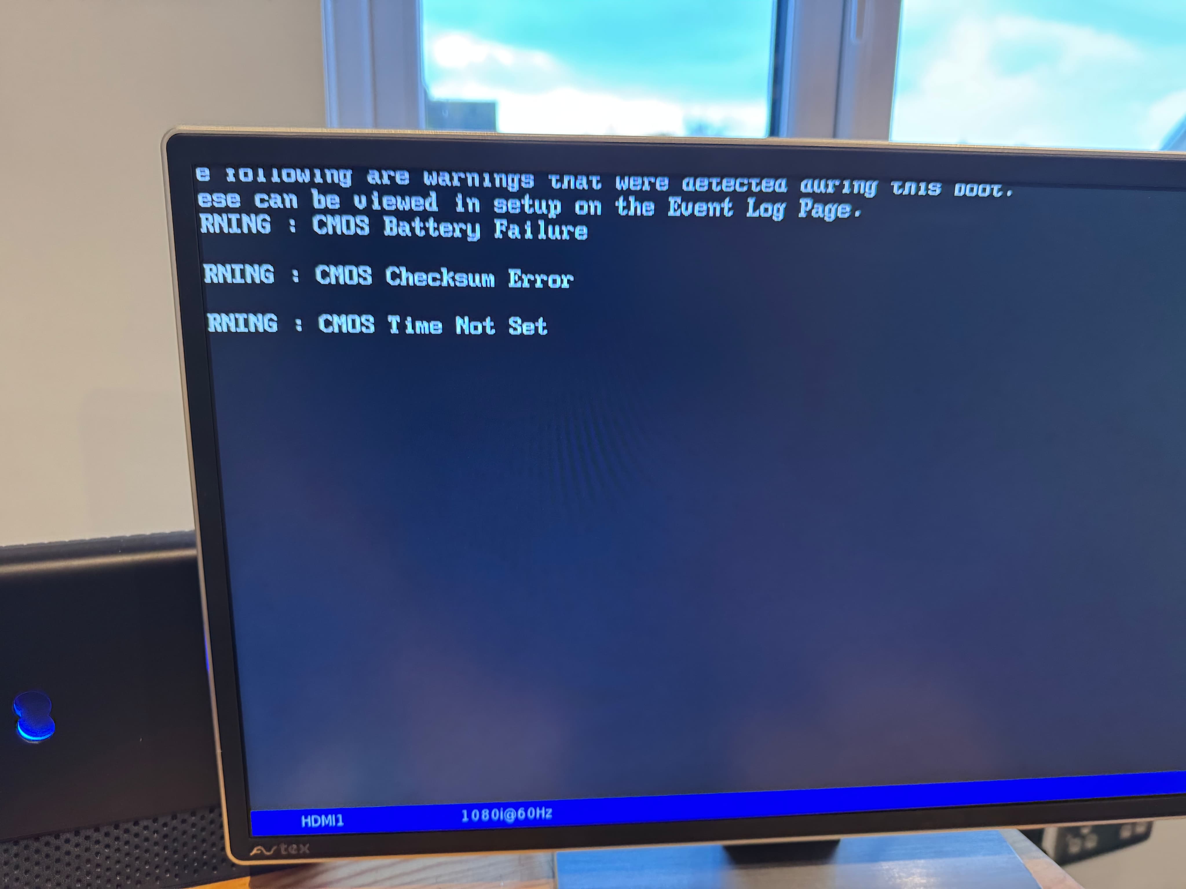

OK I Managed to connect. I drained all residual power by disconnecting then holding down power button etc. on reconnecting the message attached popped up then disappeared.
Saying: warning: e
tollowing warnings tat were detected during this boot.
ese can be viewed in setup on the fuent Log Page.
RNING : CMOS Battery Failure
RNING : CMOS Checksum Error
RNING: CMOS Time Not Set
Hi @Julie_Meikle,
Thanks for all of the additional information! It is clear you’re unfortunately suffering from a hardware-related failure on the Nucleus. The CMOS battery to be specific. The best next steps here would be to get in touch with our Nucleus RMA team to send the unit in for repair.

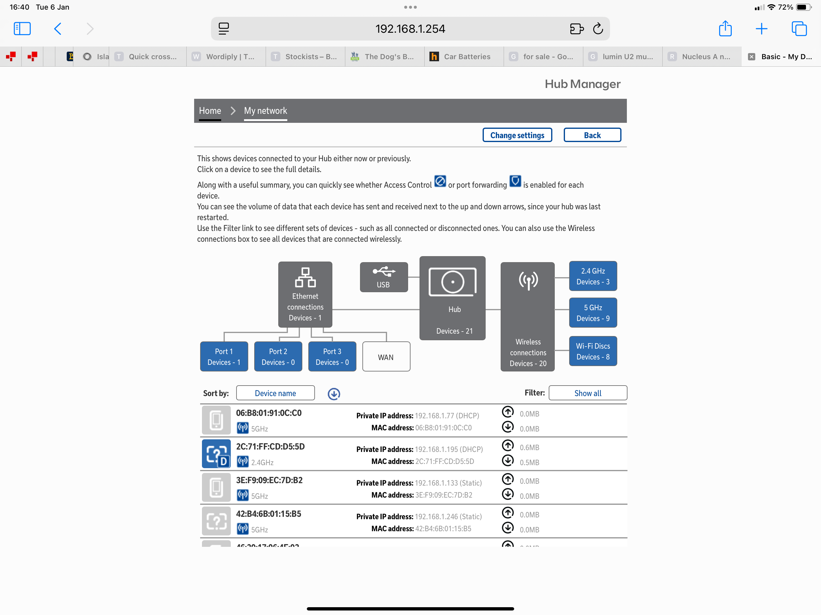

Also the router is not showing connection to the nucleus only the mac

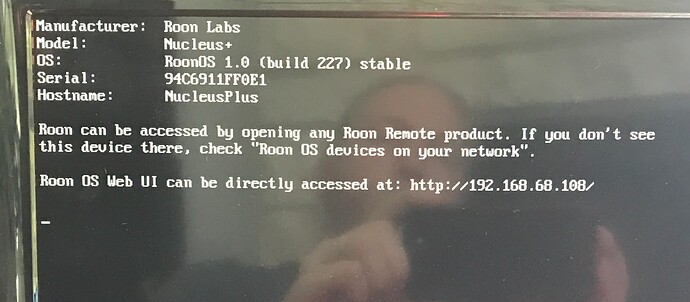

Could you please confirm whether you do not see any of the following information on the screen when the Nucleus is connected to a monitor or TV via HDMI?
If the screen remains completely black, as you mentioned, this may indicate an OS-level issue, potentially caused by the recent power outage.
