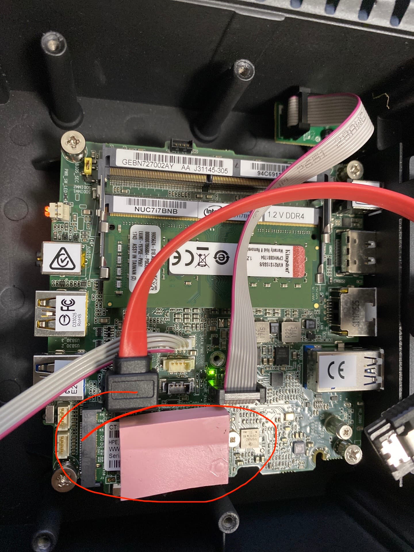

For reference. This is my Nucleus+ rev A. I’ve circled the M.2 SSD on which RoonOS is installed.
In order to access it, you’ll have to remove the drive cage for the optional internal SSD on which music can be stored.
FYI the pink thing on top of the M.2 SSD is the cooling paste. You can simply take it off and put on the new M.2 SSD. It will touch the metal case to dissipate heat.

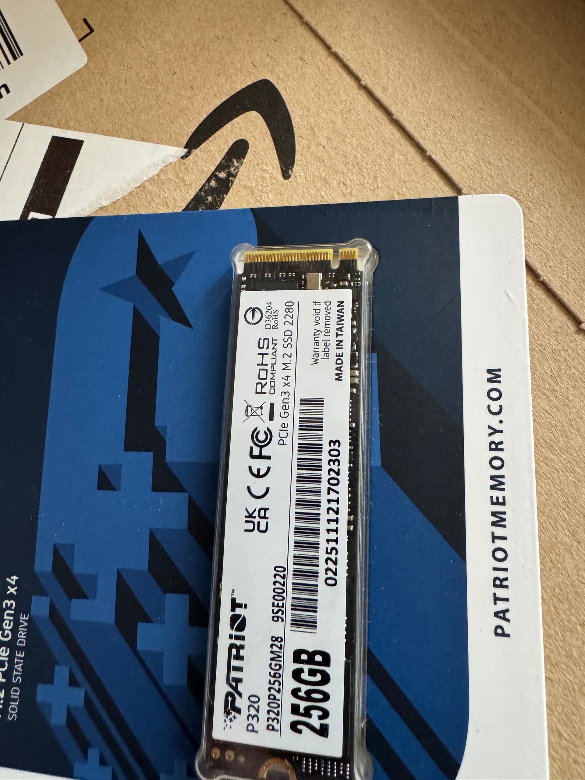

I got one that was recommended on the Roon instructions but it is twice as long as the existing one. I have now ordered another that is the same form factor. It is a 256GB as 64 was sold out (and largely no longer available).
That is like the one I ordered but it is twice as ;ong as the old one. How did you get it to fit?
There’s no fit issue for me. Also note the screw in the picture just to the right of the pink cooling paste that holds down the SSD.
Exactly - just unscrew the first fixing post for the small SSD form factor and use the second fixing post for the longer SSD form factor…

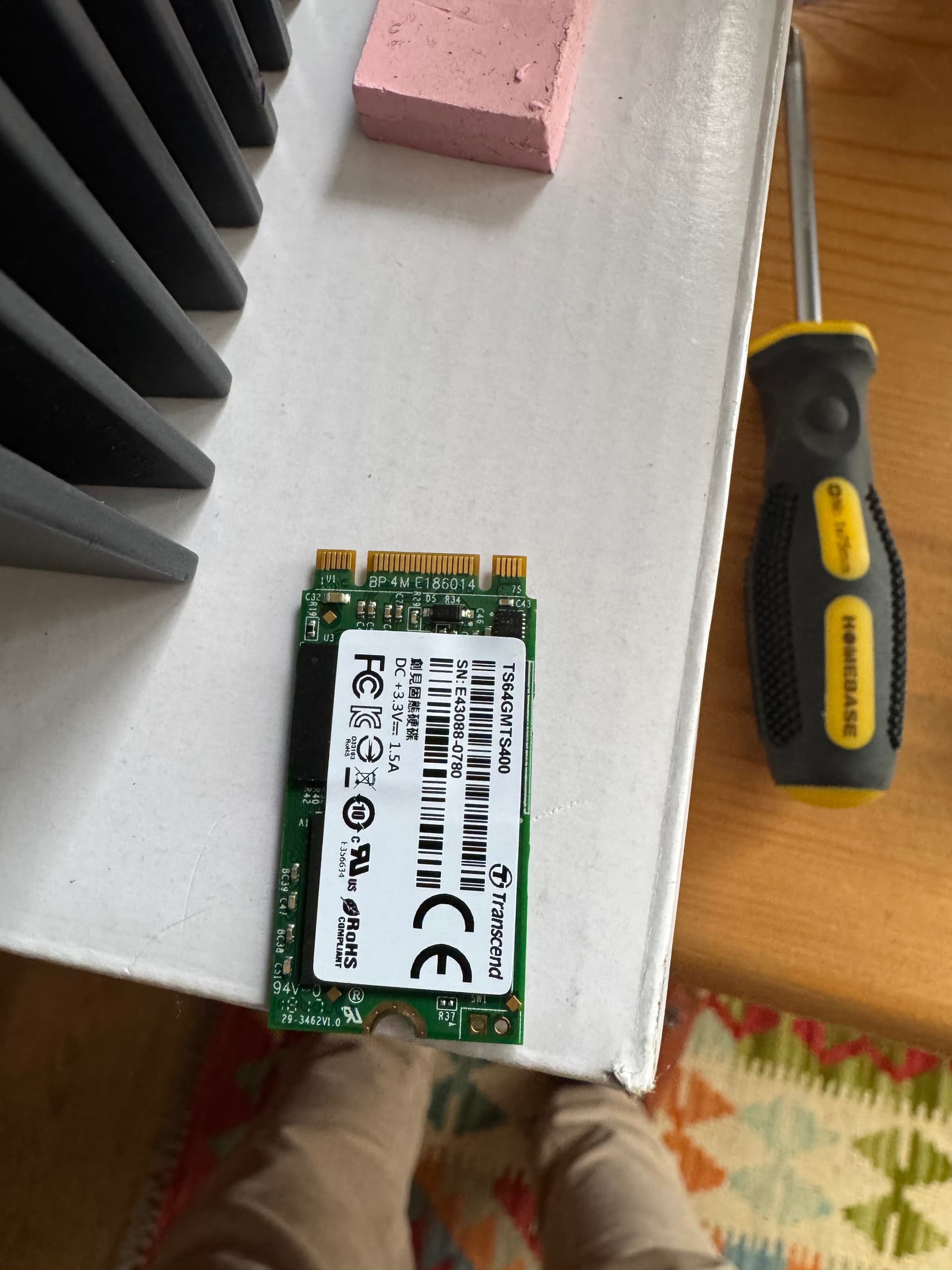

The pins are in different positions and I don’T want to open the box unless I know it will fit. There are three sets of pins on mine and only two on the new NVMe version.
Your first picture is M.2 2242. Your second picture is M.2 2280. Both pin layouts fit on my nucleus+ rev a. The intel specs of the NUC7i7BNB confirm this.
The general rule with M.2 cards is that, if it will fit in the socket (it has slots than line up with the keys on the sockets), it will work even if it has more slots than is necessary.
In the socket there are potentially two keys (blanked off parts of the connector) referred to as ‘B’ and ‘M’ respectively. The ‘B’ key (the one on the right) is always blanked off and is used to prevent the insertion of devices the wrong way around (upside down). The other key, the ‘M’ key, is used to prevent insertion of NVME devices and is blanked off when the socket cannot accommodate an NVME device.
The socket on the Nucleus does not have the ‘M’ key blanked off so it can accept both NVME and SATA SSD’s.
The Transcend TS64GMTS400S card that you are replacing is a SATA SSD so it has slots corresponding to both the ‘B’ and the ‘M’ keys allowing it to fit into sockets with or without the ‘M’ key. Amazon UK still have a 128GByte version of the Transcend card available.
The M.2 SSD that you have bought to replace it is an NVME SSD so it only has one of the slots so that it will not fit into sockets that are designed to accomodate only SATA SSDs but it will fit sockets (like the one in the Nucleus) that are designed to accomodate both NVME and SATA SSDs.
In theory, an NVME SSD is faster than a SATA SSD (higher transfer rates and lower IO latencies). However, in the context of a Roon Server it is unlikely that much difference will be observed because, after boot, very little disk access is performed. However, the current ROCK guide (effectively a ‘build it yourself Nucleus’) gives links to NVME SSD’s for use as the system disk. It certainly can’t do any harm to fit an NVME SSD rather than a SATA SSD although it may cost a little more.
In short, as others have said before, the new SSD that you have purchased will fit in your Nucleus.
Looking at the picture posted by @Nepherte in his earlier post, it looks as if the anchor post for the longer SSD is already present. If it is not present, then you can unscrew the post from the 42mm position (as used by the old SSD and screw it into the 80mm position ready to accommodate the new SSD.
