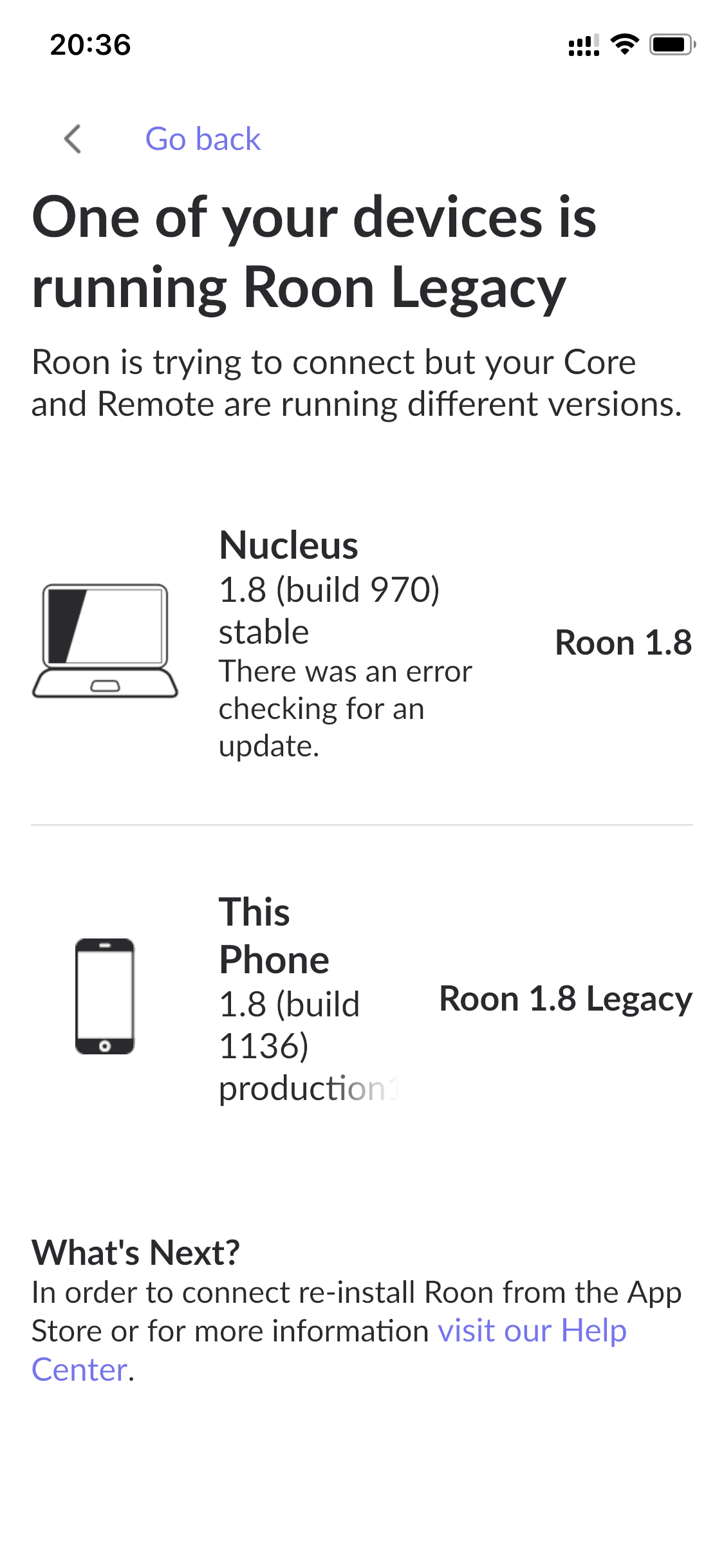

Did not work, reinstalled on web interface and even restarted.
Roon 1.8 legacy remote gives attached error and remote 2.0 says incompatible
What’s next?
