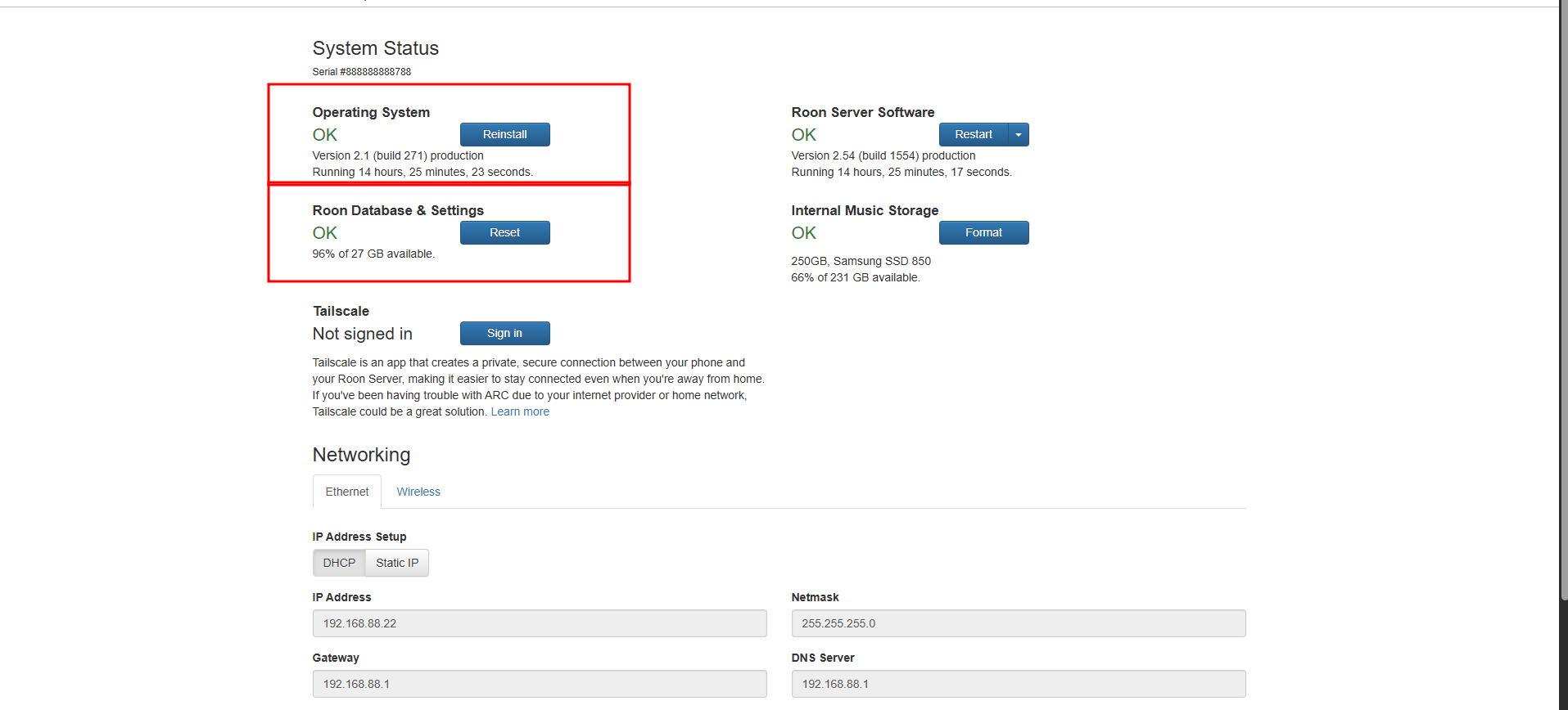

You can reset the Roon Database via the Nucleus’ WebUI see below…
Once reset you will have to login in again and then setup Roon from scratch, it will then re-import and index your existing music files.
Thanks for the clarification. I have stopped the Roon Server Software, changed the server file name, and then restarted the server many times. I thought that process was “rebuilding the database”. I see that there is the option on the web interface right next to it that specifically says “Reset” Roon Database & Settings. What I am understanding you to be saying is that I need to use that Reset Button. Do I need to do any of the steps I did before with the Roon Server like changing file names or stopping it?

Yes, you got it correctly, you have to reinstall Roon Software without restoring any backups, no need to delete your music .
In order to do that you have to press “Reset” button under “Roon Database & settings”. After that please set up the Roon installation from scratch.
