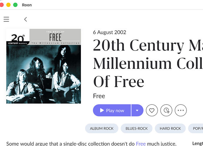

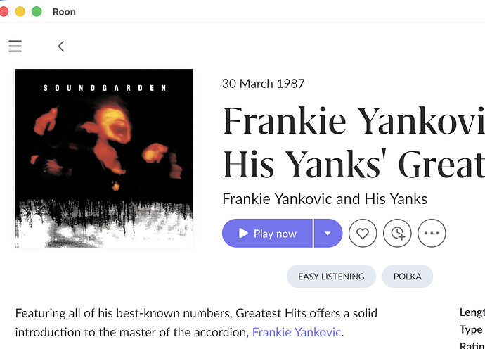

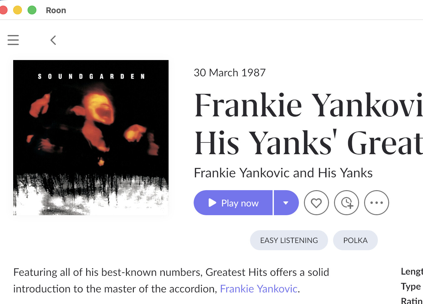

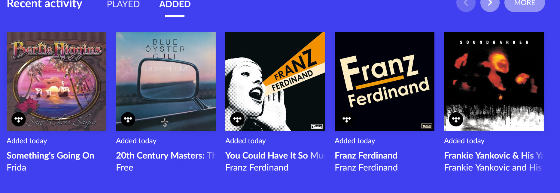

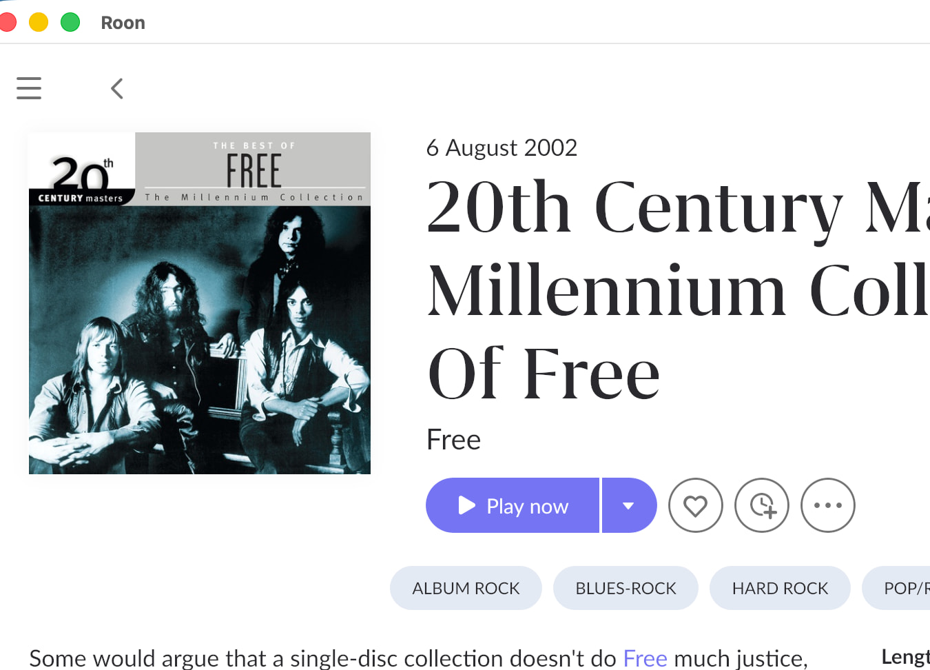

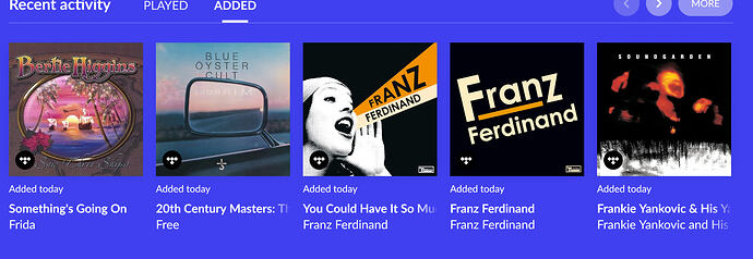

It is showing the wrong album artwork under the Recently Added section. Attached is an example. Soundgarden album art where Frankie Yankovic’s picture should be :accordion:. It seems inconsistent because the Free album also has the wrong artwork but when you click on the album it is correct. The Frankie Yankovic song still shows Soundgarden when you click on it. I had added it right before it crashed, so I thought perhaps something was unstable and that was the cause of the problem. So I just removed it from the library and added it again and it is still using the Soundgarden artwork.
After my restore it seemed to work pretty well over the past few days but this morning it has crashed several times since 10:30 Central time.
