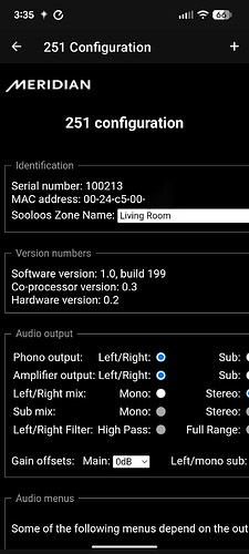

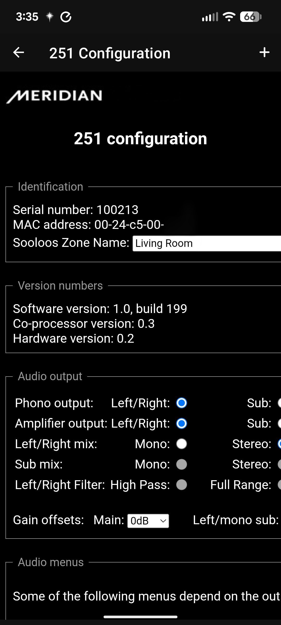

Here is the information about the endpoint.

Thanks for the follow-up! I’m glad to hear the crashing has subsided. For your meridian issues, we’re seeing the Meridian 251 is sending unsolicited packets. This is normal for Meridian’s discovery process, but seeing it frequently in the logs often indicates that the device is re-announcing itself to the network because it thinks the previous session was dropped.
Since the music stops and requires a manual restart, the Nucleus has definitely “forgotten” the playback state due to a total drop in communication. Try these steps in order:
  1. Assign Static IPs / DHCP Reservations: Network audio endpoints (like the 251 and the 218) hate it when their IP addresses shift, or when a router "probes" them.
  • Log into your router and set a DHCP Reservation for the Nucleus and the Meridian 251.
  • This ensures that even after a reboot, they always live at the same "address," preventing the "grayed out" play button (which usually means Roon knows the device exists but can't find its current IP).
  1. Check for "IGMP Snooping”: If you are using managed network switches (like Cisco, Ubiquiti, or Netgear ProSafe), ensure IGMP Snooping is turned OFF.
  • Meridian and Roon both rely on multicast traffic. IGMP Snooping often tries to be "smart" by blocking this traffic to certain ports, which causes endpoints to disappear every few minutes as the switch "prunes" the connection.
  1. Simplify the Signal Path (The "Bypass" Test): To rule out a failing ethernet cable or a bad switch port:
  • Plug the Meridian 251 and the Nucleus directly into your main router using fresh Cat6 cables.
  1. Update DNS Settings: Because your logs show 11-second delays for web requests, your Nucleus is likely timing out on its internal tasks.
  • In your router settings, change your DNS providers to Google DNS (8.8.8.8) or Cloudflare (1.1.1.1). This often clears up the "lag" the server experiences when trying to verify licenses or fetch metadata.
Let me know if any of the above help, thank you Dave! :folded_hands:
