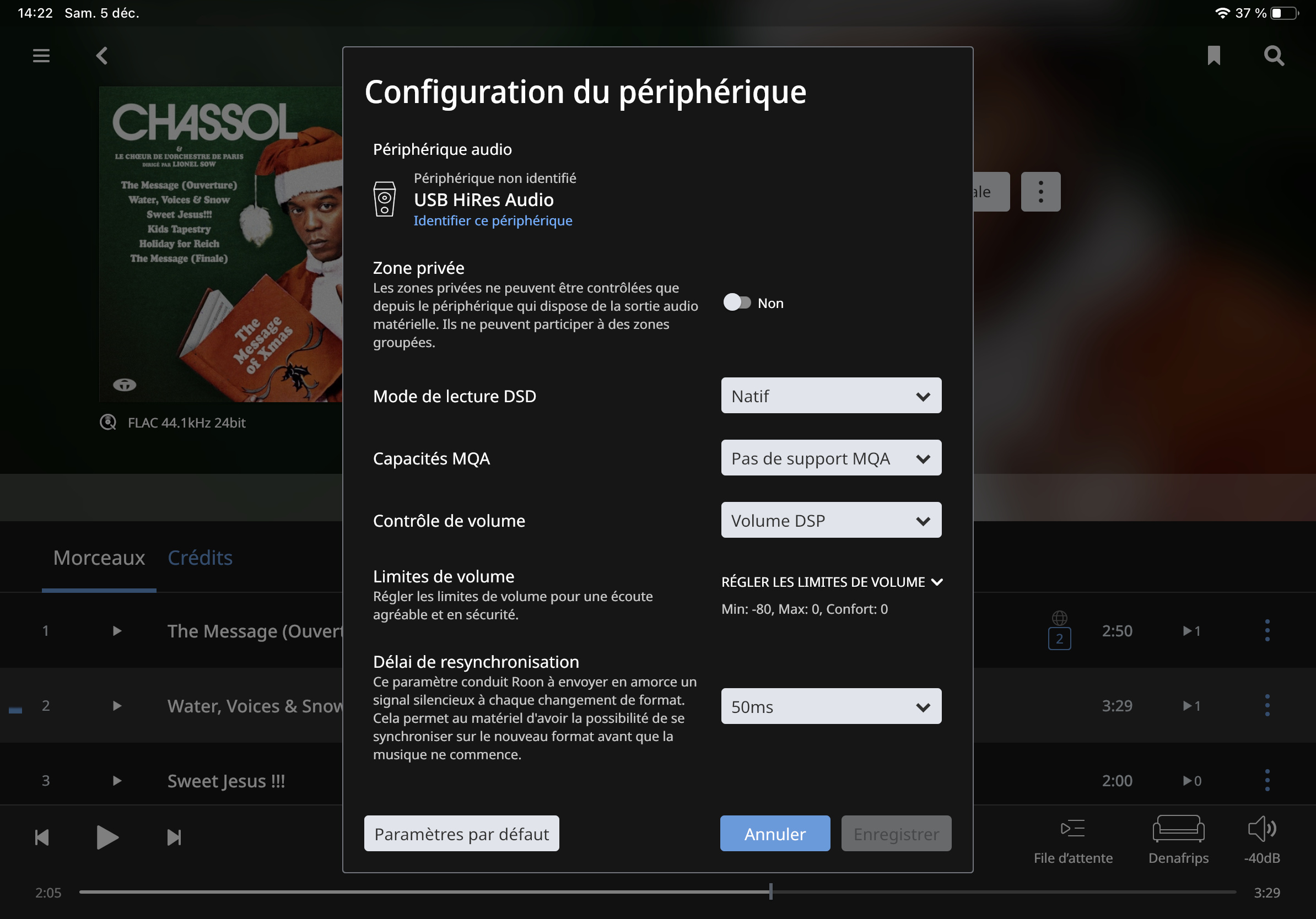

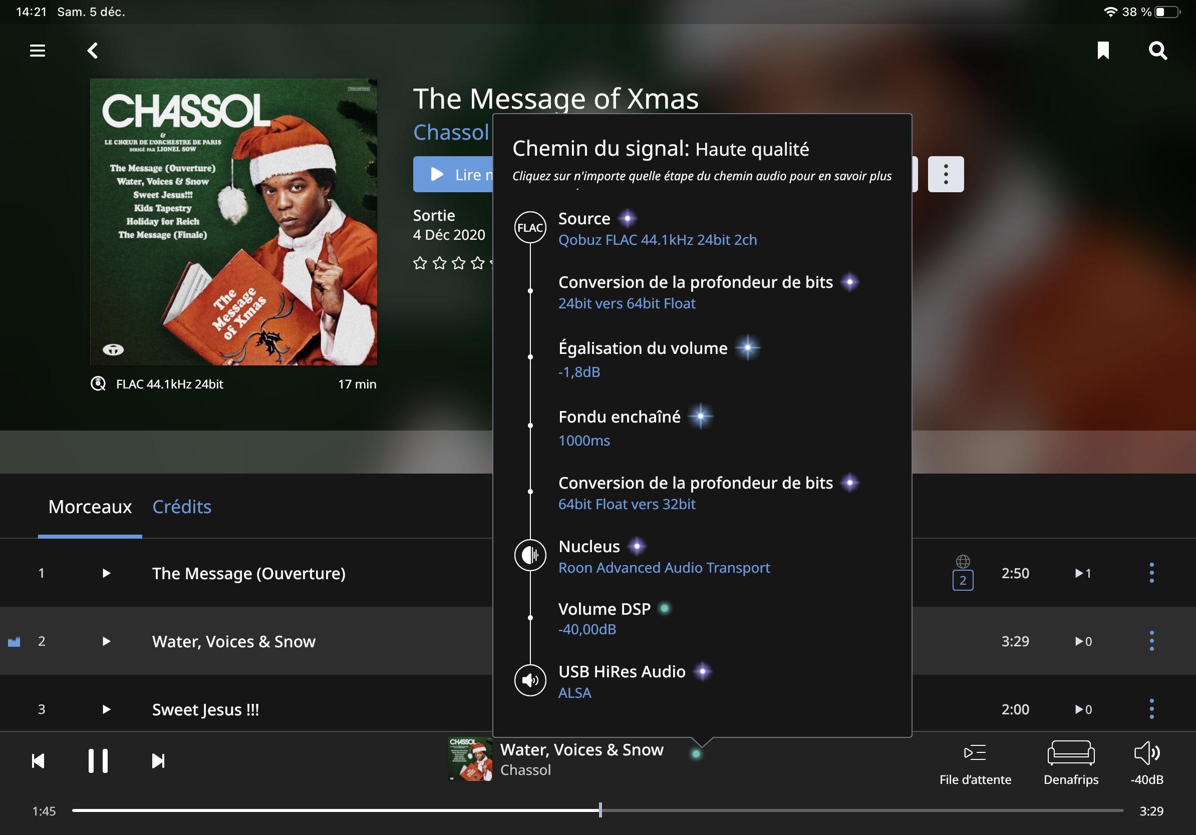

Hi @Olivier_Lechien ,
Can you share a screenshot of Device Setup as well as a screenshot of the signal path when playing to this device?

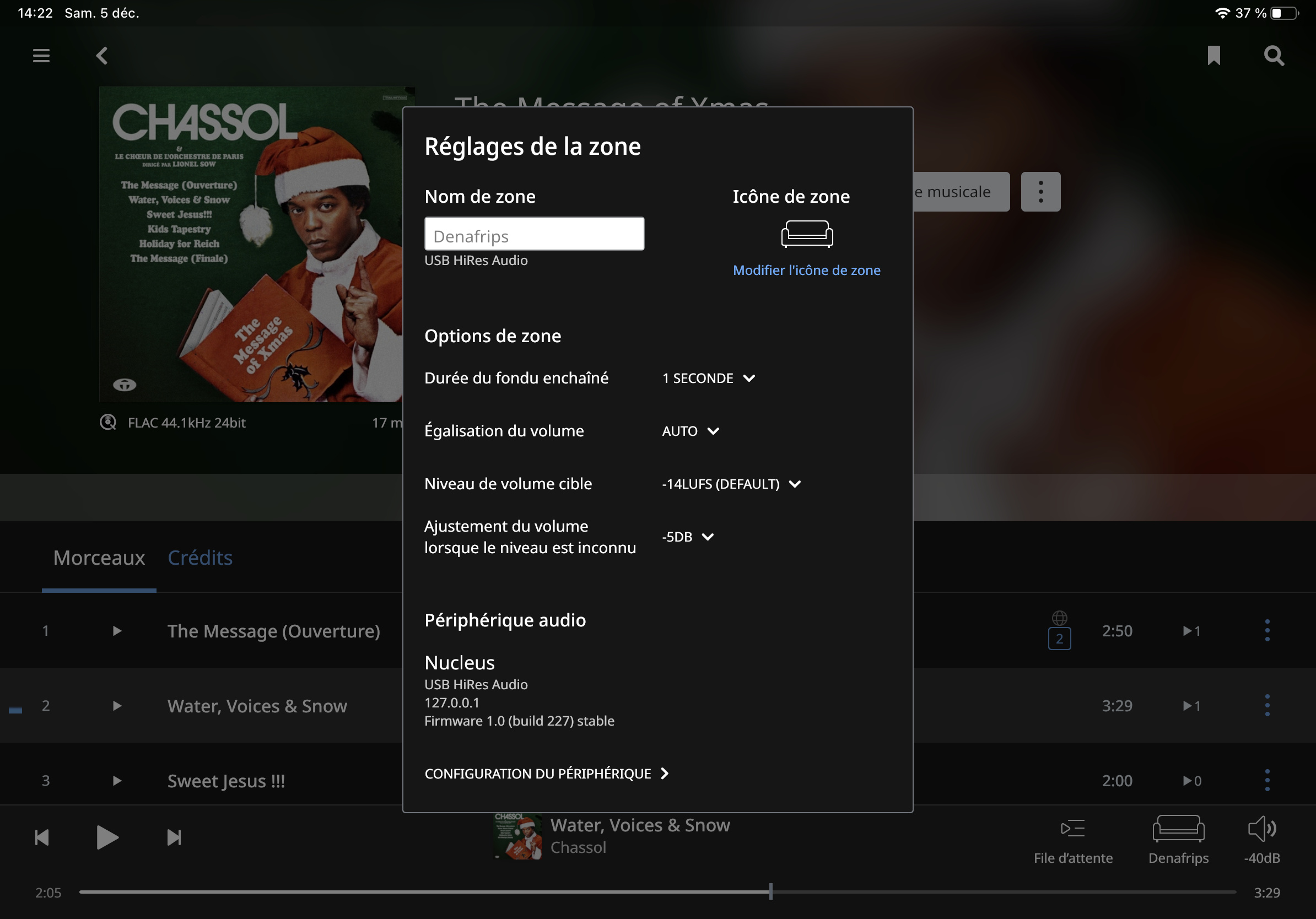

Dear Dylan,
Here are the screenshots.
Kind regards,
Olivier
