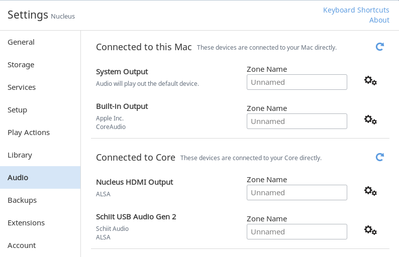

Nucleus direct to Schiit Bifrost via USB - no output
Roon recognizes the Bifrost (so I know it is connected), but there is still no output from the Bifrost to my amp no matter what I try. Roon shows “Nucleus HDMI output” with nothing connected to the HDMI jack, instead of “Nucleus USB output”, which obviously is connected… is that normal?

Could you post a screenshot of your Settings > Audio tab?

Sure, here it is:
Am I doing something dumb?
PS.: the Nucleus HDMI Output allows me to hit “Play” and then it appears music is indeed playing. The Shiit, although enabled, will not allow me to hit Play.
Let’s clean this up a bit, just so we’re playing to the zone that we’re intending.
Click on the gears next to System Output, Built-In Output and HDMI and select Disable.
Give USB a name, such as Schiit. Make sure Schiit is selected as the Zone and play some music. Does the timer progress?
Could you post a screenshot of Device Setting for the USB?
Cheers, Greg
Thank you Greg, it appears to be working now. I think there was some operator error at play here. :grinning:
