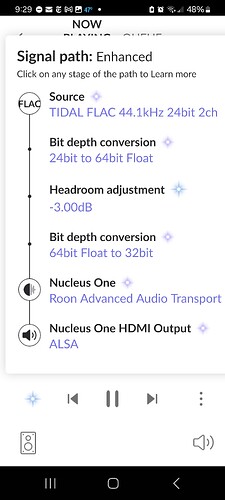

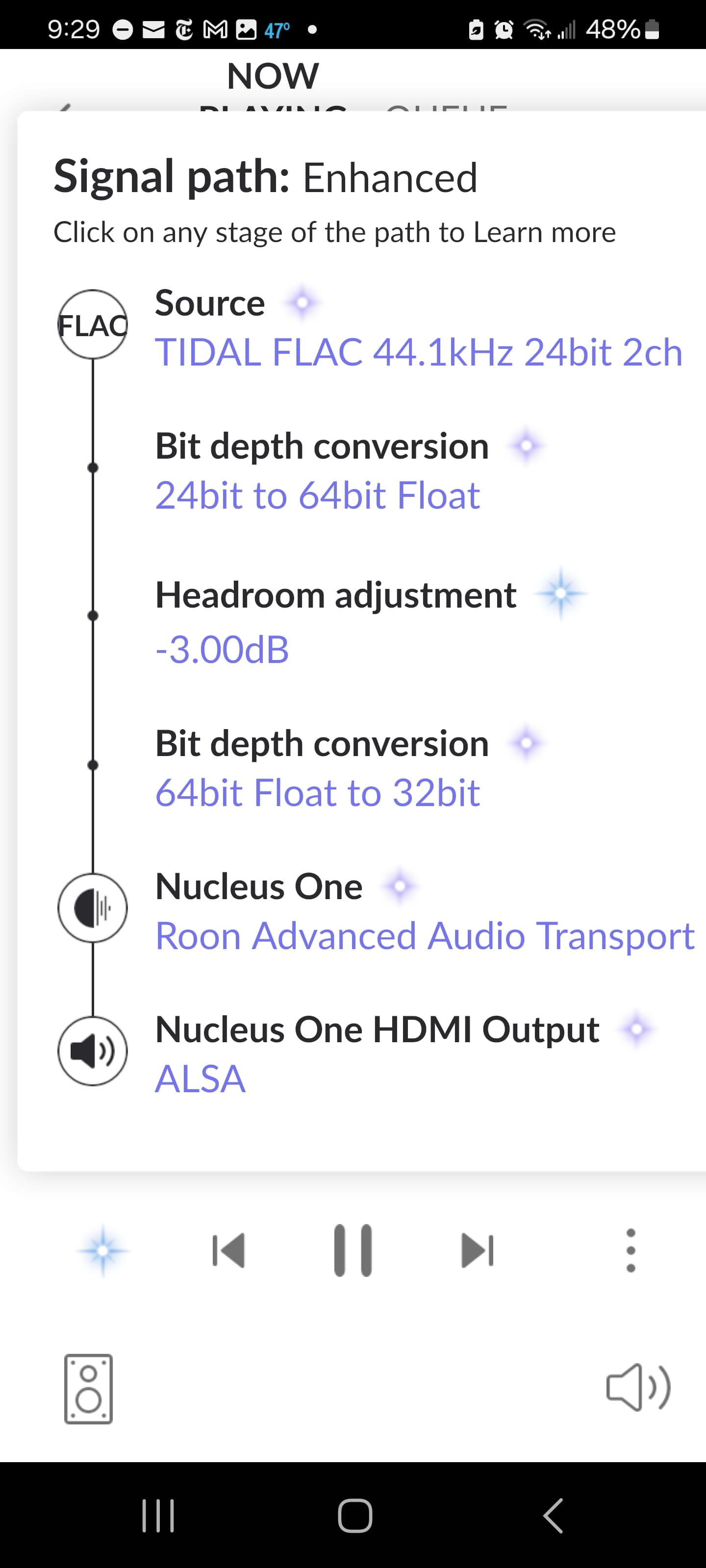

Thank you for your post. RoonServer diagnostics show Roon upsampling everything to 32-bits for this HDMI input. Can you please share a screenshot of the Signal Path in the configuration that is currently failing to play audio?
Are you using the Hi-Bit32 feature mentioned in this device product manual? If so, our understanding is that the unit would upsample internally, and expect 16-24-bits on the input from the source.

Here is the signal path. Also The audio scaler function on the SC77 is currently set to Auto. This means the Hi-bit 32 is set to ON. The digital filter is set to SHARP and upsampling is set to X4. When I switch it to manual, (Hi-bit 32 set off, digital filter off and upsampling set to X1) Still no sound.

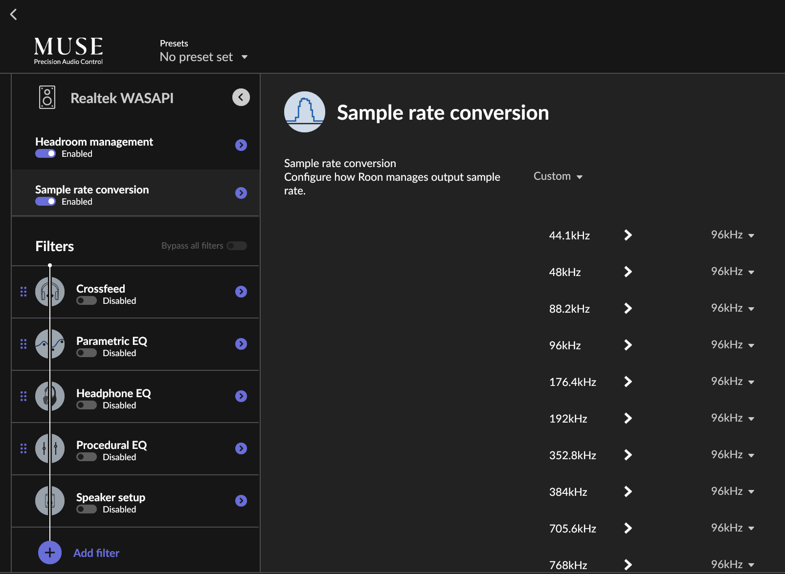

Thanks for the update here, that is a very interesting observation. Please go ahead with the Operating System reinstall. Additionally, I wonder if going to Roon MUSE (DSP Engine) and setting a force resample of all content to 48/96/192 temporarily bypasses this issue.
Forcing resample of all content does the trick. I’m able to get HDMI playback on everything. Will doing the OS reinstall possibly eliminate the need to resample?

To ensure smooth playback with other sample rates, we recommend enabling sample rate conversion in MUSE for this specific zone. You can set it to convert unsupported sample rates to either 48kHz or 96kHz, depending on what works best with your setup.
