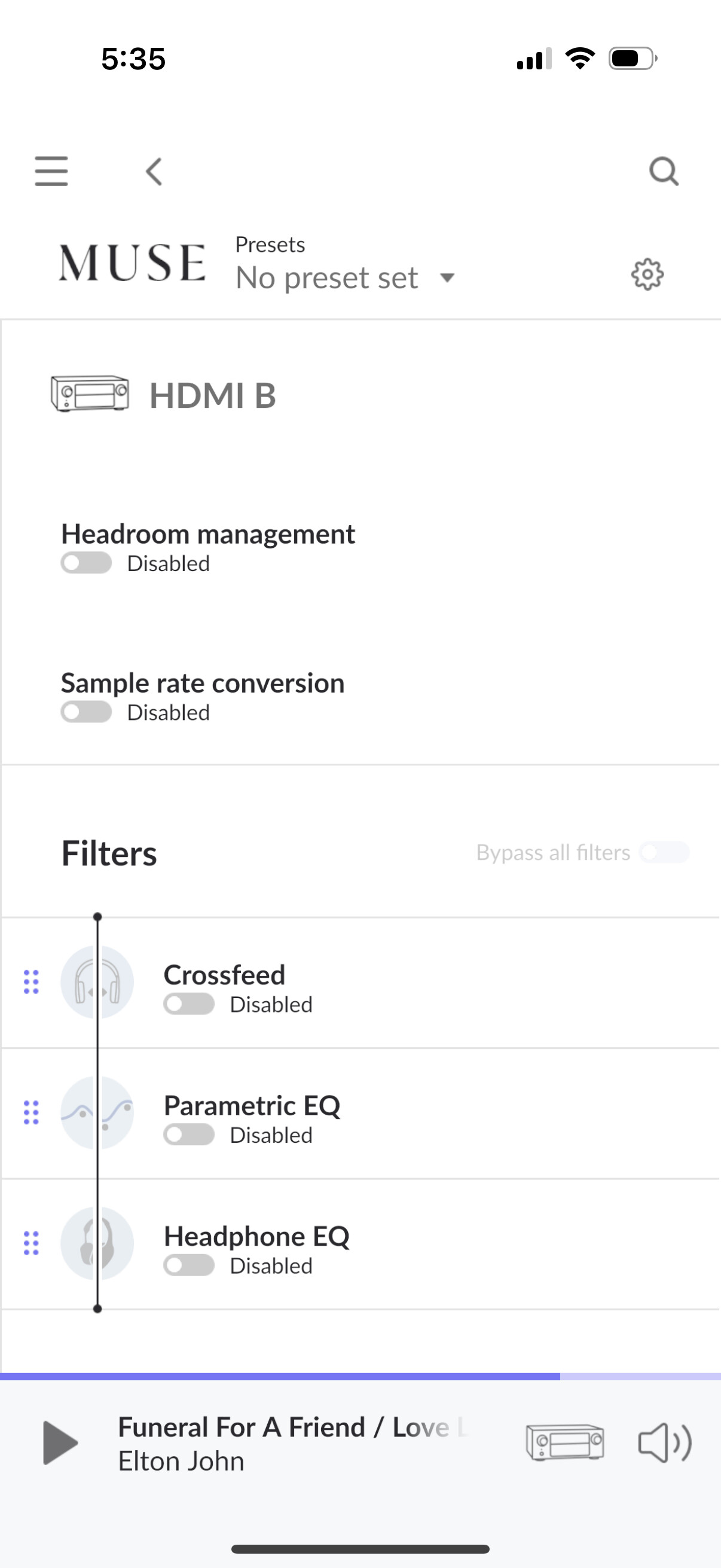

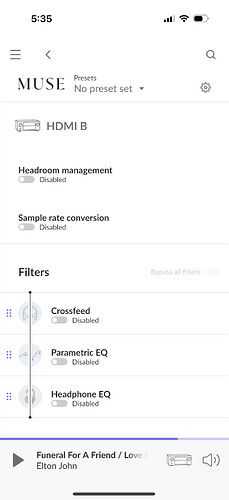

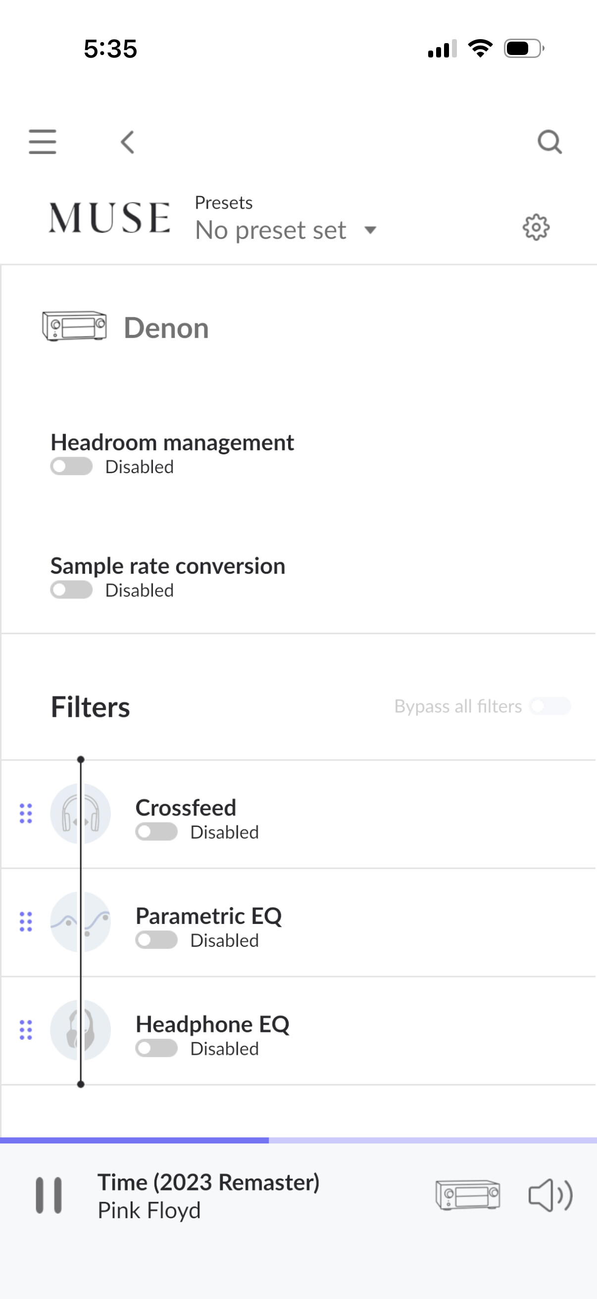

The above post mentions a great point. Reviewing this thread, I don’t see confirmation that you haven’t set up a MUSE profile for the affected HDMI Zone as @Nils-Elling_Stubberu just mentioned. This will certainly create the downsampling condition - I’d double-check that first.
No MUSE profile and this would not explain the aforementioned intermittent nature of my issue and the ability to reproduce the problem now by hard resetting the Nucleus. If a profile was active it would always be active unless I changed during each test, which I am not.
The DSP you are seeing is inherent of the issue itself. When downsampling occurs DSP is shown and when downsampling is not occurring DSP is not shown. I have attached to show the settings for both sources HDMI A (aka Denon) and HDMI B just to settle this here.
I do appreciate your comment though as I am looking for any thoughts on why this is occurring. I believe I have narrowed down to Hardware/Software with all my testing but am always open to someone else’s take on this issue. Also I had believed it was a setting on my part for a long time but the exhaustive testing and posted results have disproved this over and over.

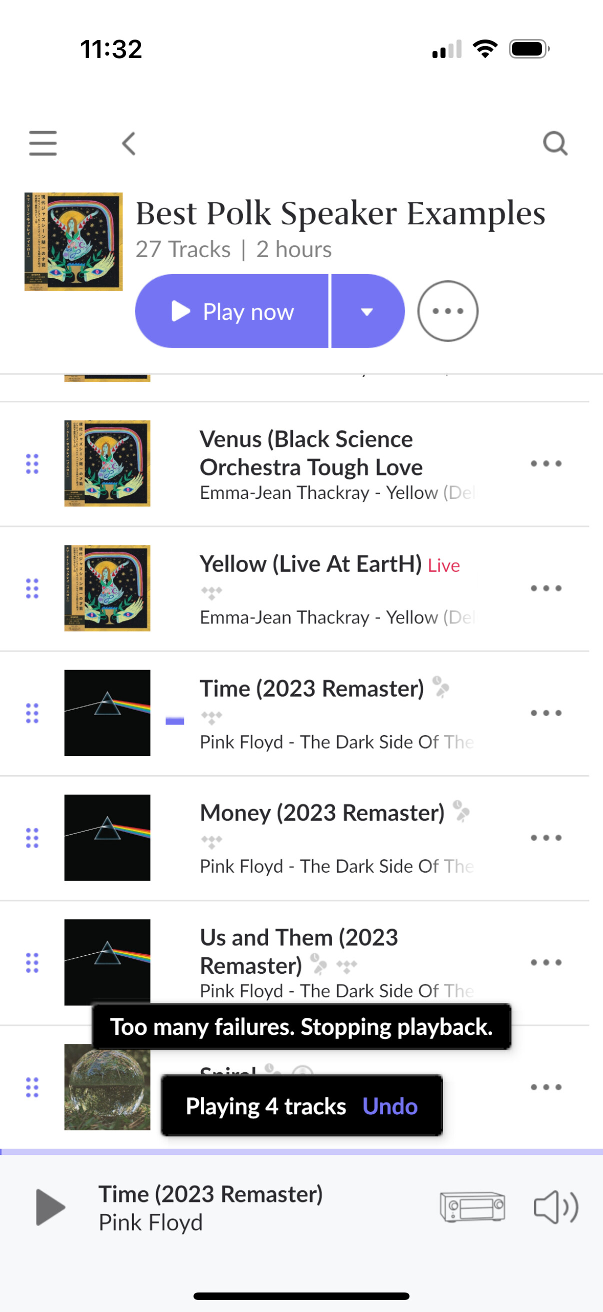

At this point I am realizing this is such a random situation we are dealing with. Right now I am getting Too Many Failures again when I try to play any track using HDMI A (connected). Timestamp would be 3/28 between 11:28 and 11:37AM. I’ve mentioned this before. This will resolve eventually but I don’t know how it resolves but it always happens when I unplug then reconnect HDMI A and even waiting about 10 min then it will start downsampling. Does this help at all?
I don’t know what else I can do to test.

I did resolve the minor issue of the music not playing with the error “Too many failures. Playback has stopped”. I just needed to add a delay of 1500ms and now all music even the downsampled music plays with no trouble other than the downsampling. This is good.

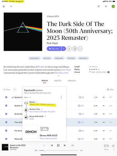

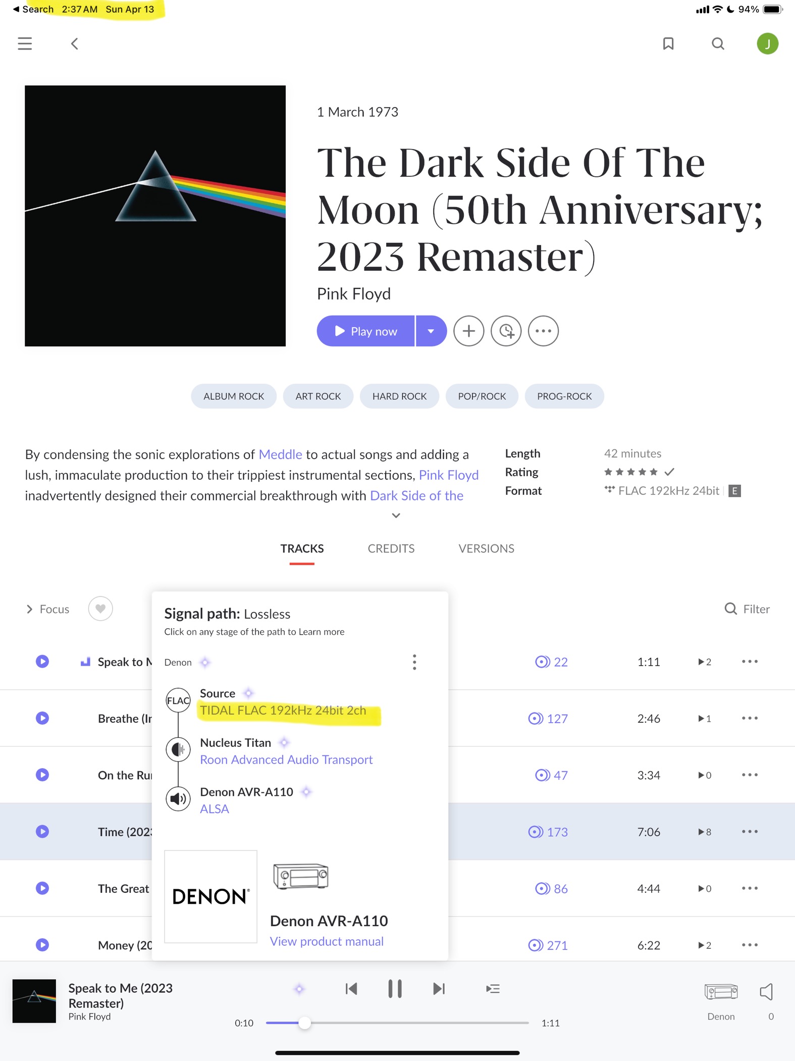

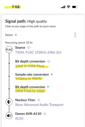

Can you download the logs from about 2:30AM-2:45AM EDT Sunday 4/13. I was testing a few different settings in Roon and out of nowhere Roon started showing the proper sampling. I was primarily enabling different Audio Sources that still connect to Denon (ie HEOS and Airplay2) then I switched back to HDMI (renamed to Denon in Roon).

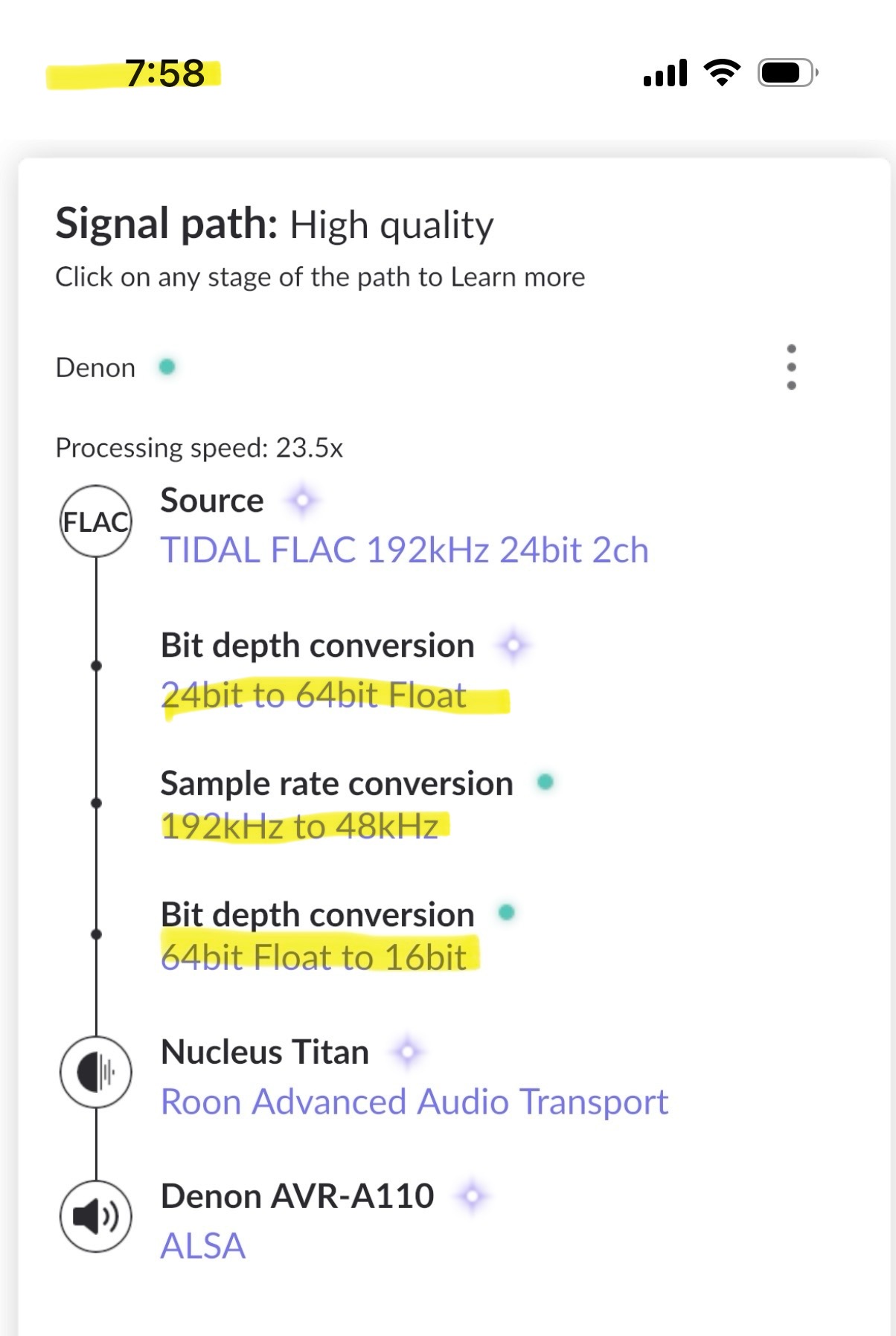

When I tested again between 7:45-8:15AM or about 5 hours later Roon started to downsample the same source again.

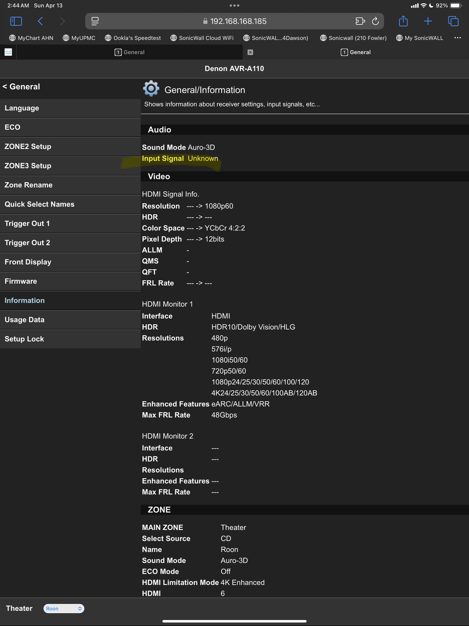

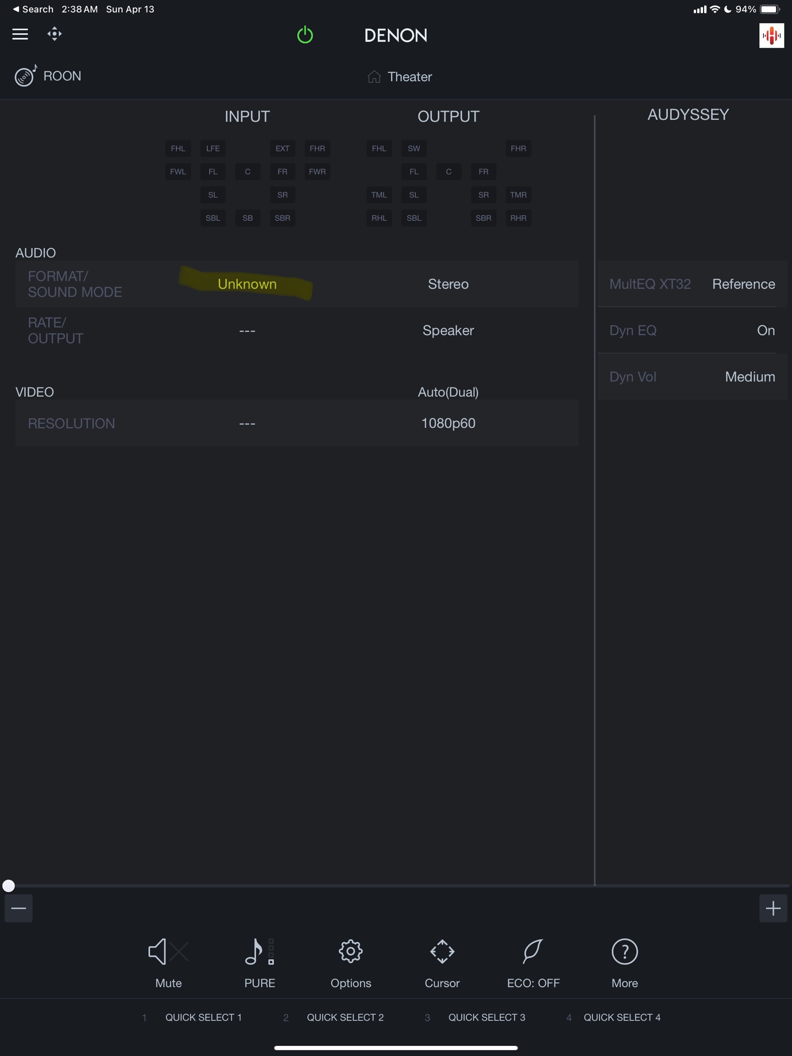

What is interesting is that Denon reports the Audio as being Unknown when it should be showing me the sample rate (format). And in Roon I was able to see the entire Device Setup settings (MQA, Max Sampling Rate, etc).
It is like Roon loses the settings as shown in Device Setup so it doesn’t know how high the sampling rate can be.

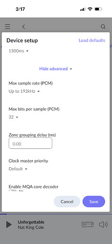

This happened before and I reported many weeks ago but this time I was able to capture screenshots to show you. All the photos are during the time that Roon started working again except for the last one which was taken when the issue resurfaced.
I can now reliably fix this problem but the fix is only temporary. If you are interested, I can get Roon to match the sampling rate of the Denon-A110 receiver by switching to another Audio Source then switching back to HDMI A (renamed Denon on Roon). I just keep doing this until the problem corrects itself.
The log on my Nucleus Titan should show the details of what is happening if you retrieve the log for Sunday, 4/13, 12:30-1:15PM.
The problem resurfaces ~several hours later without playing any music on Roon. I will keep testing to see if the resolution timeframe is consistent. I consider this a major step forward in troubleshooting this problem.

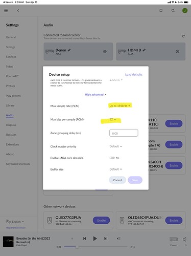

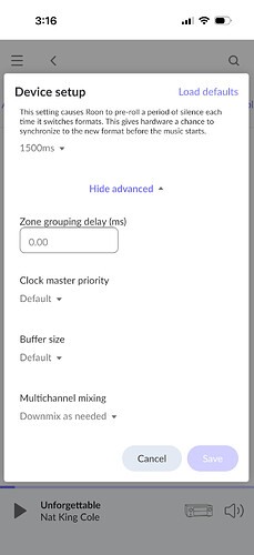

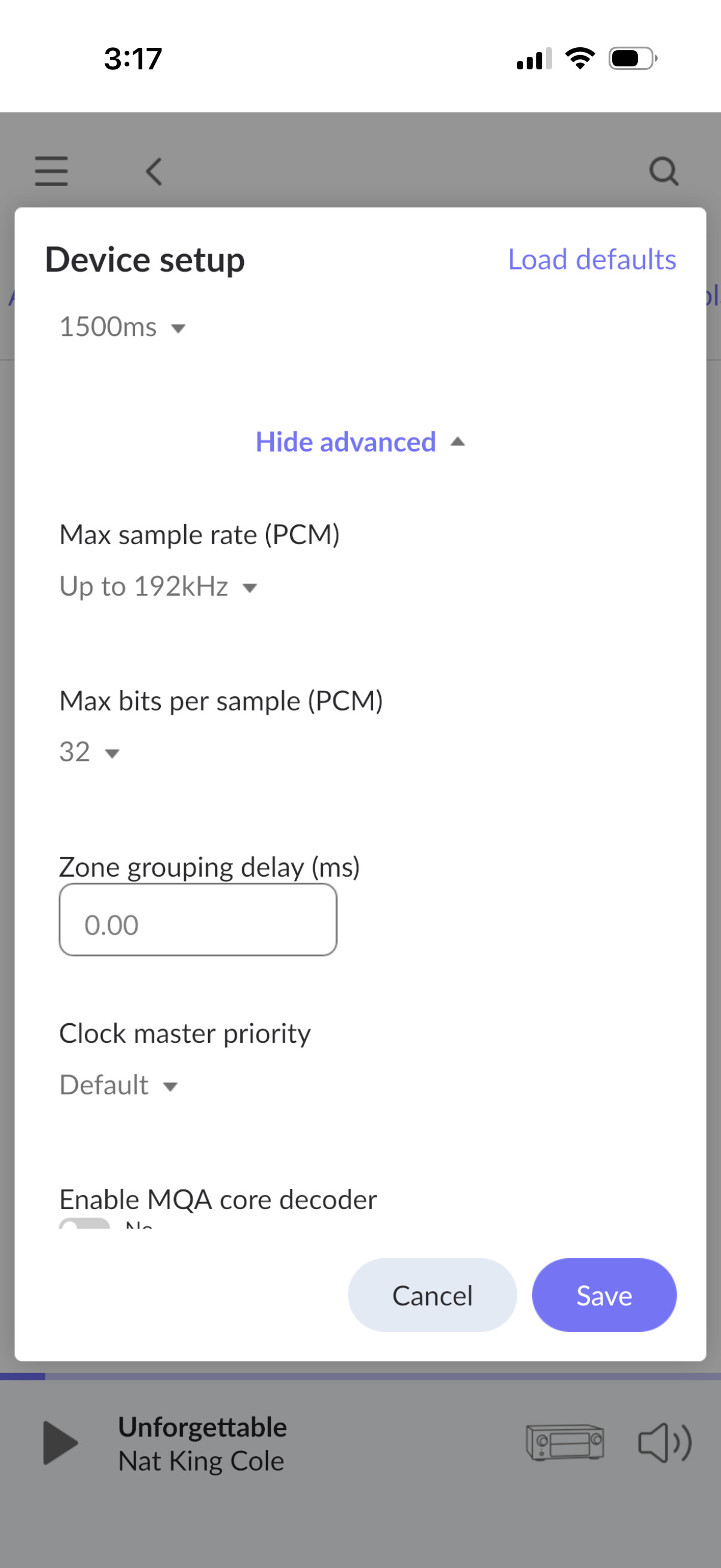

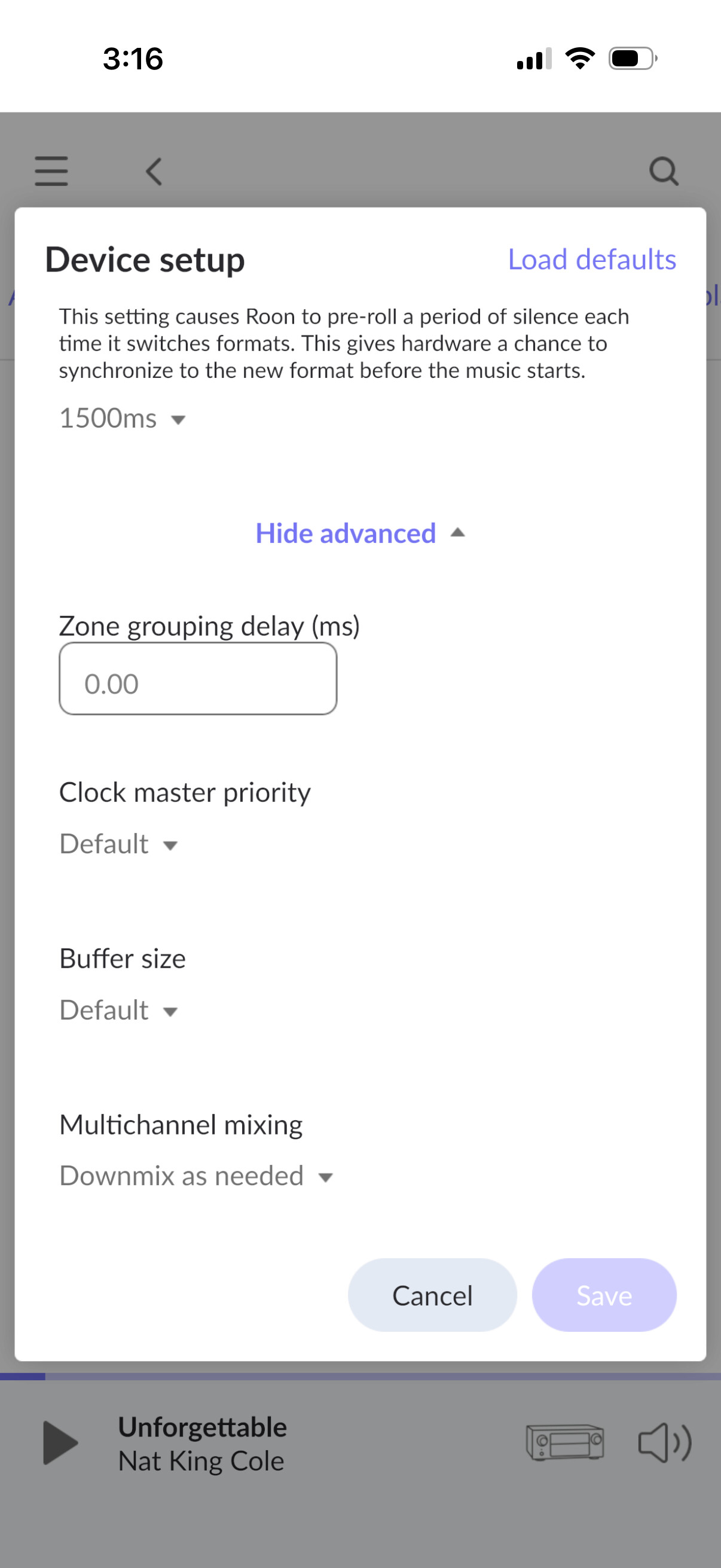

I read through this entire chain and realize I never sent a screenshot of what Device Setup looks like when the settings for sampling and MQA disappear.
Here you go:
First photo show Device Setup when I am able to do the temporary fix. The second photo is when downsampling is occurring and some of the settings disappear.

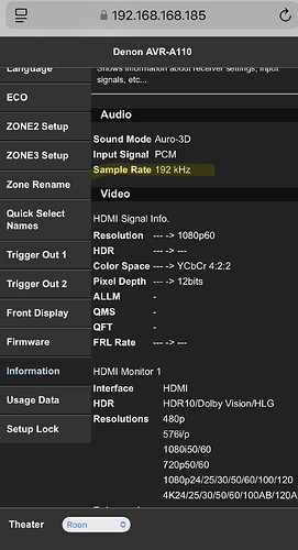

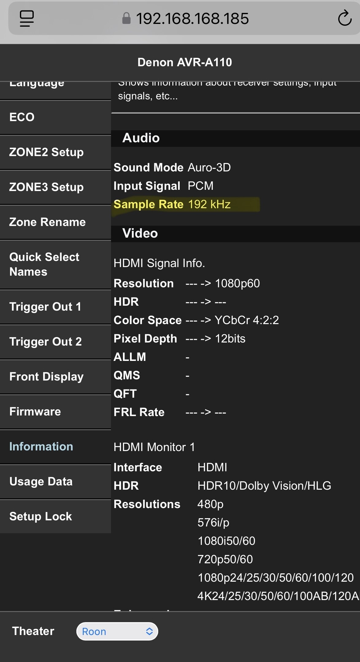

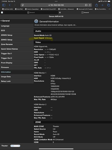

One more definitive test. I was able to borrow a Cambridge CXN100 and tested how my Denon-A110 receiver handles the input signal (Sample Rate). With this setup using the same cabling the Denon does display the proper Sample Rate that the Cambridge was outputting (192kHz in this test). I attached the Denon Information page for review.
Also I found a Denon article discussing “Unknown” Input Signals. I confirmed that HDMI-CEC was turned off on the Denon. I also verified again that that the Denon firmware was up to date and I had already performed a factory reset of the receiver.
The article suggests that if these troubleshooting steps are verified an Input Signal of “Unknown” is likely a HDMI handshake issue between the source device and the receiver. We discussed this possibility already.
Hope this helps.
