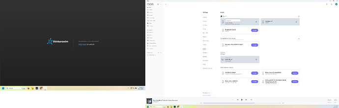

Would you kindly provide us with the screenshot from the Roon → Settings → General and Settings → Audio?
Once confirmed, we can proceed with the next steps.
Hello @dlynam,
Thank you for the screenshot. It confirms that Roon isn’t currently seeing the Anthem device on the network.
Since both the Nucleus and the Anthem are meant to communicate over your local network, the next step is to verify that the Anthem is actually visible at the network level.
Could you please share a screenshot of your router’s device list (LAN / DHCP client list) showing all connected devices?
This will let us confirm whether the Anthem is receiving an IP address and is on the same subnet as the Nucleus.
