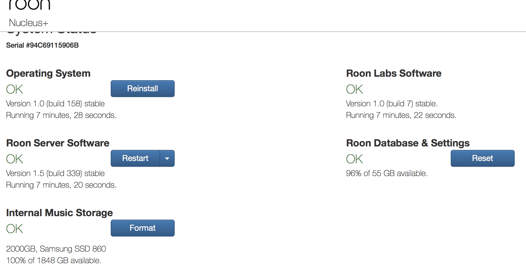

I have now invested in a Nucleus+ with a 2TB SSD. However, there was a delay in getting the SSD. So following the online documentation I have moved the Roon Core to the Nucleus+ and my music files to an external USD drive attached to the Nucleus+.
The SSD has now been installed and I have made backups to various places. I have copied the music files, in exactly the same folder structure, to the internal SSD.
However, when I restore the backup and then try to edit the storage path from the external USB drive to the internal SSD I am unable to see the “Nucleus+ Internal Storage” folder to select it. See the screen shot.
The only way I have been able to get the files onto the internal SSD is by adding a network path to the “Nucleus+ Internal Storage” folder. Once this is done, and if you look at the storage screen the “Nucleus+ Internal Storage” folder then shows as disabled.
So, with apologies for the long post, my question is, is this the expected behaviour? Does it have any implications in terms of performance or possible problems if the SSD has to be changed in the future?

There is something odd about your setup. I don’t think that you should be seeing that “Disabled” message for your internal storage. And if I look at the screenshot of the Roon web page in message #8 of this thread, it states that your SSD has 100% available - i.e. it’s not registering the fact that you have music files present. I believe that RoonOS should be recognising that there is some percentage of the SSD being used by files (it certainly does on my system).
The Nucleus+ Internal Storage does not appear as an option to select in the “Choose Music Storage Folder” screen - this is expected behaviour, AFAIK. I see the same on my ROCK + NUC system - only external USB drives or networked storage show up here.
As I say, something odd about your internal storage, I think. @dylan - what say you?
Geoff, I’m not sure if you have seen my message to Dylan this morning but he does seemed to have pointed me to a way to get my music files on the internal SSD without using a network path. As mentioned in that message I will now go through the whole process of transferring everything from my Mac Mini to the Nucleus+ from the beginning and see what transpires.
I think the screenshot of the Nucleus+ web page showing the SSD as having 100% available is a red herring. I, obviously, took it at one of the many times I had just formatted the SSD to try various things. It normally shows the correct figures so I don’t think there is any problem with this. Sorry to cause more confusion!

Hey @David_Miles,
These were the correct steps here (i.e. disabling the network drive, enabling the Internal Storage folder). Once you’ve done that Roon should match up the files on the internal storage to the 52,316 files that are associated with disable storage locations.
Also, just to clarify, it is expected that you cannot select the Internal Storage folder from the Choose Music Storage Folder window. I’ll make sure we make this more clear in our documentation.
