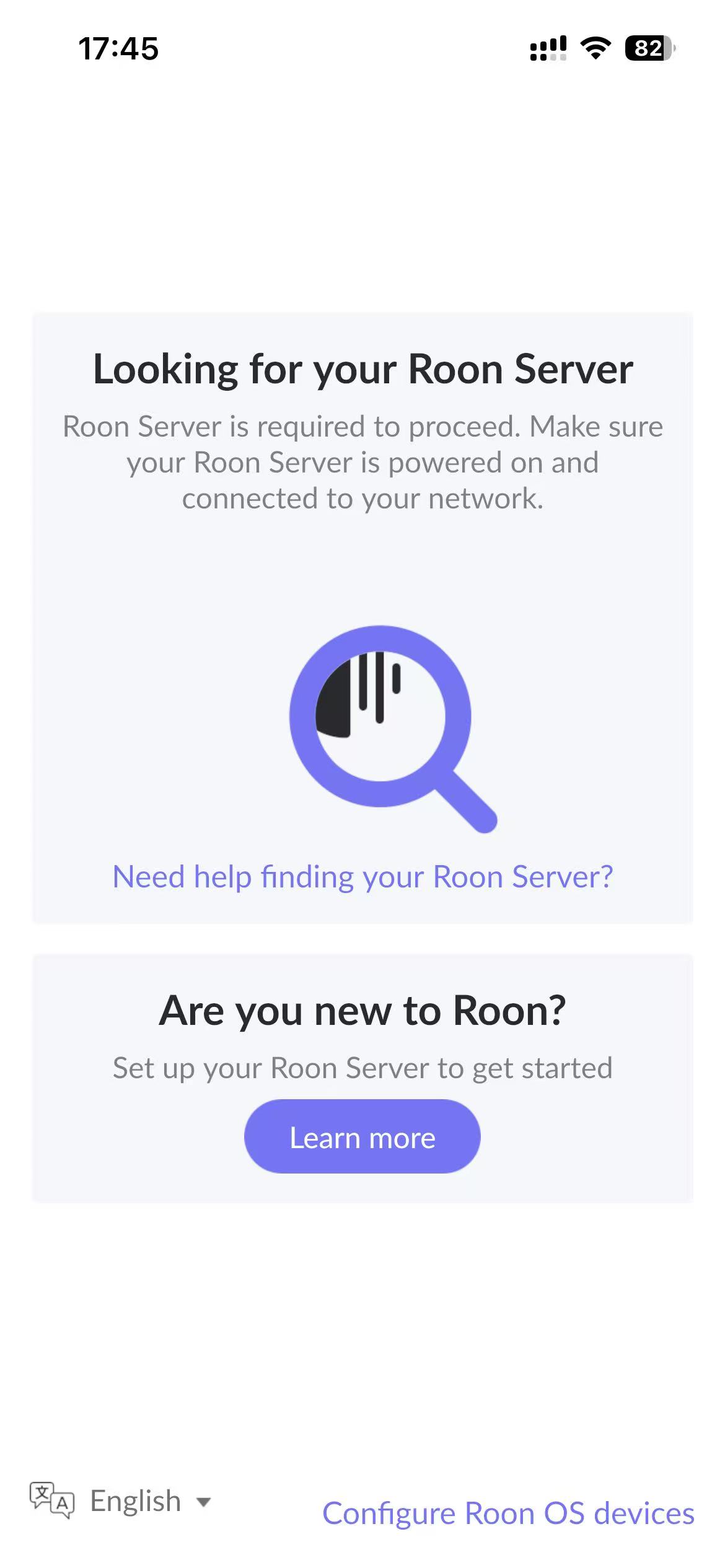

Is Roon Server running?
· Roon Server is on, but I'm still having trouble connecting.
· "Looking for your Roon Server"
· *Nucleus*
Issue Description:
On the rear Ethernet port, the green light is flashing , and the yellow (amber) light is constantly on . However, the Nucleus+ does not appear in my router's DHCP client list, and I cannot access it via any network method, such as the Web management interface or through the Roon Remote app. This prevents me from performing any software resets or configurations.

Model: Roon Nucleus+ Rev B , Firmware/Software Version: it's inaccessible. Network Setup: Connected via Ethernet to a Xiaomi Redmi Router AX6000 in a home network environment.
