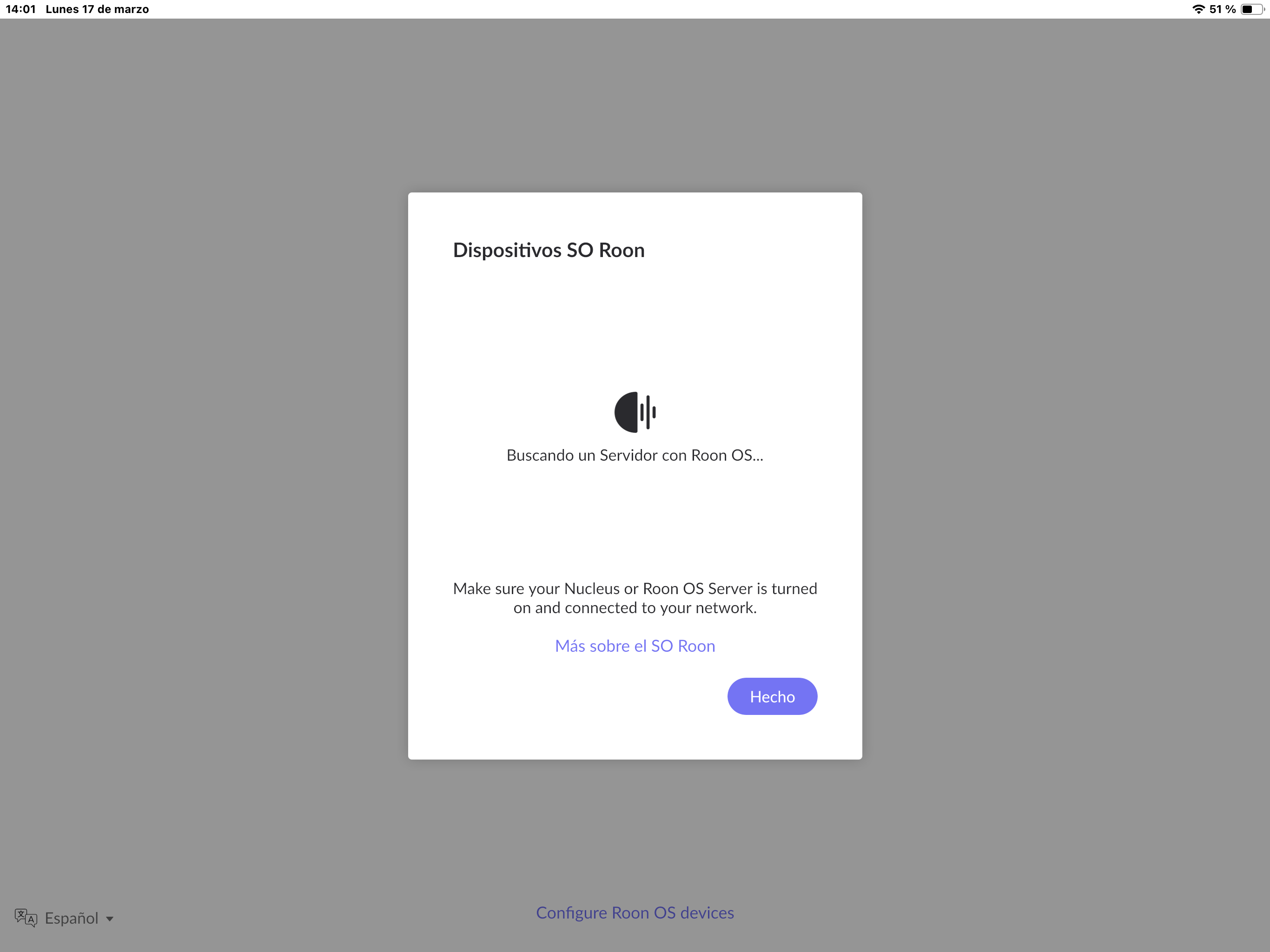

Is Roon Server running?
I turn on the Nucleus+, but it doesn't appear in the list of devices connected to my router, nor can I connect to it from the roon app on my iPad.
I've connected the Nucleus+ to one of the router's four LAN ports using an Ethernet cable. The make and model of my router is the Mitrastar GPT-2541GNAC Smart WiFi HGU Router.
