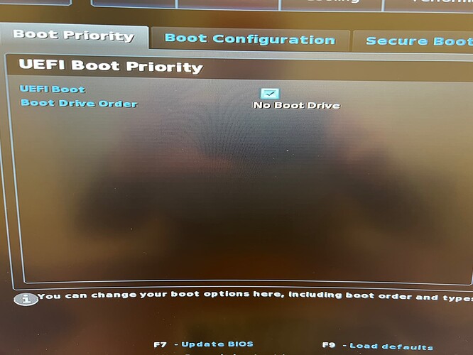

I’ve replaced original roon os drive with compatible m.2 ssd and have used roon os recovery flashed to cf card and installed on new drive using f10 keystroke launch. The new drive will not boot. I’ve tried to modify system bios to prioritize cf card boot, still not able to reboot. I’ve tried to reinstall original m.2 ssd and the nucleus will not boot and does not show up in bios. I’d like to be able to get the original roon nucleus bios settings for a fresh install. Any members have any experience with this? Has any one successfully installed a larger m.2 ssd for the boot volume?

Both times the boot drive was not found.
I did try to direct the boot volume to the usbcf in BIOS as well.
I gave up, and reinstalled the original ssd without a successful boot.

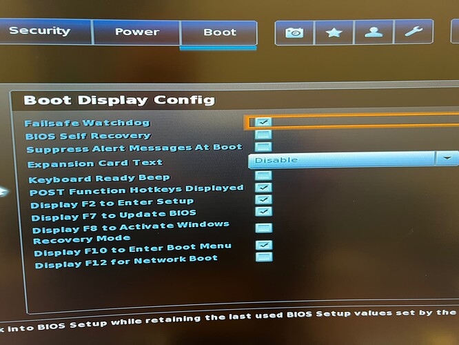

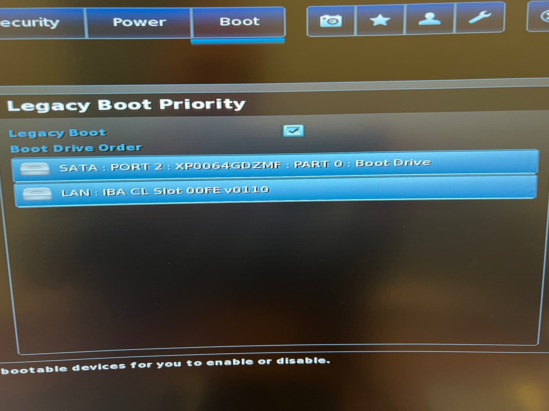

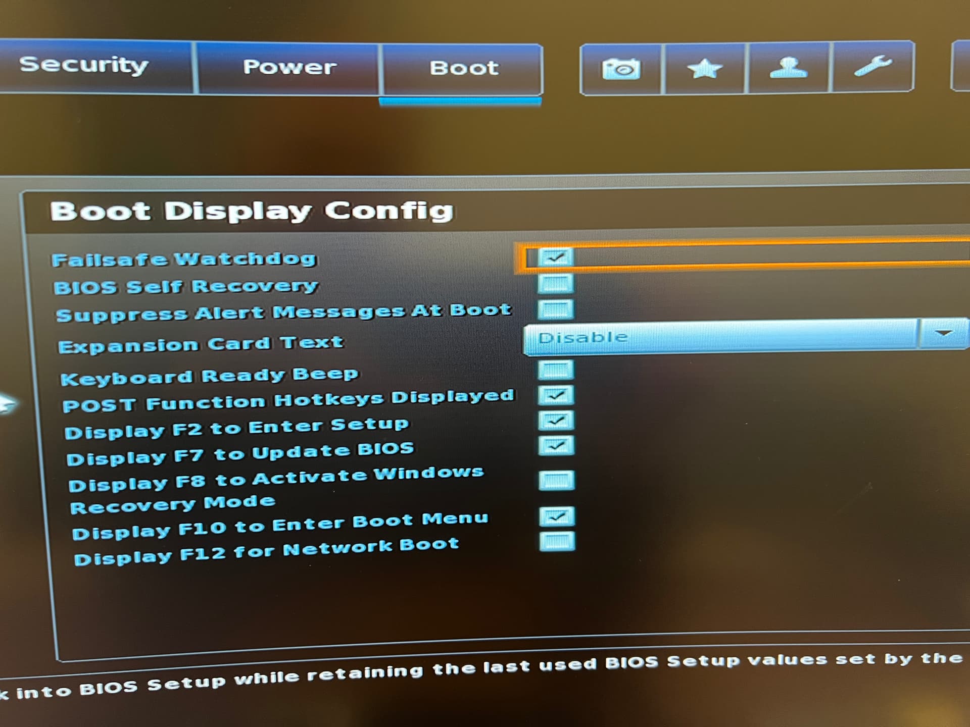

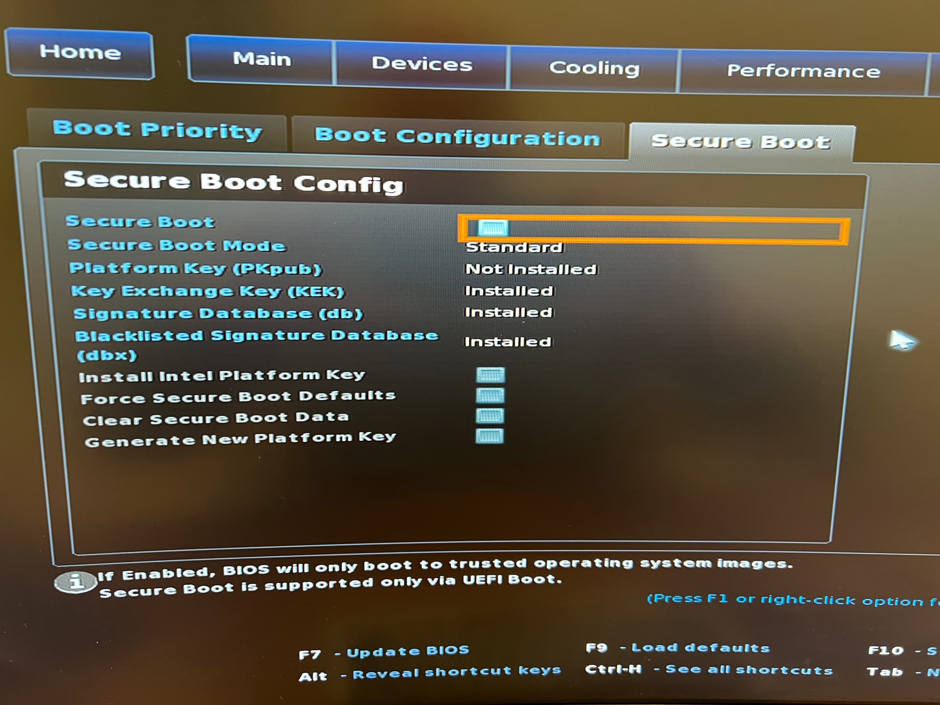

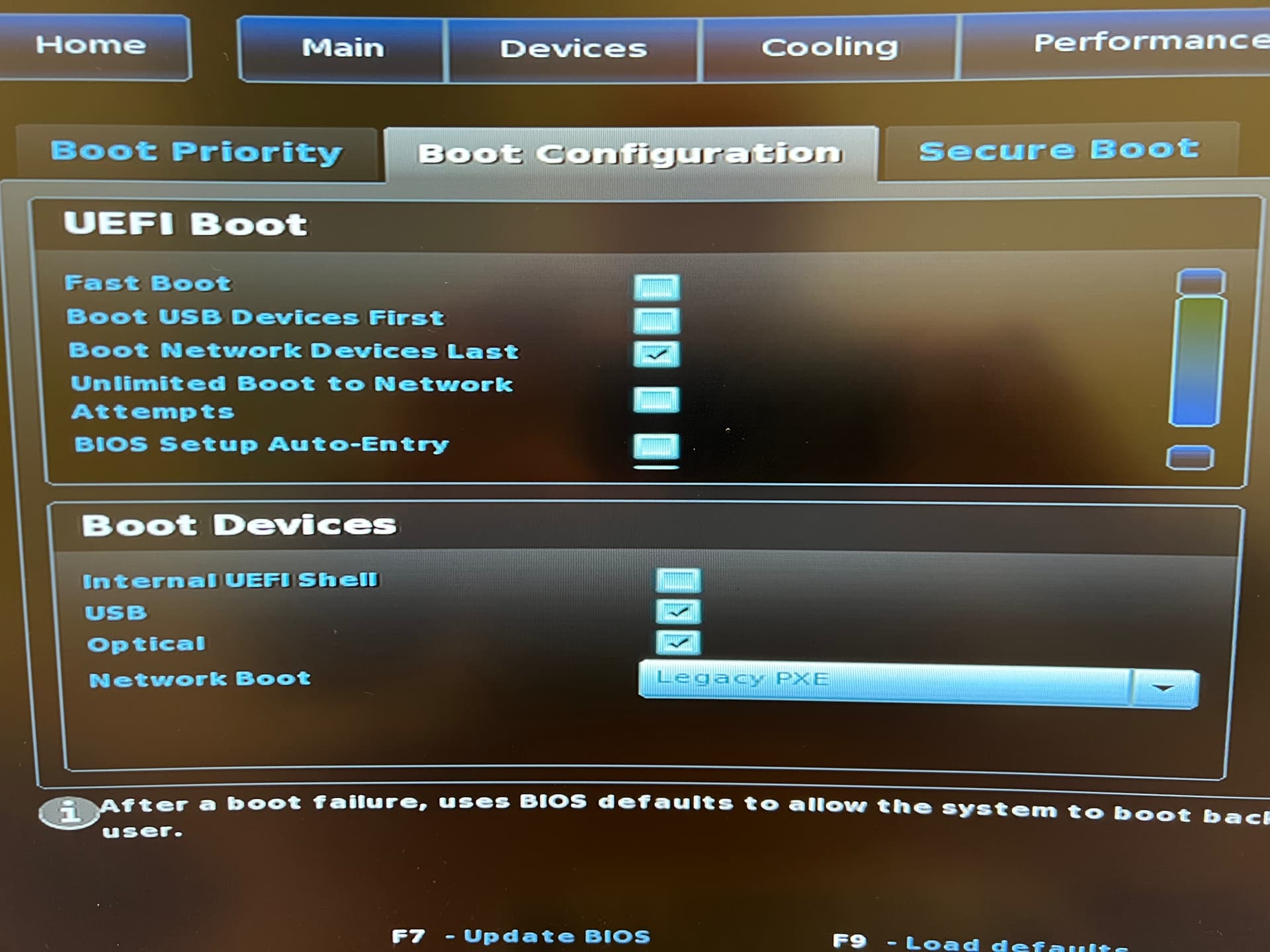

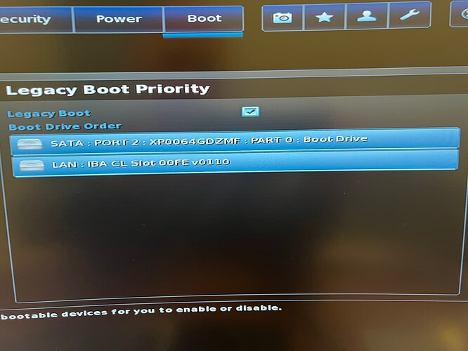

I’m including some screen shots for the original M.2 factory ssd as well as some screen photos of my current
as of this morning BIOS settings. There is also a screen shot from my web admin page for system details.

Let’s try resetting the BIOS settings to default. You can do this by pressing the F9 key while in the BIOS menu to load the default configuration.
After that, please attempt to boot from the original M.2 SSD that was delivered with the Nucleus device.
Let me know how it goes or if you encounter any issues during the process.
Vadim
I had actually returned BIOS to factory settings using F9, yesterday and in fact repeated this again today without any issues rebooting form the original M.2 SSD, any insight on how to install the larger crucial drive in my nucleus rev.a? Thanks Again

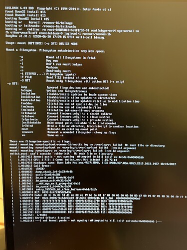

After a successful boot on original M.2 ssd, I’ve reinstalled music sata ssd storage. This prevents a successful boot up. There is some kind of conflict when installing the drive with the system start up. I’ve enclosed a screenshot.
Hi @Daniel_Hill ,
That error is indicative of a kernel panic, the solution for this is usually to reinstall RoonOS.

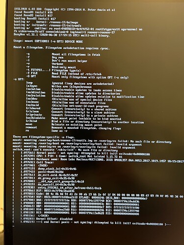

I have then reinstalled the music sata drive and rebooted to the boot failure shown
in the included screen image.
Not sure how to proceed here. System works fine without the sata drive, I’m guessing
that the drive is causing a “kernel panic” in any case I can wipe the drive and keep trying to

It sounds like the SATA SSD is currently marked as bootable, which might be causing the system to attempt booting from it instead of your M2 device. The step you can take is to remove the boot flag from the sata SSD partition or change the boot order, which should help avoid this issue.
