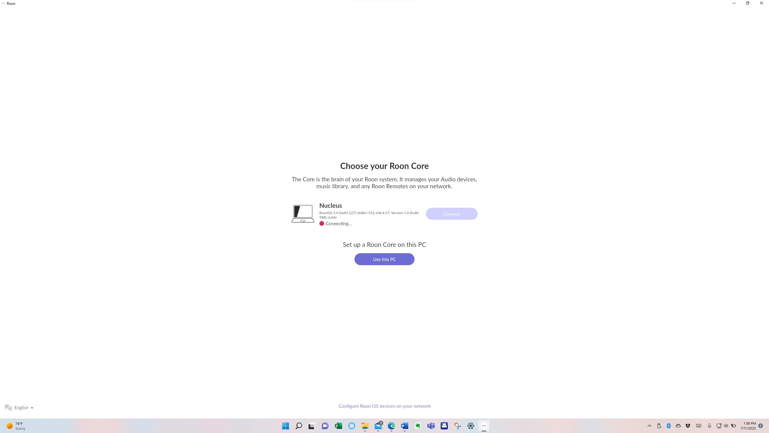

For the past few days, I’ve had my Nucleus has needed to be rebooted in the morning. This never happened before. This morning, after the reboot, it appears not to be able to find either the music stored on my NAS or Qobuz (although it says it is signed into Qobuz). The NAS and Qobuz are working fine and are connected to my network. They just don’t show up in Roon.
Here’s a screen shot:

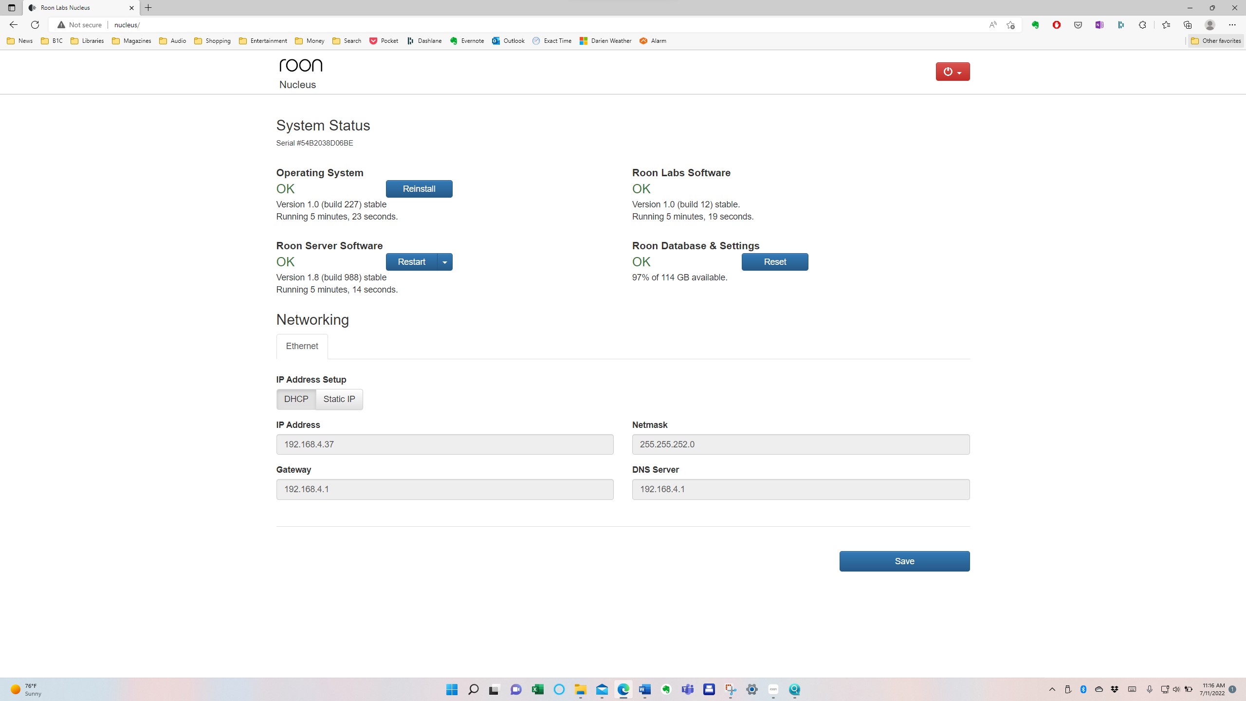

Give us a screen shot of the http://nucleus/ web interface?

I rebooted, but it still doesn’t connect:
Did you post the same picture? the uptime hasn’t changed. The os running time is showing 47 minutes and 37 seconds in each.
My mistake This is what is shows when I try to open Roon:
And this is the updated interface:
Should netmask be 255.255.255.0 not 252.0?

In the meantime change the netmask.
Thank you, Ged, for your helpful input. I’m not a computer expert so I don’t know how to change the netmask. It doesn’t appear to be editable in the http://nucleus/ web interface.
It’s coming from your router probably. You would need to change it there.
I’m wondering if some of your issues are due to network problems.
You can click on the static tab and type in the entries from the DHCP tab but change the netmask.
That will set it to your liking.

I’ve enabled diagnostics for your Nucleus and I’m seeing signs of a failing M.2 SSD on your system, we need to RMA the Nucleus unit to ensure that things go smoothly moving forward. I’ll follow up via private message to gather purchase details.
Unless you are using multiple subnets and know how to configure them, I suggest using the standard 255.255.255.0 netmask. Otherwise, some devices can end up on different subnets and not able to talk to each other.
