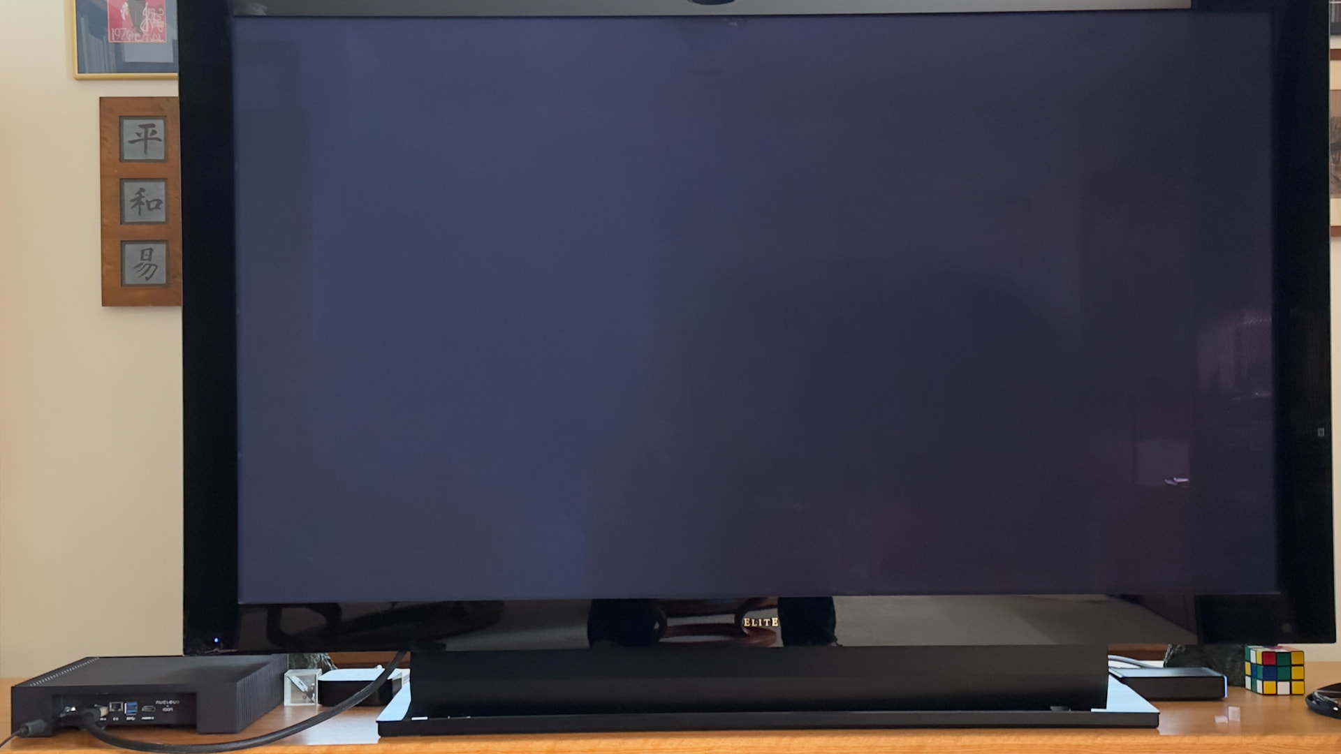

TV screen is blank. See image:
Hello @John_Graff ,
Thanks for confirming there is no HDMI output. If you’ve double-checked that there is no screen sizing options preventing the full screen from displaying (overscan feature), then this is indeed most likely a hardware issue. To get in touch with our RMA team, please fill out the form listed below:
