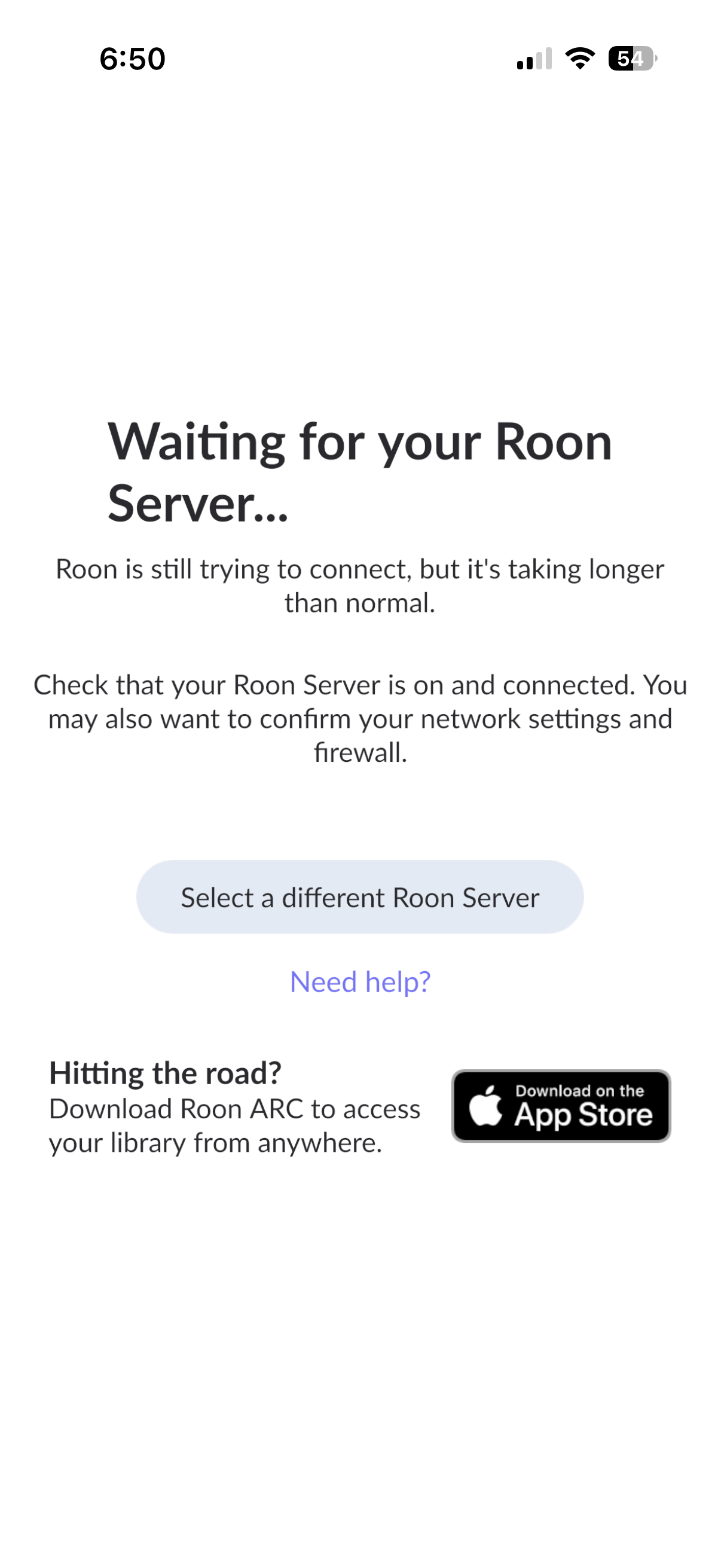

Nucleus not detected by devices despite network activity light (ref#4GAG7F)
Is Roon Server running?
Hi. I have a Nucleus that has been working fine, and now none of my devices can find the nucleus. So I went and looked at the back, there is a green light blinking where the network cable plugs in, should it be solid green? I unplugged the power for a minute. How can you tell if it’s working?
