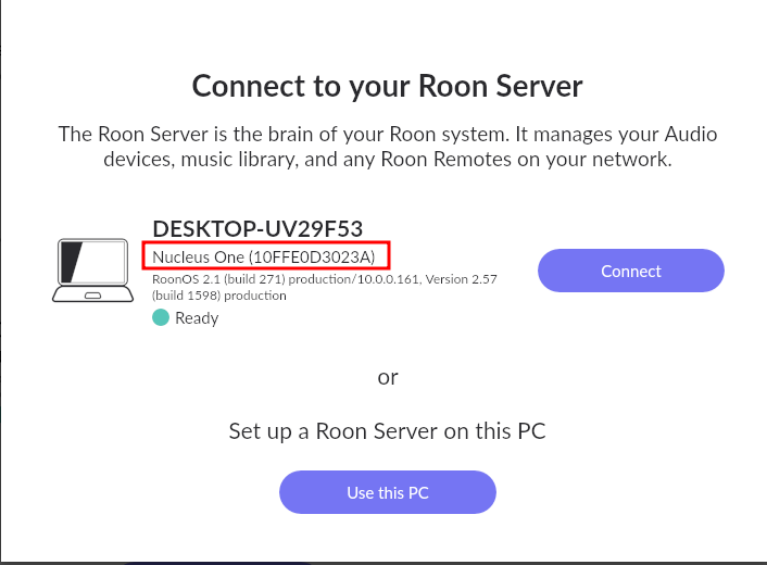

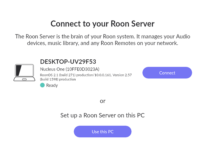

I tried what you mentioned but I’m not sure it worked correctly. See the screen shots I’m seeing.. Please advise…
Hi @Alan_Chapin !
According to your screenshots it looks like you were able to connect to your Nucleus.
if you want to access the internal storage of nucleus please use this article in order to get SMB instructions.
Let us know please in more details what are you further intentions and problems.

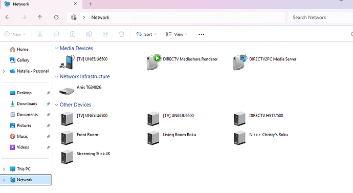

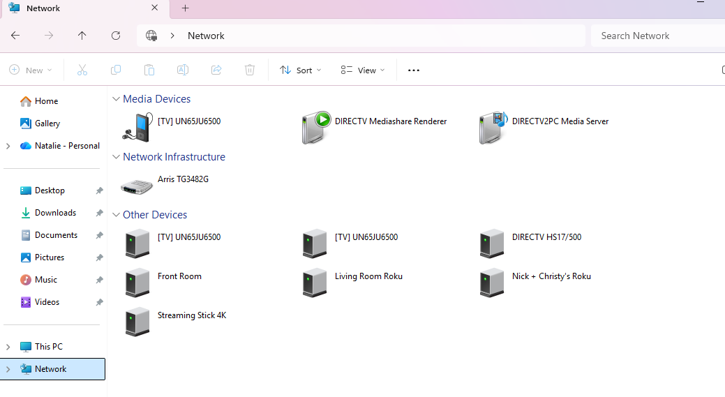

The Nucleus is not seen on my network. When I disconnect the desktop there is option to select the Nucleus? My backup drive is currently connected to the Nucleus.
Hello @Alan_Chapin
Thanks for the clarification — I can see where the confusion is coming from, and this is actually a very common situation.
Your Nucleus is already detected and being used correctly as the Roon Server.
The reason you’re still seeing a name like “DESKTOP-…” in the UI is because:
  • Your Roon database was originally created on your old PC
  • When that database was later restored onto the Nucleus, the server hostname stored inside the database was carried over
So even though the UI shows a name that looks like a PC, the server you are actually connected to is:
  • Your Nucleus One
  • Running RoonOS
  • With your external drive attached directly to the Nucleus
The name you see is just a label, not an indication that Roon is running on the PC.
Roon Nucleus does not appear like a normal PC in Windows Network Explorer. That’s expected.
To access it:
  • Use the Roon app (which you’re already doing), or
  • Use the RoonOS Web UI, or
  • Access storage via SMB using the documented Roon instructions

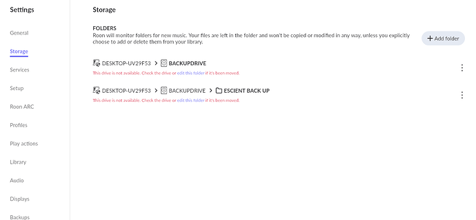

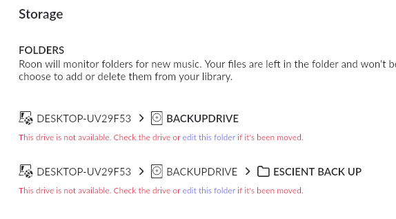

There’s one more important piece to clear up, which explains the “This drive is not available” messages you’re seeing.
Your Roon database still contains folder paths from your old PC setup, for example:
  • DESKTOP-UV29F53 > BACKUPDRIVE
  • DESKTOP-UV29F53 > BACKUPDRIVE > ESCIENT BACK UP
Since Roon Server is now running on the Nucleus, those PC-local paths no longer exist, so Roon correctly reports them as unavailable.
To fix this cleanly, we need to know where your music files physically live now. Could you please confirm one of the following:
Option 1 — Music is already on the Nucleus
  • The music files are on:
    • the internal storage of the Nucleus, or
    • an external USB drive connected directly to the Nucleus
In this case, you’ll want to:
  • Go to Settings → Storage
  • **Edit ** the old DESKTOP-… folder entries
  • Add the path to the correct folders that exist on the Nucleus instead
Option 2 — Music is still on the PC
  • The music files are still stored on your PC, not on the Nucleus
In this case, the Nucleus cannot see PC folders directly.
You’ll need to:
  • Share the music folder from the PC over the network (SMB)
  • Edit it in Roon as a Network Share (using a network path like \\PCNAME\Music)
  • Make sure the PC is powered on whenever you want Roon to access that music

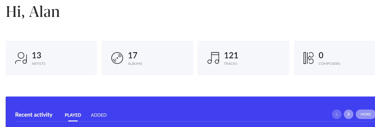

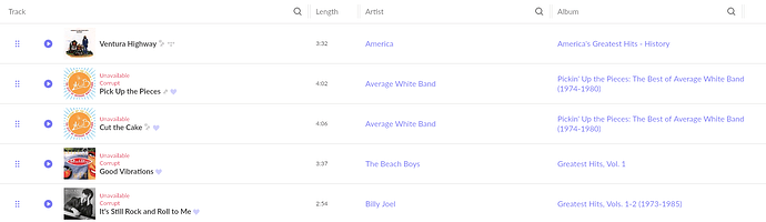

Hi Vadim, I really appreciate all your help! I reconnected the backup drive (where all my music is stored) to the PC and now I’m able to play some of the music from my play lists but not all? I can select certain songs and they play but others do not play. They show as being unavailable or corrupt but that’s not consistent because some still play but others not even though they are labeled as (unavailable corrupt) . I know the music is good because I can play the songs directly from the backup drive via windows media player. Also what is being played is not correctly displayed at the bottom of the roon screen. Another thing I still see is on the home page that does not show all my collection correct (artists, albums,tracks,composers) See screen shots attached..

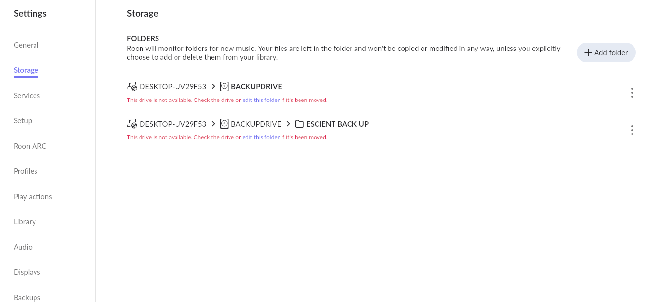

Hey @Alan_Chapin,
Could you please share another screenshot of your Roon Settings>Storage?
If you haven’t yet, I’d again safely stop and reboot your Roon Server / Nucleus.

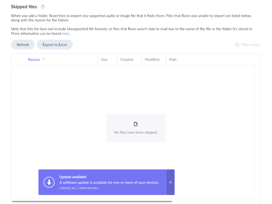

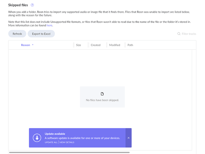

Afterwards, head to your Roon Settings > Library > Skipped files, and let us know what you see. It could be useful to review your Clean up Library window as well - don’t perform the clean up function (as it will remove any corrupt or issue tracks), but it’ll give us a good indication as to how many tracks are throwing errors.

This is what I’m seeing…Please advise..

Hello @Alan_Chapin ,
Thanks for the additional info. Can you please navigate to the storage page once more, click the 3-dot menu next to each storage location and perform a forece rescan action. Does this help restore the library?
