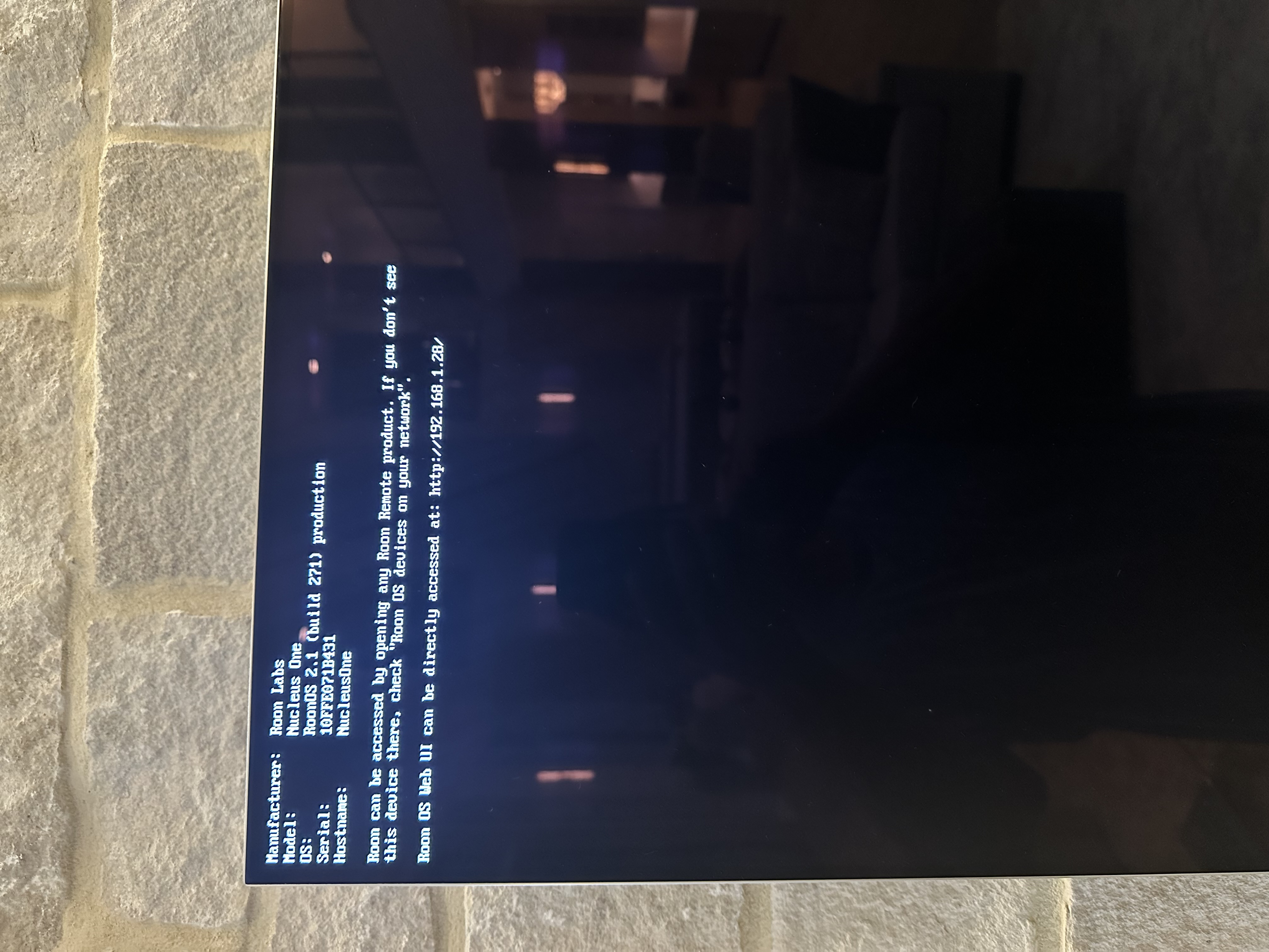

· Cannot find Nucleus on my network. Just received back from servicing by Roon (would not power up)
· Direct ethernet connection from Netgear router, 1 Gig fiber, (it is going through a Netgear switch also) It's on my network, I can see the device is online but the Nucleus not discoverable using my laptop or phone app.
Are you able to access the RoonOS Web Admin Interface from a browser?
Your screenshot is a bit fuzzy bit I think is states http://192.168.1.20/
Also worth checking is that Nucleus is on the same subnet as your LAN, if not try resetting it …

It appears from your screenshot that the Nucleus One has possibly been relegated to a separate subnetwork from your other devices.
If you’ve confirmed all your devices share one subnet, then we’ll need to troubleshoot the possibility that multicast traffic is being restricted by a router, switch, or node. Device discovery announcements from the server don’t seem to be reaching your laptop and iOS devices over the WiFi.
