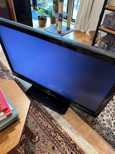

Thanks, guys! I connected TV to the Nucleus via HDMI and got a blank screen, alas.
I tried this in two ways: first, I brought the Nucleus to the TV (in another room) disconnected from the router. I got it to show these words on the menu screen: “Intel NUC”, but nothing else. Then I moved the TV to the other room next to the Nucleus when it’s connected to the Router, and tried that with the HDMI connection. Nothing, just a blank screen. I’ll see if I can send some images.
message when connected to TV (not connected to network)
Image of the TV screen connected to the Nucleus when it’s connected to the Synology router.
Hey @Ralph_Rosen ,
If you got a blank screen when the Nucleus was connected to both the router and monitor, you may be experiencing hardware failure on the device. I’d double check cables and ports as a next step, and if the screen is still blank, please get started on the RMA process via this typeform below: To do so, open the Typeform link below and select ‘Other ’ followed by 'This issue is related to a physical component ".
Typeform link : Nucleus Troubleshooting
Screenshot for reference:
They’ll help get you sorted out moving forward. Thanks!
