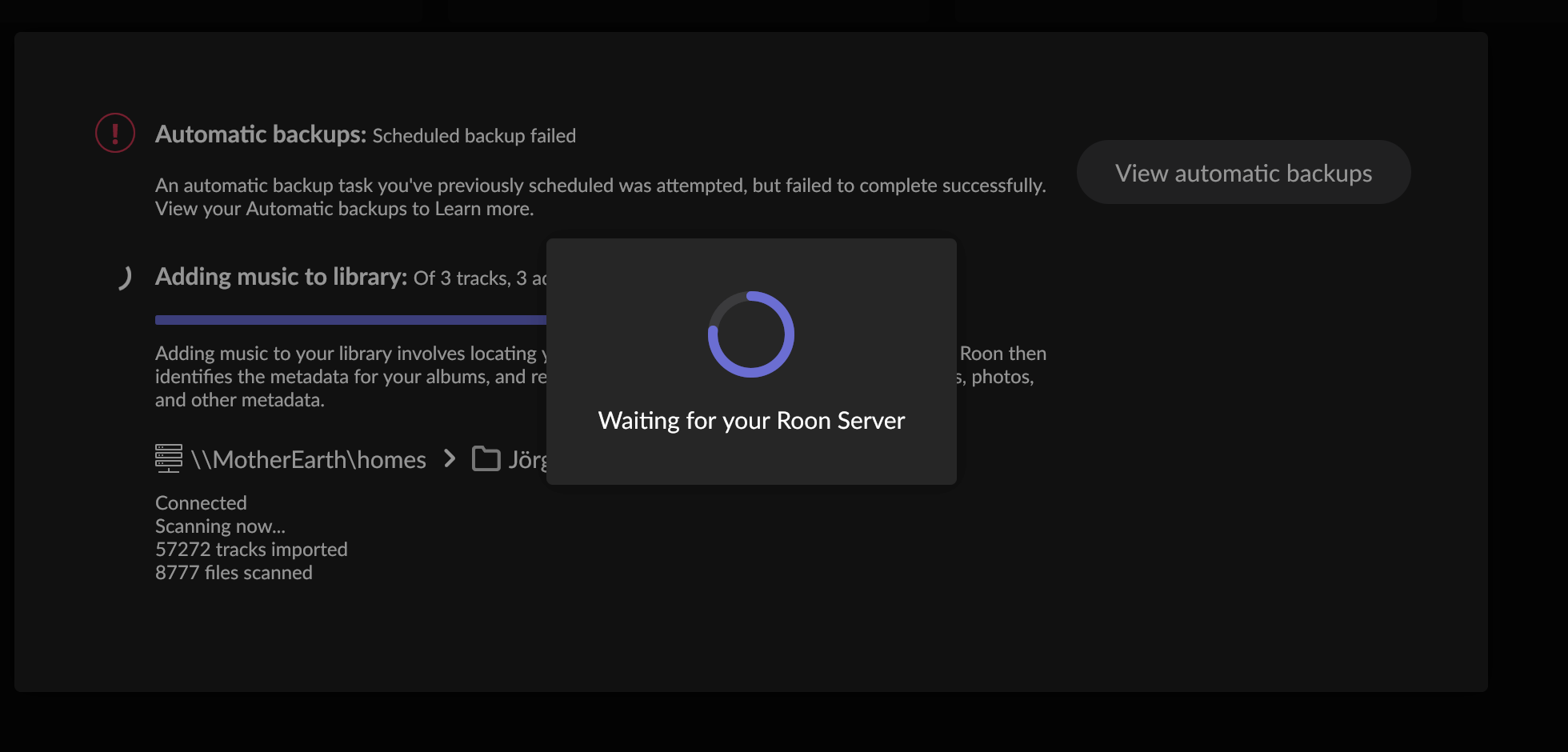

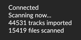

I was successful at restoring from my most recent backup within Tidal titles available immediately and also all may and when I shared my NAS it also started importing files. I was even able to play some of them. The import hat been running for about 55 hours now and is still not complete. I mostly see the animated Roon icon, but sometimes see my home screen for about 10 seconds before it goes back to the animation again. Roon is in the meantime unusable, which is a little frustrating.
Yesterday I got the information that 57k titles were imported with 8k scanned, now I get the message that 44.5k titles were imported and 15k scanned. My library size is 57k songs, not sure how it could have less imports than a day before?
Is this running correctly and do I just need more patience to run the restore with such a large library. Or is there another issue getting in the way of my being able to enjoy the music (and the Nucleus One?).

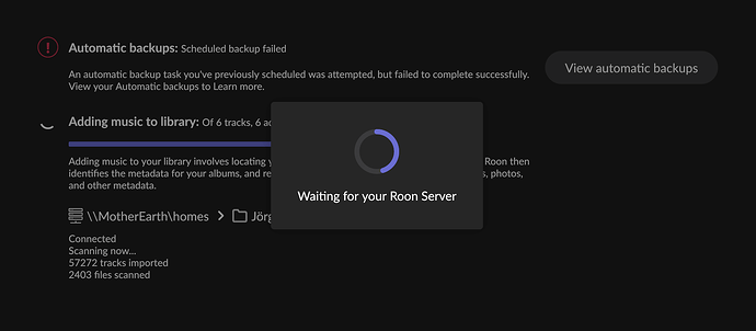

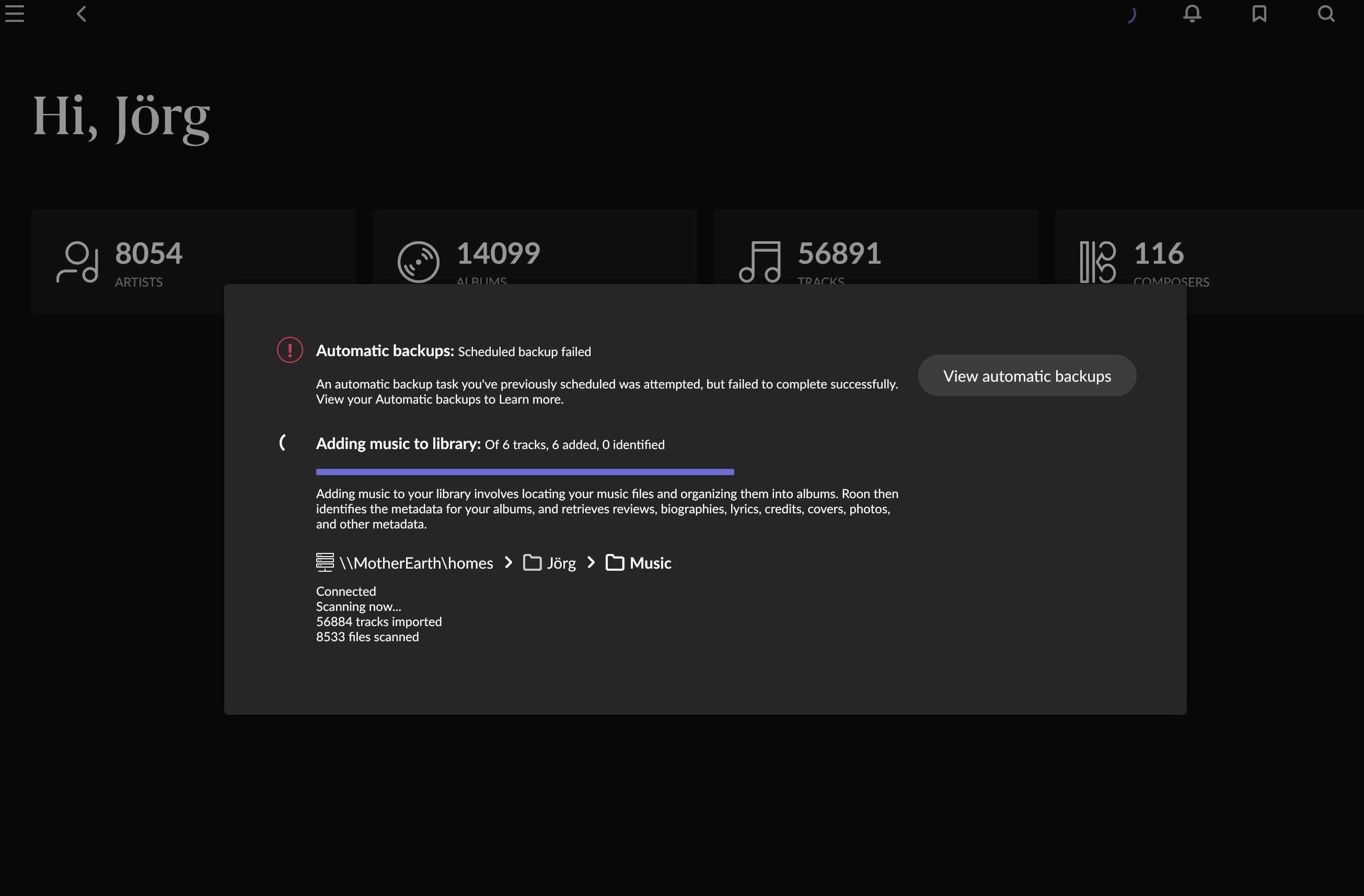

Hi, I did completely turned off the background an on-demand analysis. I could see that my restored backup was present. Playlists appeared and file import started. But after a while the animated logo appeared and stays on almost the entire time. I occasionally get to see the Home Screen for like 10 seconds with the circle animation in the right top corner. If I click there I get the information that files are scanned, but the everything disappears and goes back to the animated Roon logo. It is frustrating that it is not possible to monitor at all if the restore is happening and where it is in the progress. I have been running this for 4 days now and still can’t use Roon at all.
I don’t want to start my library from scratch and lose playlists and the many hours I invested in album identification.
Any help is appreciated.

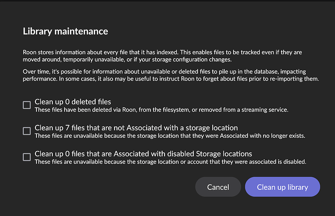

Thanks for giving that a try. I activated diagnostics mode for your Nucleus and I see that the number of tracks listed is almost at 100k, not at 57k as expected. I would suggest trying a Clean Up Library function in Roon Settings → Library to see if that helps, let us know!
Ok, this is strange. I have certainly not 100k song files on my drive. I reset everything again and cleaned up the Library. There were only 7 files that are not associated (correctly as I deleted their folder on my NAS).
