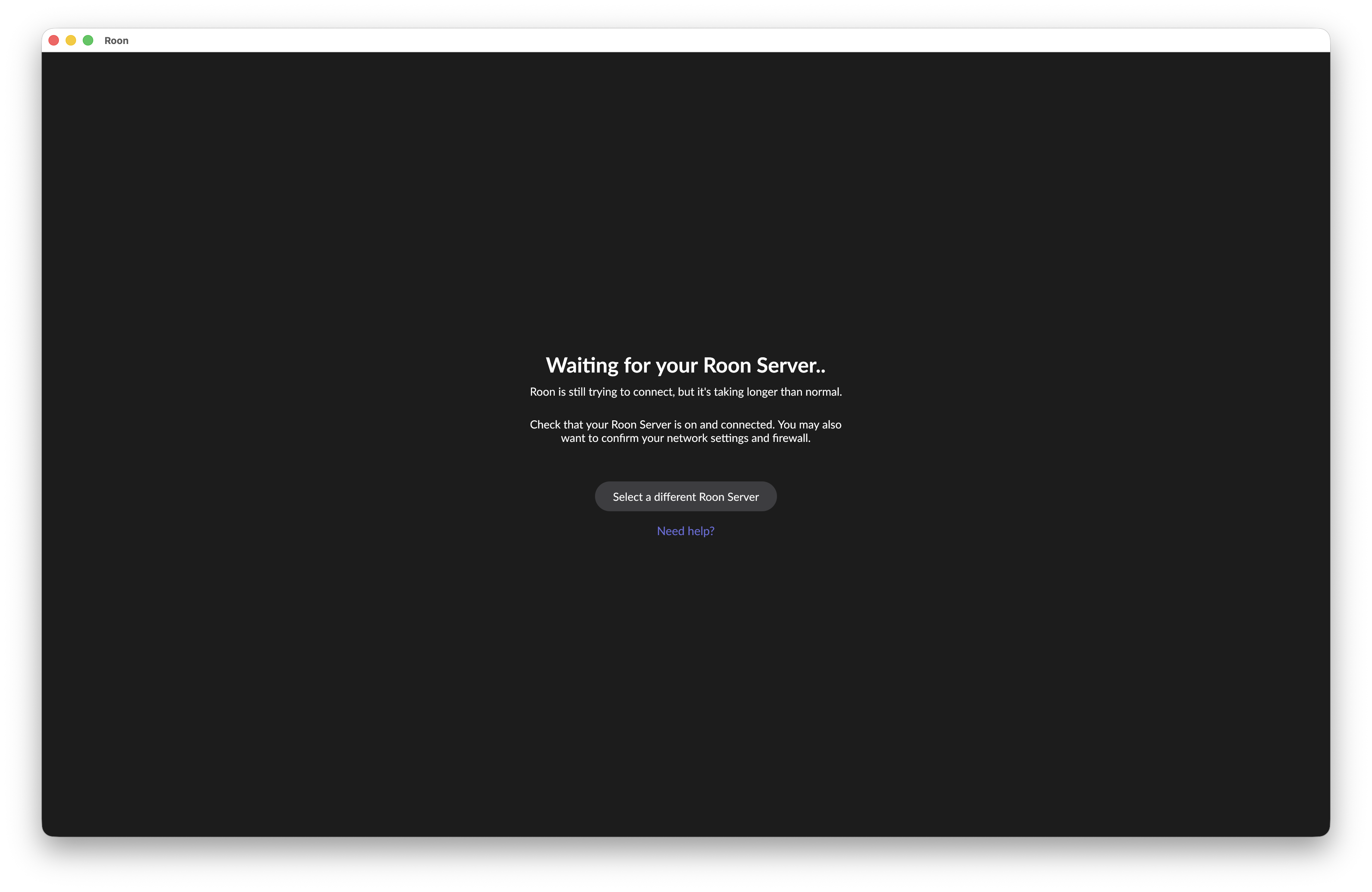

· I rebooted the Nucleus One approximately 2 days and 10 hours before this report. The server was responsive immediately after the reboot. The issue has since returned, and on 15 July 2026 at approximately 10:50 PM (UTC+8, Macau Time), Roon Remote again displayed "Waiting for your Roon Server" for more than 30 seconds before connecting. The server becomes progressively slower after one to two days of uptime, while rebooting temporarily restores normal performance.
My Nucleus One has recently become very slow and unresponsive. After rebooting, it works normally and connects instantly, but within one to two days the problem returns. When I open Roon Remote on my Mac, it often shows “Waiting for your Roon Server” for more than 30 seconds before connecting, and the interface remains sluggish. This started after a recent Roon update. I have around 2,300 albums, no DSP enabled, and rebooting only fixes the issue temporarily.

Thanks for sending those logs over so quickly, I’ve been through the full set and can share what’s going on.
Your logs confirm this is a memory-related issue on the Nucleus One, and the good news is it’s exactly the behavior the Early Access optimizations I mentioned are designed to fix.
Here’s what I’m seeing: after your reboot on July 13 (~05:07 server time), RoonServer starts at around 150 MB of memory and then climbs steadily the longer it stays up, roughly 2.5 GB by that evening, ~3 GB the next day, and pinned at ~4 GB (the Nucleus One’s ceiling) by July 15. As memory fills up, the server has to spend more and more time on garbage collection, and those become “stop-the-world” pauses where Roon briefly freezes. Early after a reboot they’re a fraction of a percent; by the time you reported the problem on the evening of the 15th, I can see individual pauses of up to ~14 seconds. A few of those back-to-back is what produces the “Waiting for your Roon Server” hang and the general sluggishness you’re experiencing.
This also explains why rebooting helps but only temporarily, it resets memory back to ~150 MB, and the slowdown returns as it climbs again over a day or two. Importantly, I’m not seeing any crashes, network, DNS, or storage errors in the logs, so you can rule those out, this is purely the memory-growth pattern, which lines up with normal use across multiple remotes.
So to directly answer your question on root cause: this is a memory-growth/GC regression in the current Production build, and the fix is the memory work in our latest Early Access release (Roon 2.71, build 1674). You have two good options:
  1. Move to Early Access now to get the fix immediately, or
  2. Stay on Production and wait, it shouldn't be a long wait before these changes are promoted.
In the meantime, a periodic reboot (and closing any idle remotes you're not actively using) will keep things responsive.
Happy to walk you through switching to Early Access if you’d like to go that route. Let me know how you’d like to proceed! :+1:

I’ve now migrated to the Early Access build, and so far it seems to have resolved the issue. Everything is running smoothly again, so hopefully that confirms your diagnosis.
