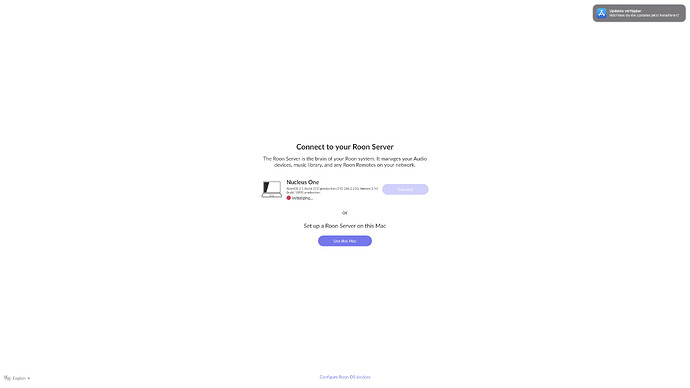

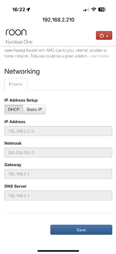

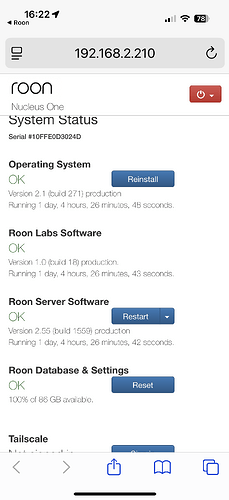

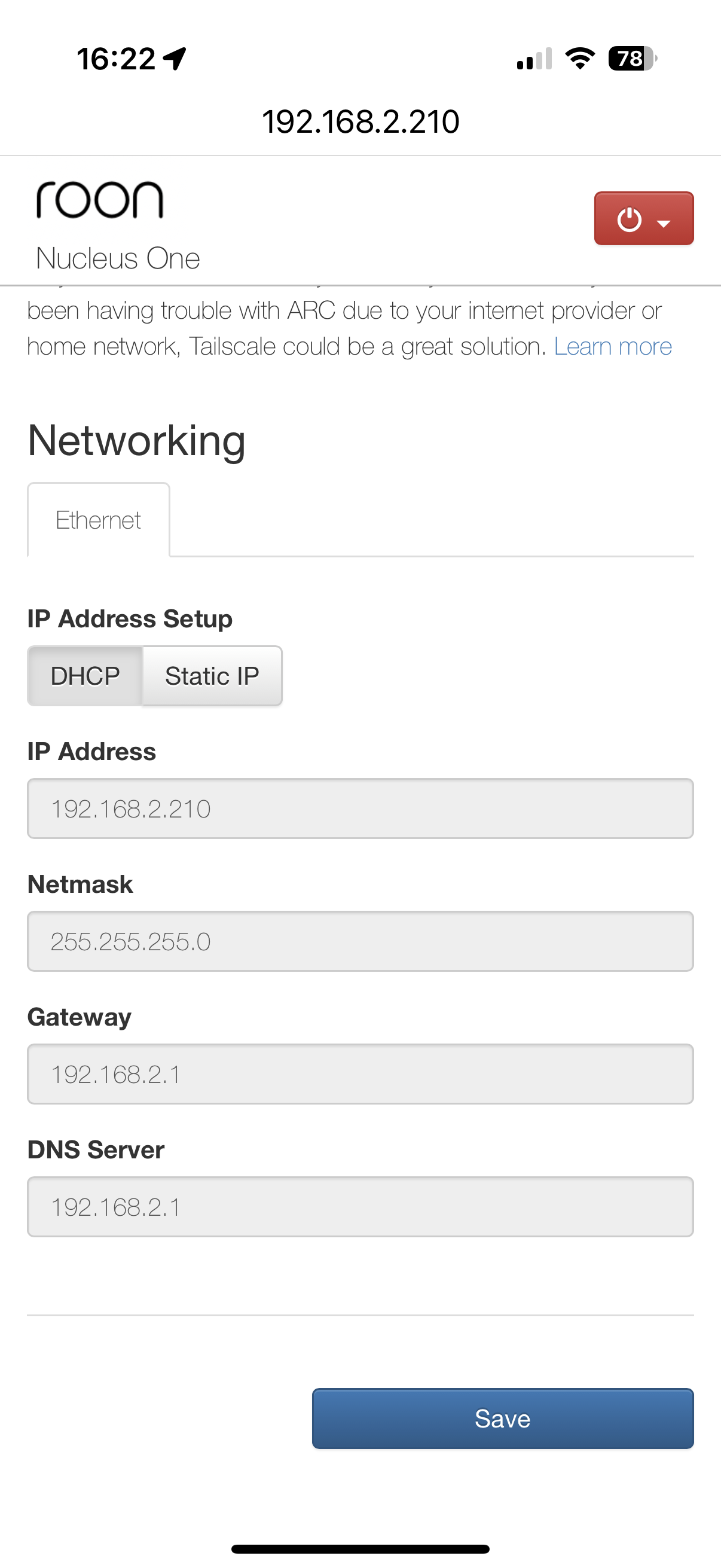

Hello, first the Screenshots
Before the Nucleus One, my iMac was the Core. The migration to the Nucleus One worked flawlessly, but now it doesn’t. Reactivating Roon on the iMac actually worked. Switching back to the Nucleus didn’t. However, I’ve since deleted Roon on the Mac, hoping that would solve the problem.

[/quoteThe core is visible to various devices but no connection can be established.

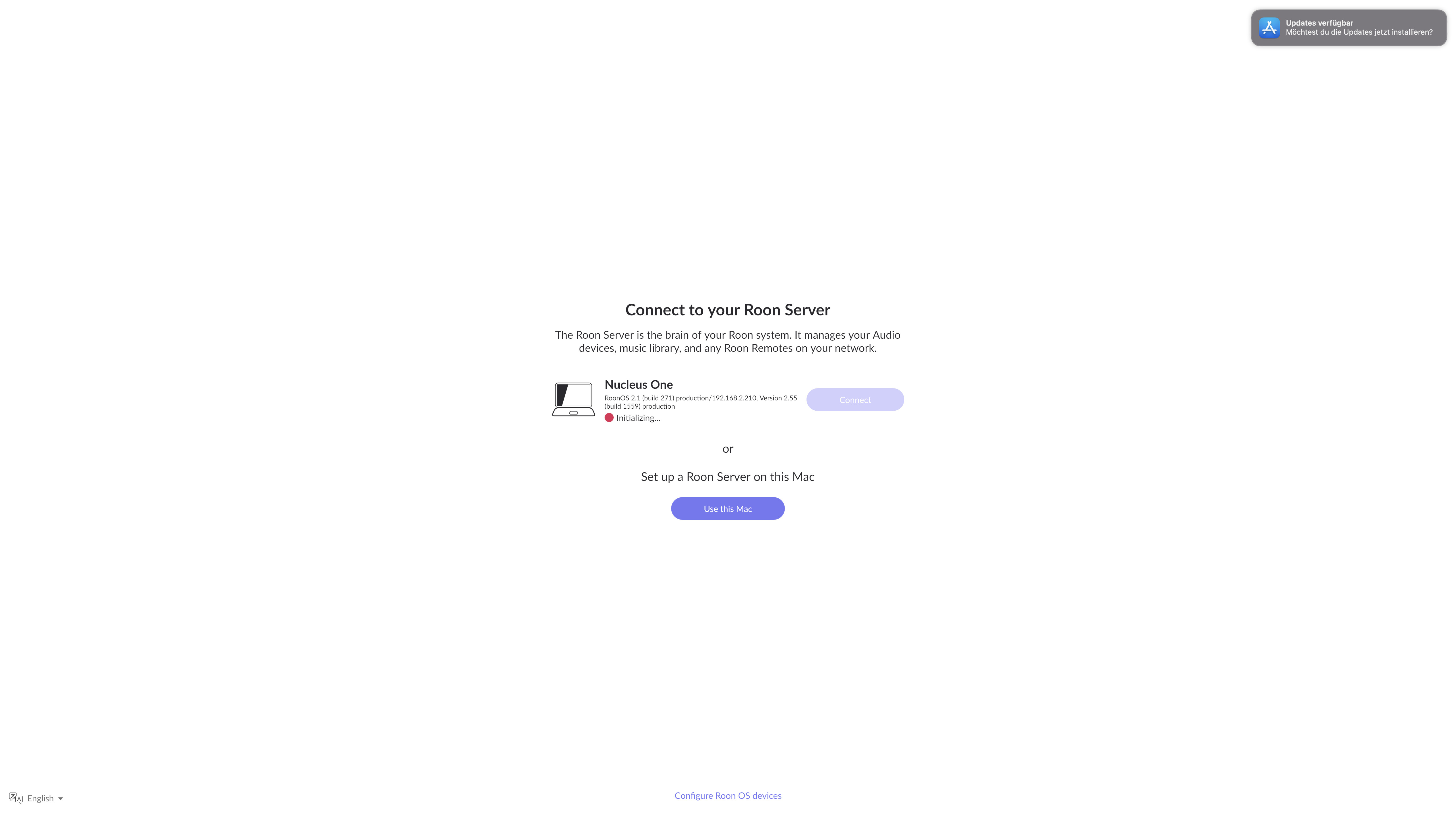

Hello,
When launching the Roon app on an iPhone or iPad, the Nucleus starts initializing until the “Connect” button appears. When clicking the “Connect” button, the Nucleus does not establish a connection to the device. It remains in a loop, as shown in the last screenshots.
When I first started using it, I transferred the backup from my Mac to the Nucleus. That worked. Now I’ve been able to transfer the backup to the Nucleus again, but I can’t establish a connection as described.
By the way, the Nucleus is connected to the network and turned on.

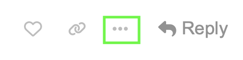

Go to one of the messages in the thread, click the … button:

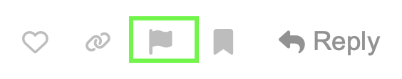

Then click the flag button:
