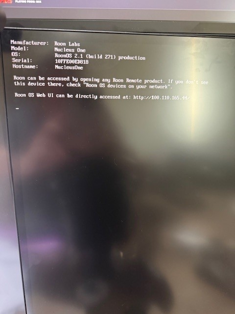

Thx Norris. So after trying that and some off/ on testing
the hardware seems to be ok. However nothing is coming up on “Roon OS devices on your network” I also cant access the Web UI displayed. it simply times out
Turn off tailscale if you have it running. That IP address is not a normal home private IP address range.
Thanks Daniel, that seems to be the address for the Roon OS Web UI access. I have deleted Tailscale however as very good suggestion. Still doesnt seem to be identified by the roon software although the network picks it up
This isn’t normal, though. 100.110.165.44 is an address reserved for ISPs for their Carrier-Grade NAT (CG-NAT) based on the Internet regulation, RFC6598. I.e., this is not an address that anything on your LAN should have.

Yes I agree. I need Roon Support to confirm what needs to be done as this is simply HDMI from Roon Nucleus One to monitor using HDMI. Software configuration incorrect? If i could log into the Roon OS Web UI then perhaps can reinstall software to fix it but I cant seem to access that UI to make a change

So everyone on here is awesome!! Appreciate the feedback. Blackjack I followed the network settings reset- attached the keyboard to roon and typed in network reset and… PERFECT… Really appreciate the help!
