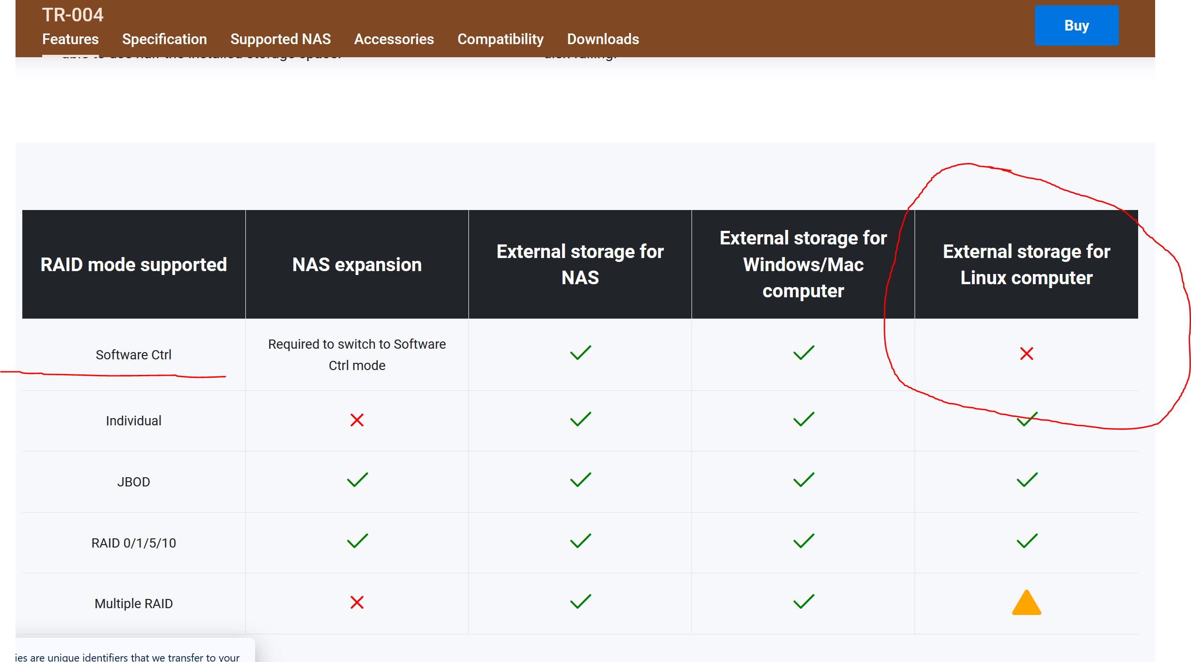

Actually, not quite true. It is not usable if setup to Use Software Control, because, as I and you mentioned, Linux cannot run the drivers, and the Nucleus can’t run drivers even if they did exist. However, it does have the option for hardware raid programmed by Dip Switches, which will allow it to be used with Linux OS without drivers. As shown in the grid clipped from the device manual.
I think the issue is that the RAID has to be setup from the start one way or the other. Just switching it after the RAID in software has been created doesn’t work, I don’t think.
Either way, I suggest you call the Manufacturer’s tech support and discuss what you are trying to do and have them give you guidelines.
