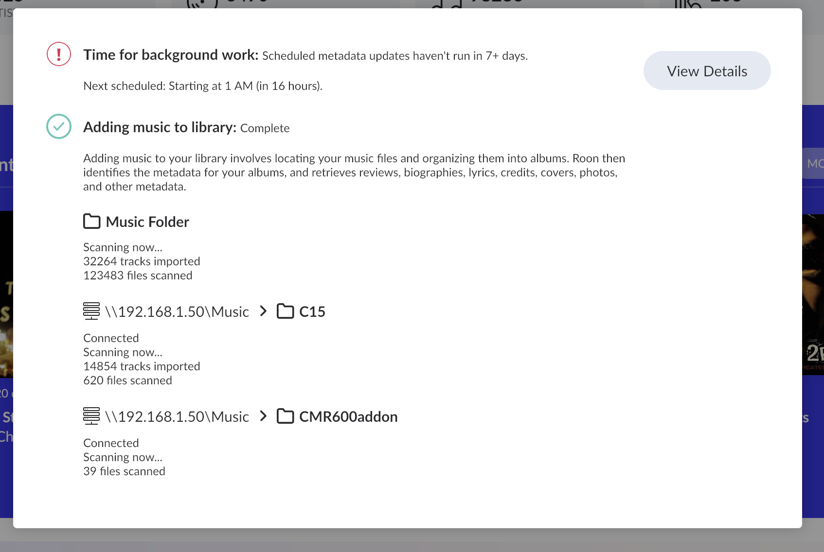

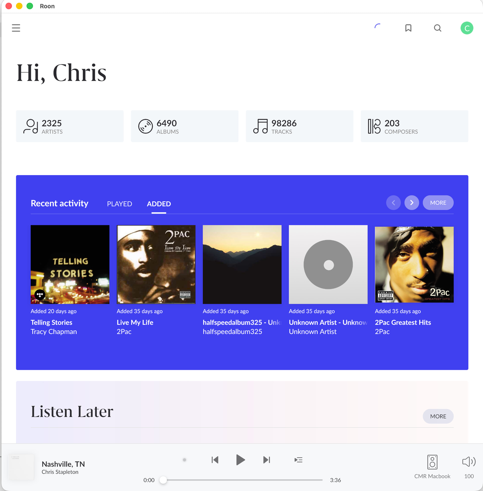

Hi there, here we go - fine on 14-year-old NAS and baby MacBook Air - not Nuc One
Roon is running on my Macbook now if that hellps and you can log in and see the current setup and backup restore

PS - I notice from your screenshot that you are very close to the 100,000 track limit for a Nucleus One. I suspect that with the 4GB RAM in a Nucleus One that you are running out of memory, which causes Roon to crash and the Nucleus One to reboot. It’s possible to upgrade the RAM, but be aware that Tech Support need to give approval for this. See:

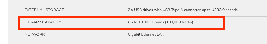

You’re on the right track. With your library sitting close to the 100,000 track limit, the 4GB of RAM in the Nucleus One is the bottleneck causing the reboot loop, so a RAM upgrade should resolve it. The good news is your backup itself is fine, as you’ve seen it restore cleanly on your other Roon Servers.
You can access this information within the Product Specs on the Nucleus One page here:
