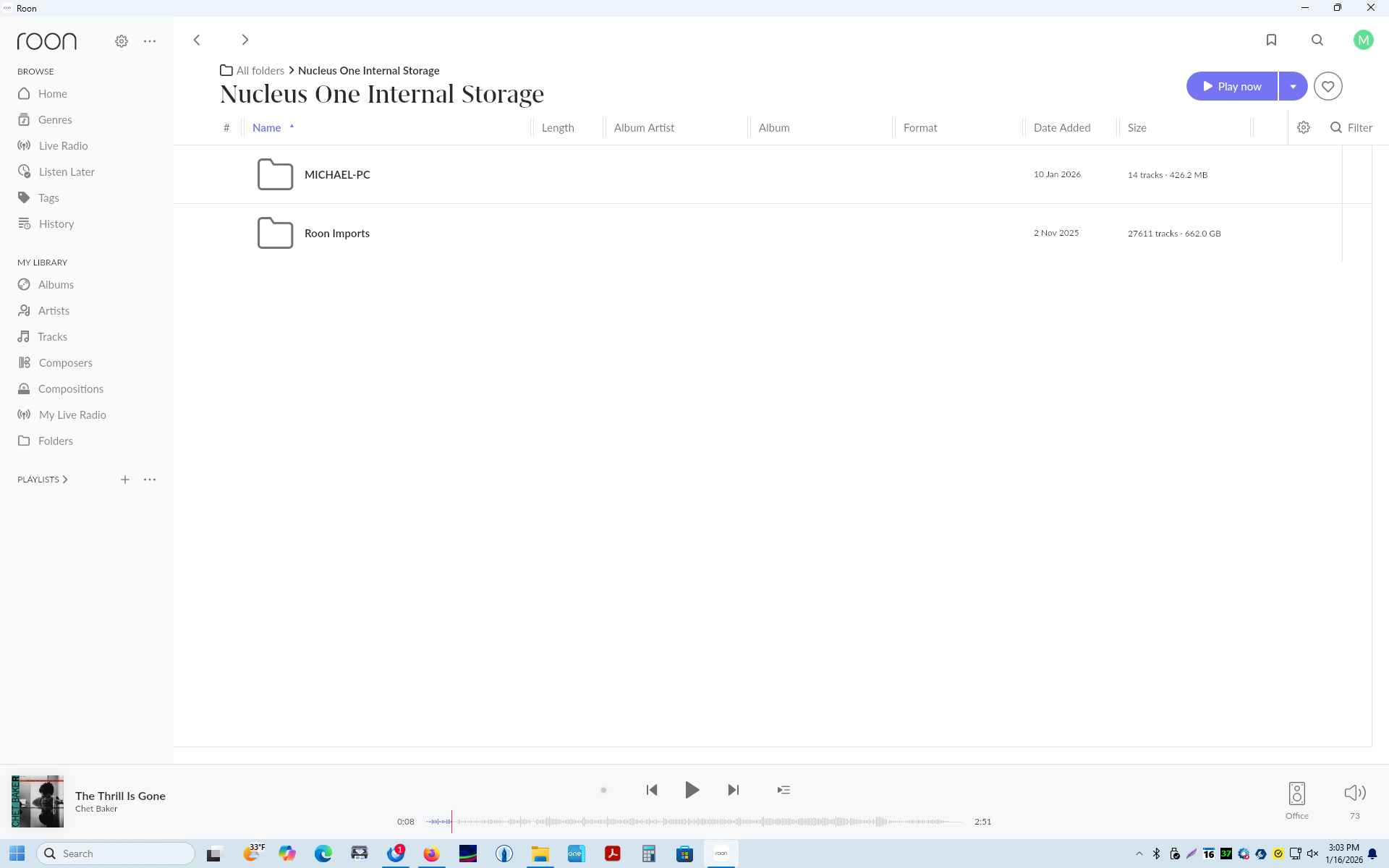

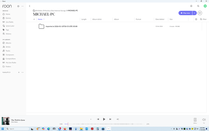

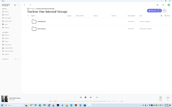

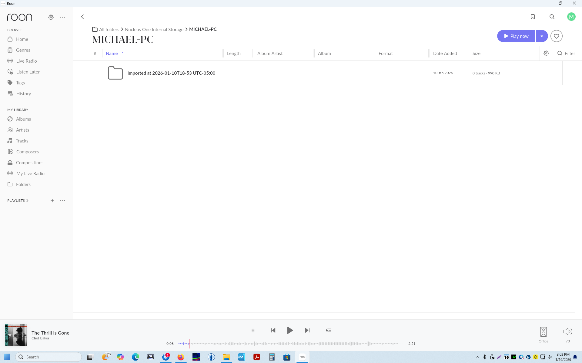

Thanks for the prompt response. Used File Explorer to create a Music folder in InternalStorage (couldn’t find a way to create a folder via the app). Went to Storage in Settings and clicked “Add folder”, but no folders are listed there. Storage does indicate Nucleus One Internal Storage “watching for new files in real time”. One other oddity I forgot to mention. If I click Folders on the Roon app interface, it shows the Roon Imports folder and also a MICHAEL-PC folder, separate from the one in the Roon Imports folder, which contains one date/time-of-import folder that in turn contains a list of files I previously deleted. Seems like it’s sort of a ghost folder.

It is a ghost folder. If you deleted the album from your Roon library, Roon removes it from your database and will delete the audio files, but it does leave the folder and any non-audio files (e.g. cover art jpegs or PDFs) in place. You will have to use Windows File Explorer to delete these files and folders manually if you want to clean things up.
It comes about because Roon originally did not have folder browsing, navigation and browsing of the Roon library was done solely by using the other browsers (e.g. Album, Track, Artist, Composer and Composition). Some users did not like this and wanted folder browsing as found in traditional media players.
Thanks for clarifying. As for the ghost folder, it doesn’t show up in File Explorer, which is why I was surprised to find it in Roon’s folder view. The other odd thing is that it has the same name as the folder inside Roon Imports folder that actually holds my imported files, other than the stray, deleted disc that is in the ghost folder. That disc is the last disc of a multidisc set I tried to import; the remains of the other discs (also deleted) are in the other folder. I brought this up because I thought it might be a clue. My troubles started after that import.

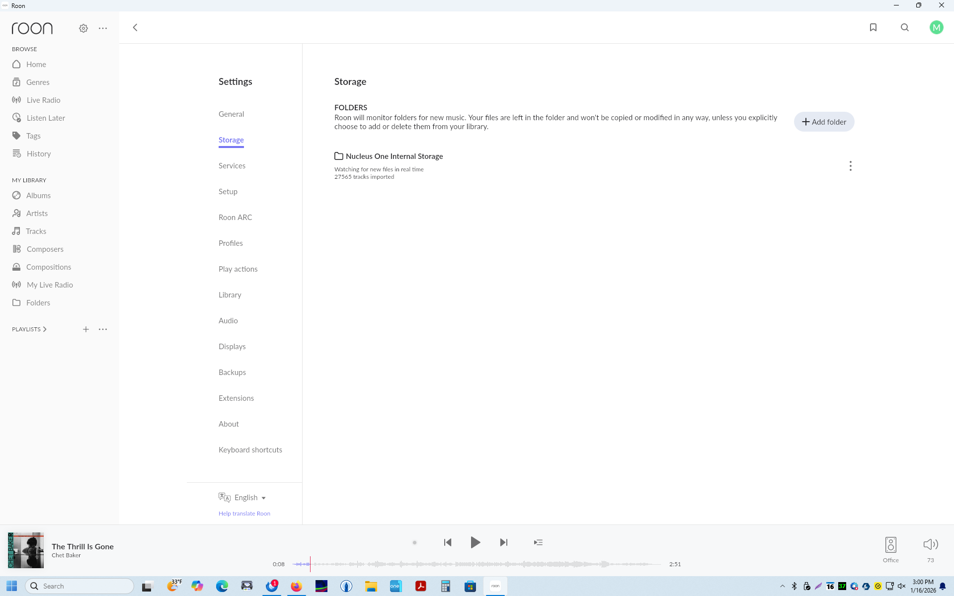

Also, please note what Connor (tech support) told me to do. He seems to think I can add a folder in InternalStorage and then make it a watched location. I can create the folder, but I can’t make the system see it. All very confusing and frustrating.
Hey @Michael_Riggs,
Thanks for all the additional information and troubleshooting so far, and apologies for any confusion here. For the internal music storage folder within your Nucleus, it should already be listed, and actively watched within Roon Settings>Storage.
If possible, would you be able to share a screenshot of your current Storage settings page?
With that, can you share the names of the specific albums you’re having issues with? We’ll enable diagnostics on your Nucleus to take a closer look behind the scenes.
Thank you! :raising_hands:
Screenshots attached. The trouble started when I imported a box set, Clifford Brown/Max Roach Quintet: Complete Studio Recordings. Worked the first time except one of the four discs wound up being listed separately instead of within the set, so I deleted all of it via the Roon app and started over. Subsequent import attempt failed. Later tried to import a couple of single discs, Quincy Jones Ultimate Collection and William Clarke: Blowin’ Like Hell. Those also failed, regardless of method used, direct copy or drag-and-drop. Do you think it might help to force a library rescan?
Hello @Michael_Riggs,
Thanks for the screenshots and the additional details.
As a next step, please try the following in this order:
  1. Restart the Nucleus One and wait until it is fully back online.
  2. From your Windows PC, copy the FLAC files via SMB directly into the Nucleus internal storage (for example into a normal music folder under InternalStorage).
  3. Once the copy is complete, go to Roon Settings → Storage, click the three dots next to Nucleus One Internal Storage, and select Force rescan.
This will ensure the files are picked up through Roon’s normal storage monitoring rather than the managed import pipeline.
Please let us know if the albums appear after the forced rescan, or if the behavior remains unchanged.
