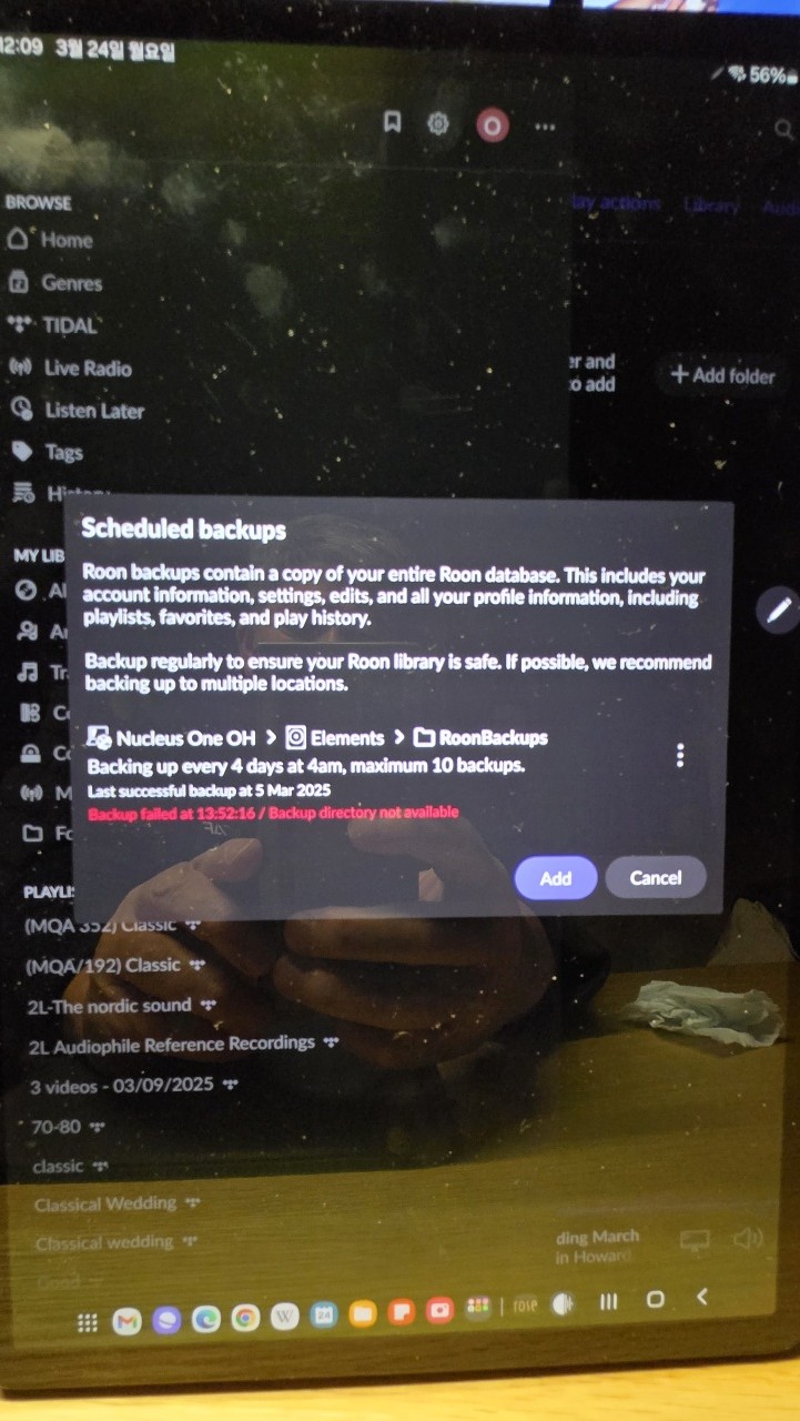

I baught Nucleus One a month ago(MAC : 10FFE00ED456 , and set up well with my external HDD(5TB). But a few days ago, Nucleus One doesn't recognize HDD. When I install One first time a month ago, everything was OK.
- restore doesn't work(I setup restore location to HDD)
- setup->storage->add folder . but nothing on the screen "choose music storage folder".

  • When I got this a month ago, I did setup backup directory which you can see the picture I attached.

The internet in my house is connected from the home router to the TV set-top box via a LAN cable, and the Roon Server is also connected to this with a LAN cable. I use Roon by connecting my tablet or notebook to the router (with the same SSID) that Nucleus is connected to via Wi-Fi using the Roon app.
  • When I connect a 5TB HDD to USB, the LED light on the HDD turns on.
  • Tidal sync is working again. I searched for songs in Roon and added them to a playlist, and the playlist on Titan was also updated.
What do I need to do in Roon to sync with Tidal?
  • Things that are still not working:
  1. Storage->Add folder is not working. The songs on the HDD.
  2. The backup function is not working. I bought it a month ago and specified the backup location on an external HDD during setup.
  3. These two functions were working when I first bought it a month ago, but they stopped working about a week ago.
    As you suggested, I tried turning off the Roon Server power and then connecting the HDD, but it had no effect.
