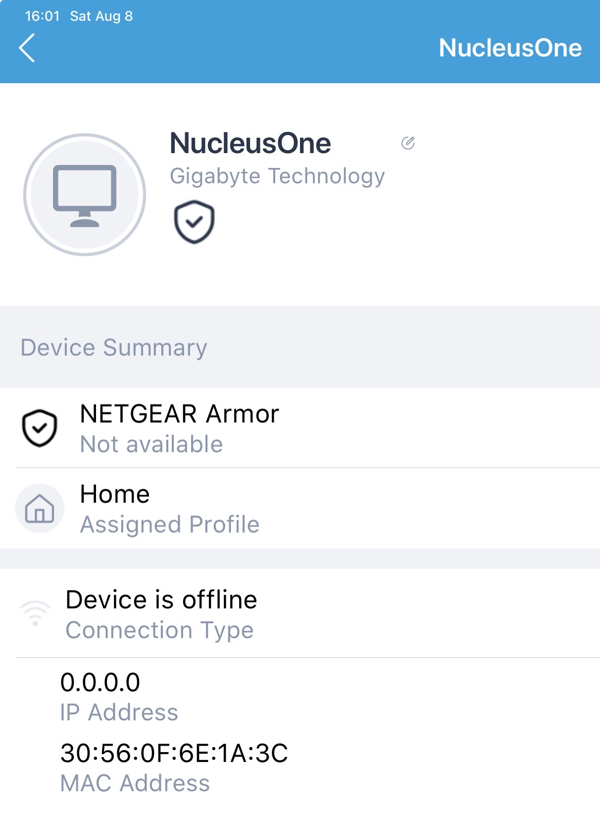

Nucleus One. Virtually new. Replaced an old Nucleus Plus. Was working fine, even with first 2.71 update. But then Roon pushed out an new 2.71 update, and since that time, the Nucleus randomly disconnects from the ethernet network. All other equipment on the network is working fine. The cable connection is fine. The Nucleus power is on (light is on), but the Room Remote (in my case an iPad Pro 13”) shows no Roon Server on the network work. The router shows no connection to the Roon Server. If I reboot the Nucleus (have to either unplug it and plug back in and turn on manually, or use the power button to turn off and back on), everything comes back like nothing happened. Then randomly (last time it was working for less than 30 minutes) the same thing happens. The Nucleus is power on, music is playing, then it suddenly disconnects and the app can’t find it and the router says it’s disconnected. Again, no other equipment on the network is have any problems.
I’ve rebooted the iPad, checked the ethernet connections and verified signal is getting through…in fact, the lights at the Nucleus ethernet port stay on, yet it disconnects and does not reconnect automatically.
Very weird.
At no time have we lost internet connection. At no time has the router stumbled. Every other connected device has been working fine with zero issues.
Left it on overnight with no music playing…was fine this morning…still on and searchable, etc.
Started playing music and within a short time, it disconnected AGAIN.
Driving me crazy.

Hello @FastHound
We have your logs and this is not related to the 2.71 update. You are already on the latest build, and what we found is a hardware fault.
Your Nucleus One’s kernel log is full of PCIe bus errors coming from the network controller. On 9 August it produced over ninety thousand of them in a single 58-second burst, so many that they overwrote the entire stored log history in about a minute. These are link-level errors between the network chip and the rest of the system.
That matches your description precisely. The port lights stay on because the cable link itself is fine, while the connection between the network chip and the system has failed, so the operating system loses the network entirely and only a full power cycle brings it back. It also explains why it happens while music is streaming rather than when idle, since the fault shows up under load.
This is not something a cable, a router port, a setting or a software update will fix.

Hello @FastHound
Two things.
Your Nucleus has not been in contact with us for the last 20 hours, so it has dropped off again since your last post rather than staying up.
And you can stop testing. Please do not run a new cable. The errors in your logs are PCIe bus errors, which happen inside the machine between the network chip and the rest of the system, over ninety thousand of them in under a minute.
This is a hardware fault and it needs replacing. Please open the form below, choose “Other”, then “This issue is related to a physical component”. That reaches the team who handle Nucleus hardware, and your unit is well within warranty.
