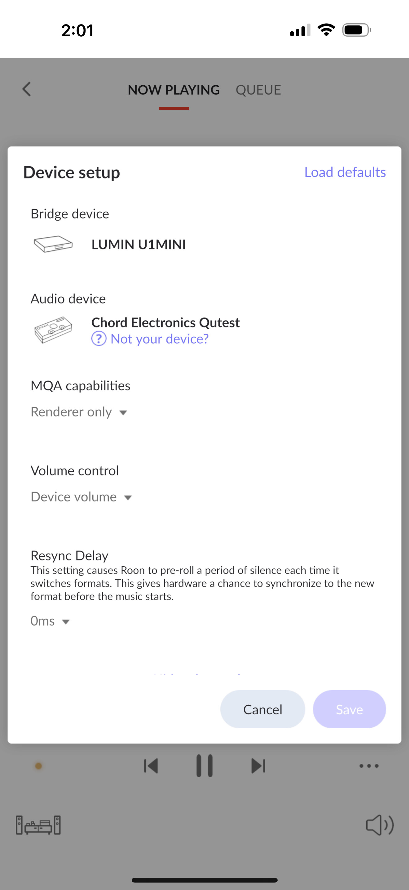

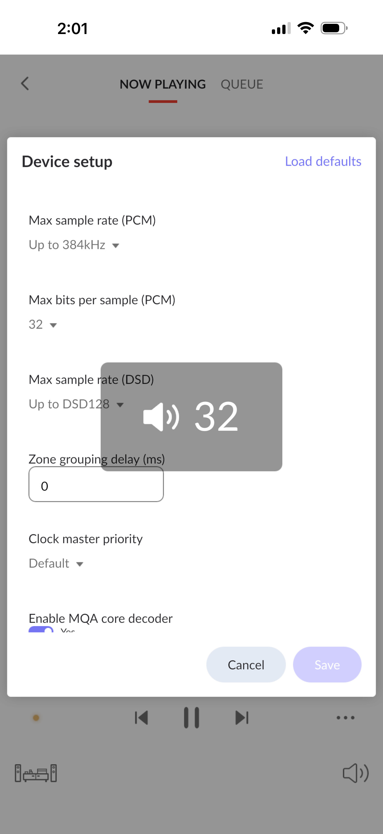

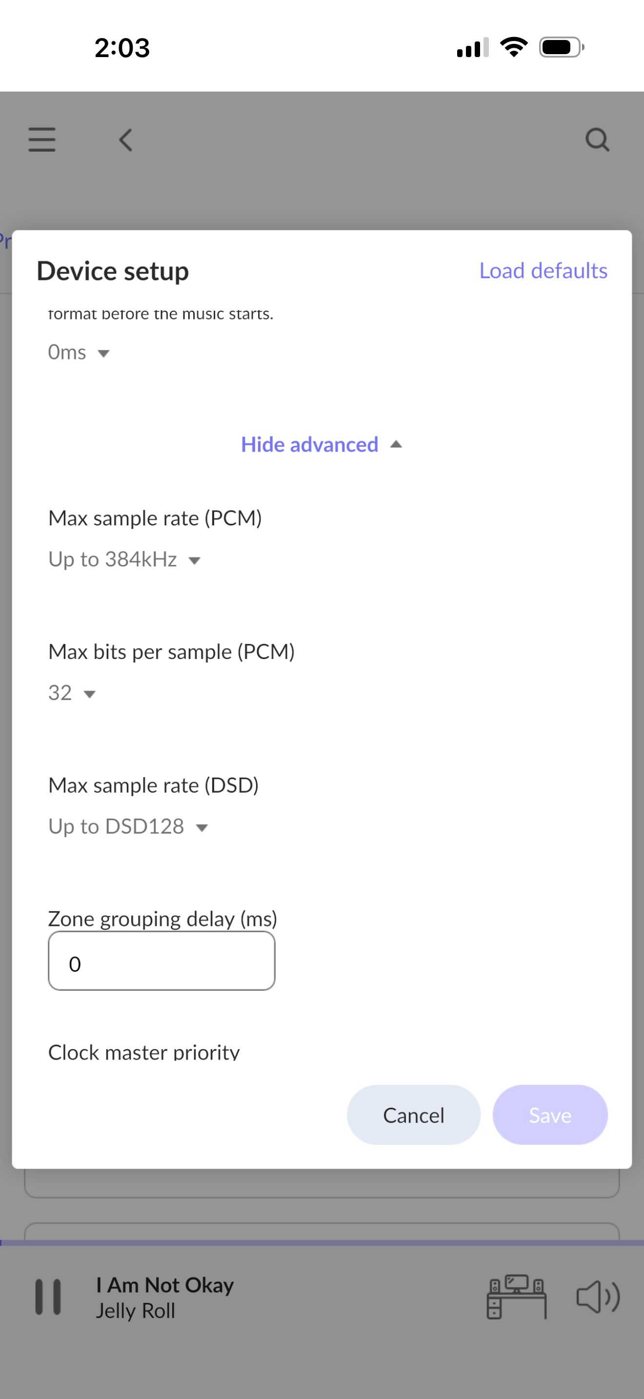

Thank you Daniel. It’s odd that it is happening with all the endpoints (the 2 Naims and the Lumin). I’ll attach what I have for the Lumin and Naim Atom. Let me know if you need something else (might need an explanation of where to get that)

Thank you Benjamin. I’ll try the refresh. In the meantime, here is the path when I try to play something on the Lumin/Chord. Signal path: Lossy
Click on any stage of the path to Learn more
Processing speed: 2.3x|
Source
AAC
TIDAL AAC 44.1kHz 2ch|
Bit depth conversion 24bit to 64bit Float
Sample rate conversion 44.1kHz to 352.8kHz
Bit depth conversion 64bit Float to 32bit|
LUMIN U1MINI
Roon Advanced Audio Transport
Leedh volume control • 32
Output
USB output|
