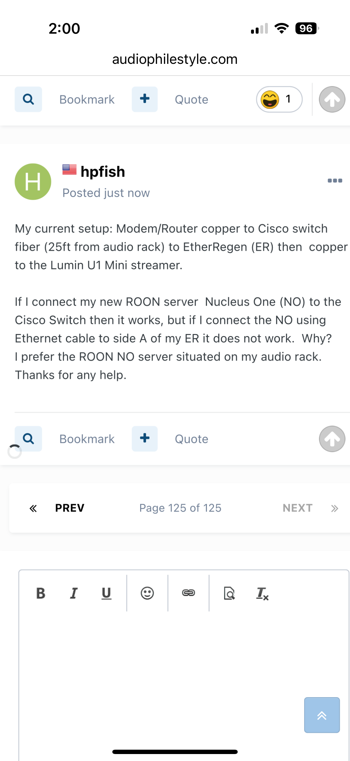

My current setup: Modem/Router copper to Cisco switch fiber (25ft from audio rack) to EtherRegen (ER) then copper to the Lumin U1 Mini streamer.
If I connect my new ROON server Nucleus One (NO) to the Cisco Switch then it works, but if I connect the NO using Ethernet cable to side A of my ER it does not work. Why?
I prefer the ROON NO server situated on my audio rack.
Thanks for any help

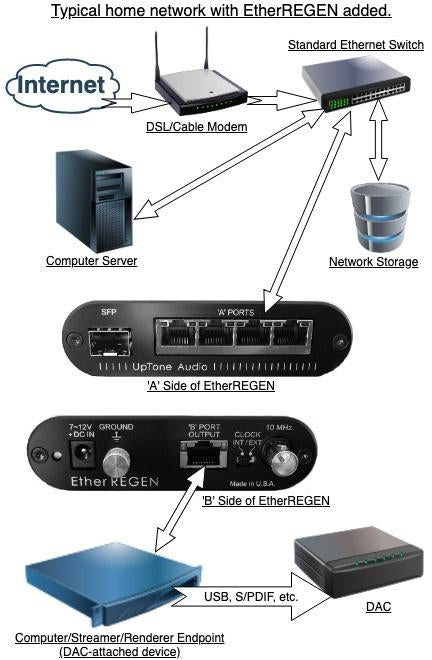

I’m not sure how the A ports of the ER are supposed to work, but according to the Uptone website you are supposed to connect the server (NO) to the standard switch (Cisco), not to the ER’s A port.
Maybe this is a question best asked to Uptone Audio if their fancy switch doesn’t work as you think it should.
