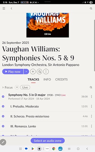

I just connected Nucleus One. It is on my android tablet and plays music there. However it will not play on my eversolo dmp 8 or chromecast. I have it usb connected to usb in input on the eversolo. I've tried sources usb in, internal player, optical 2 for the chromecast on the eversolo. What's wrong here? Please advise.

Thanks for reaching out. Just to confirm, you’ve been able to properly enable the zone in Roon Settings → Audio, or how exactly did it remain disabled? Can you please share a few screenshots of what you see when you try to press play? You’ll also need to switch to the USB as the active zone in the bottom left zone-picker, if you haven’t already done so yet.

Now it's worse. Not only can't I play on Eversolo but it's not there on the zones list. Neither is "this tablet". The only thing left is "family room speaker" which is chromecast dongle.
