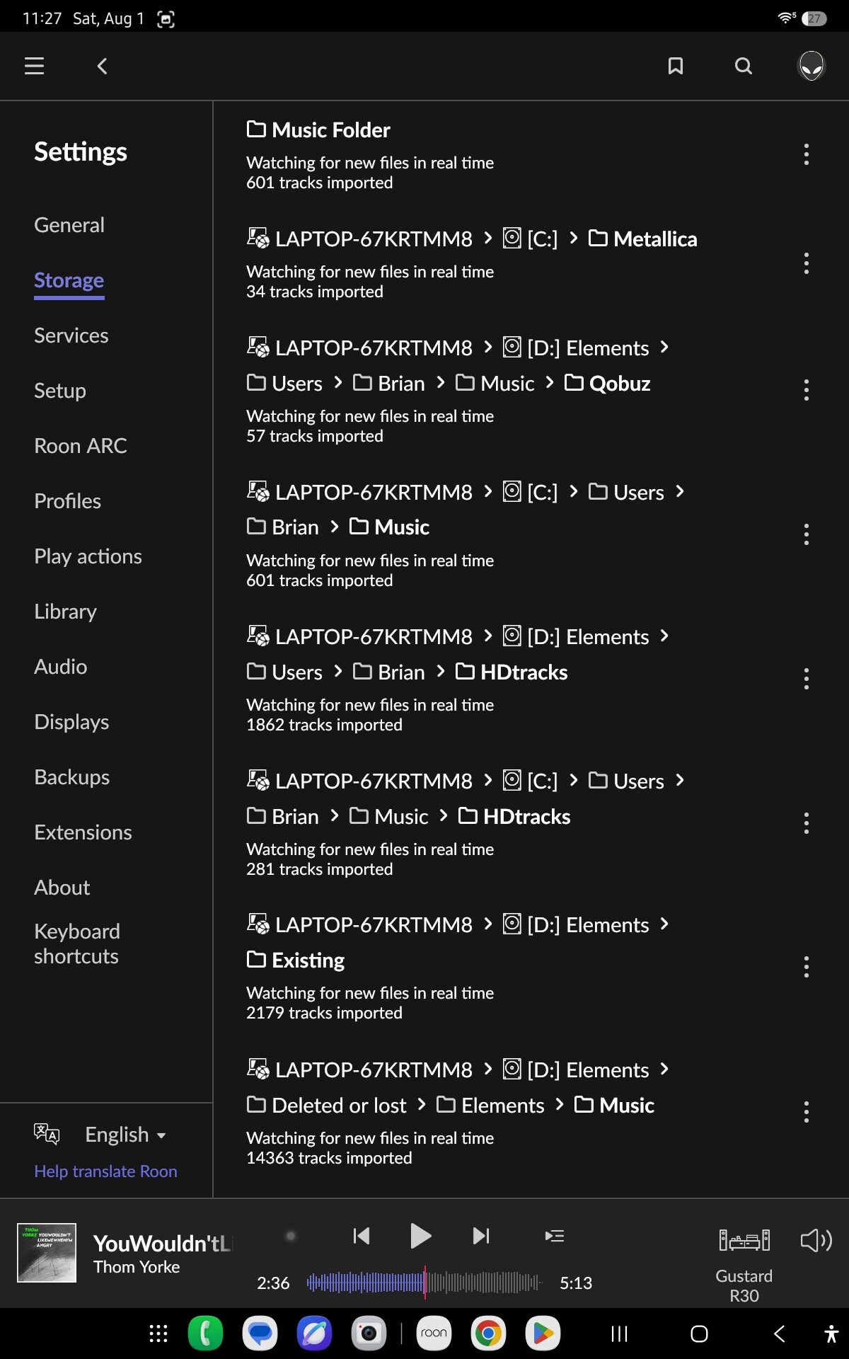

Also my playlists completely shrunk. Nothing showing on unavailable tracks from improve playlists. Do I have to redo playlists again? The playlists were reading from reconstructed/ audio folder that I had, but now disabled because I moved music from that to an iTunes folder.

There are a few things in your current setup I’d like you to fix before you touch anything else.

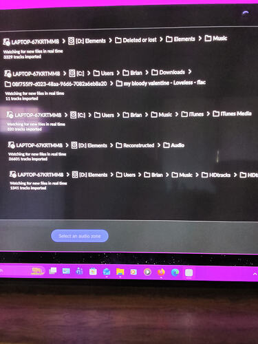

1. You already have overlapping watch folders: this is where the duplicates come from
Your Roon Server currently has 11 storage locations, and six of them are nested inside others:
On D: (WD Elements)
  • D:\Users\Brian\Music ← this is the one to keep
  • D:\Users\Brian\Music\HDtracks\HDtracks ← already inside the one above
  • D:\Users\Brian\Music\Qobuz ← already inside the one above
On C: (Samsung SSD)
  • C:\Users\Brian\Music
  • C:\Users\Brian\Music\HDtracks ← already inside the one above
  • C:\Users\Brian\Music\iTunes\iTunes Media ← already inside the one above
So you don’t need to add D:\Users\Brian\Music, it’s already there, and it has already imported roughly 34,000 files. What you need to do is take the four nested child folders back out. Every file in them is already covered by the parent, so removing them costs you nothing and clears the duplication.
2. The Reconstructed folder is not actually empty
You mentioned there’s no music left in Reconstructed > Audio. The logs disagree, Roon was still importing files from D:\Reconstructed\Audio as late as 11:54pm on the 6th, and your storage screen shows 26,401 tracks there.
It looks like that content was copied rather than moved. The same material now appears twice: once at D:\Reconstructed\Audio, and again inside D:\Users\Brian\Music as Reconstructed Audio HDtracks</code> (~6,200 files) and flac</code> (~5,800 files).
Please don’t delete anything from Reconstructed yet. Leave it exactly as it is, and we’ll sort the duplicates out once the library has settled.

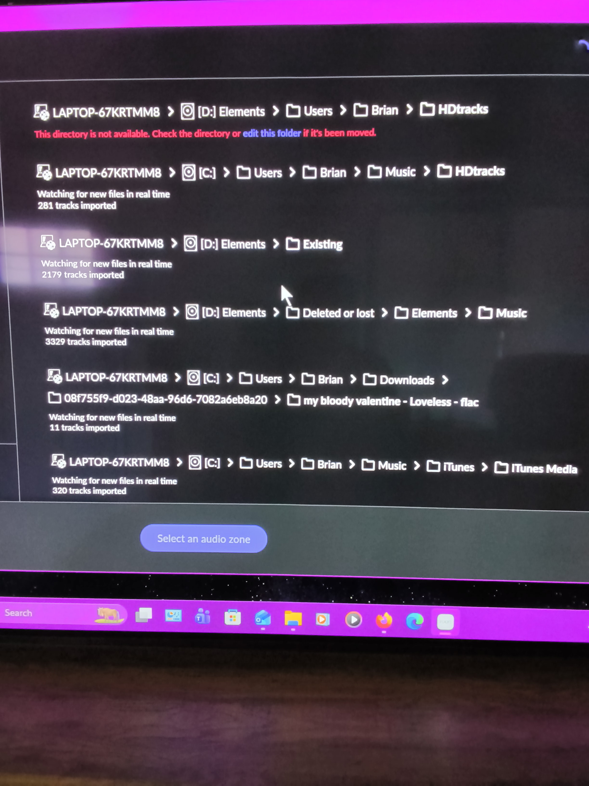

3. One stale location to clean up
Your second screenshot shows [D:] Elements > Users > Brian > HDtracks flagged “This directory is not available.” That’s a leftover pointing at a path you’ve since moved. That one is safe to remove.
4. Order of operations, this is the part that matters most
Disabling a storage location and removing one are not the same thing. Disable is reversible; remove is not, in the way you’d want it to be. Please work through this in order:
  1. Let the restore finish completely. Don’t add, remove, disable, or move anything while tracks are still importing. Watch the album count stop climbing, then give it another 30 quiet minutes.
  2. Confirm your music is visible through the parent folder. Check that your iTunes, HDtracks and Qobuz content all show up in the library while D:\Users\Brian\Music is the location doing the work.
  3. Disable, not remove, the four nested child locations, one at a time. Wait a few minutes after each one and check your library and playlists.
  4. Only once everything still looks right, go back and Remove them.
  5. Leave Reconstructed\Audio, Existing and Deleted or lost for last, and disable rather than remove.
If disabling something makes tracks disappear that you wanted, re-enabling it brings them straight back. Removing it does not.

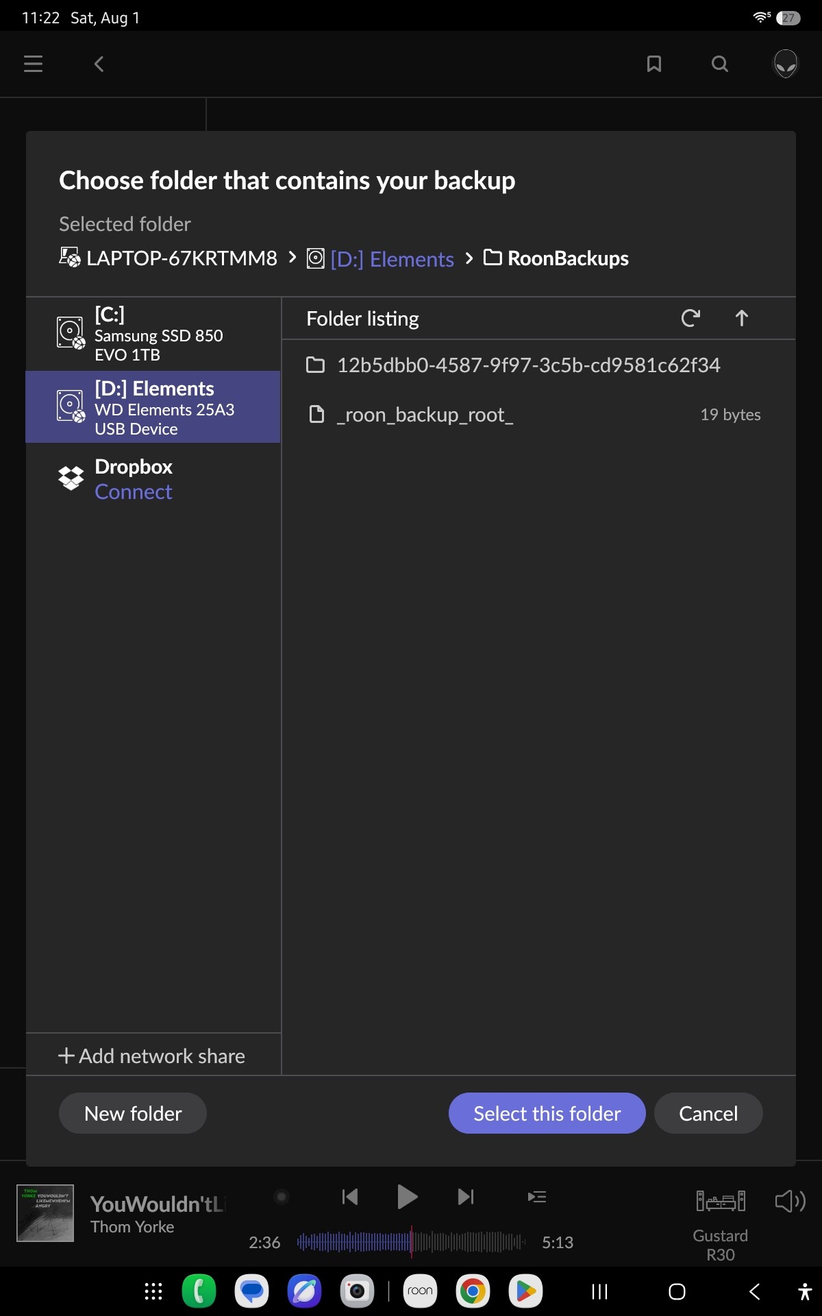

I 'm confused about roon back up. I did a manual back up under D: external hard drive. I created a new folder called RoonBackups. Then I selected that folder and roon did a back up successfully. However, I went to find backups to locate folder. It says it’s empty. I don’t know where my back up went.

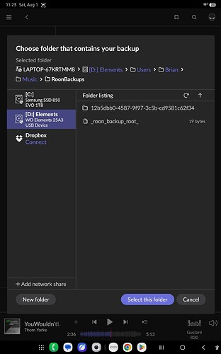

Hey @Brian_Sage,

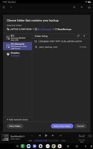

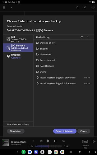

We believe what you’re seeing is expected behavior, not a failed backup. In Find Backups → Browse, you need to select the RoonBackups folder itself, don’t open it and look inside. Opening it just shows the timestamped subfolders Roon writes, which the browser doesn’t present as “backups.” The backup set only appears on the next screen, after you select the parent folder.
Two quick ways to confirm the backup is really there:
  1. Settings → Backups on your PC should show “Last successful backup at …” with the time you ran it.
  2. Open D:\RoonBackups in Windows File Explorer. You should see subfolders totaling somewhere from a few hundred MB to a couple of GB. If Explorer shows content, the backup exists.
The 14TB WD Elements Desktop is the same drive we saw in your logs (WD’s USB ID 1058:25A3 is the Elements Desktop family), so nothing is out of place there. Two things work in your favor for this move: it has its own power adapter, so it isn’t drawing power from the Nucleus One’s USB port, and it’s formatted NTFS, which Roon OS reads and writes natively.
You don’t not reformat it, that would erase your music. You don’t need to buy a portable USB drive for this.
Steps from here
On the PC first:
  1. Confirm the library looks right in Roon on the PC, track count and playlist count where you expect them, and no leftover disabled or duplicate entries under Settings → Storage.
  2. Run one fresh Backup Now to D:\RoonBackups, so the backup reflects the cleaned-up single-folder layout rather than the older one.
  3. Verify Roon can see it: Settings → Backups → Find Backups → Browse → navigate to D:, highlight RoonBackups, select it. Your backup should now be listed. If it lists here on the PC, the Nucleus One will find it too.

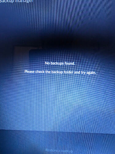

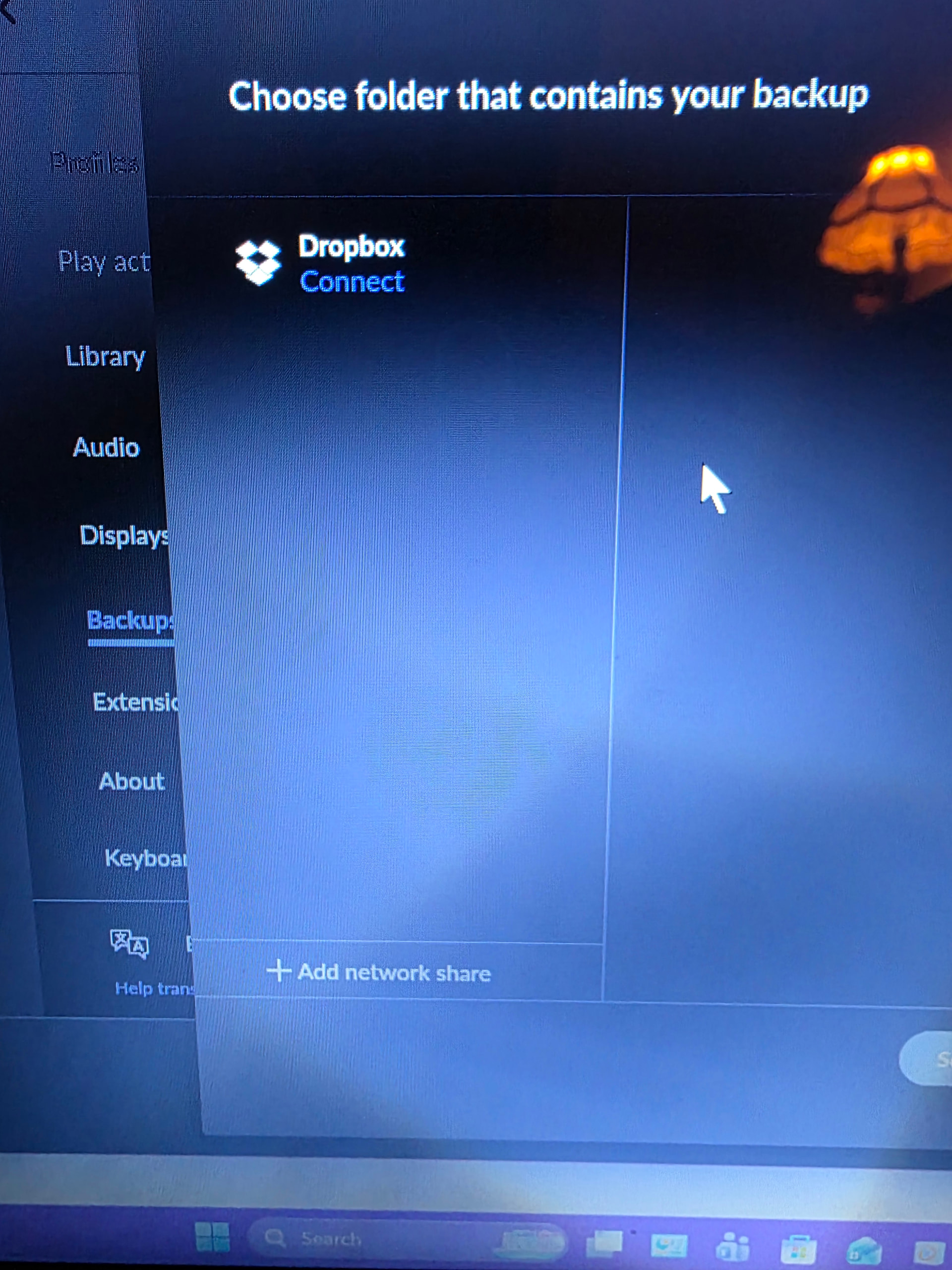

Hello.
I followed the instructions, but I can’t seem to pass this part. Look at photo. I clicked on restore and back up on the bottom of screen where you login and this is what happens. I also did a login and nucleus one doesn’tsee D external drive. It doesn’t show my D external drive. I had this problem before. If Im doing something wrong I don’t know what.
First thing I did:
Back up now. I was able to see my last restore. That was good.
Then I closed roon. Safety ejected the usb from the PC and put it to the back of nucleus one. Waiting 15 seconds. Turned on nucleus one.
Then I logged out and found nucleus one and clicked on that. Then it shows restore and back up on the bottom of screen. I clicked on that. It doesn’t show D drive or my C drive. Just Dropbox. So I’m not sure why nucleus one is seeing it.
Just for kicks. I plugged everything back to PC. I disconnected nucleus one and clicked on PC. Then I clicked on restore and back up on bottom of screen and it showed my C drive and my D external drive on left side of screen.
Any suggestions?

Hello @Brian_Sage

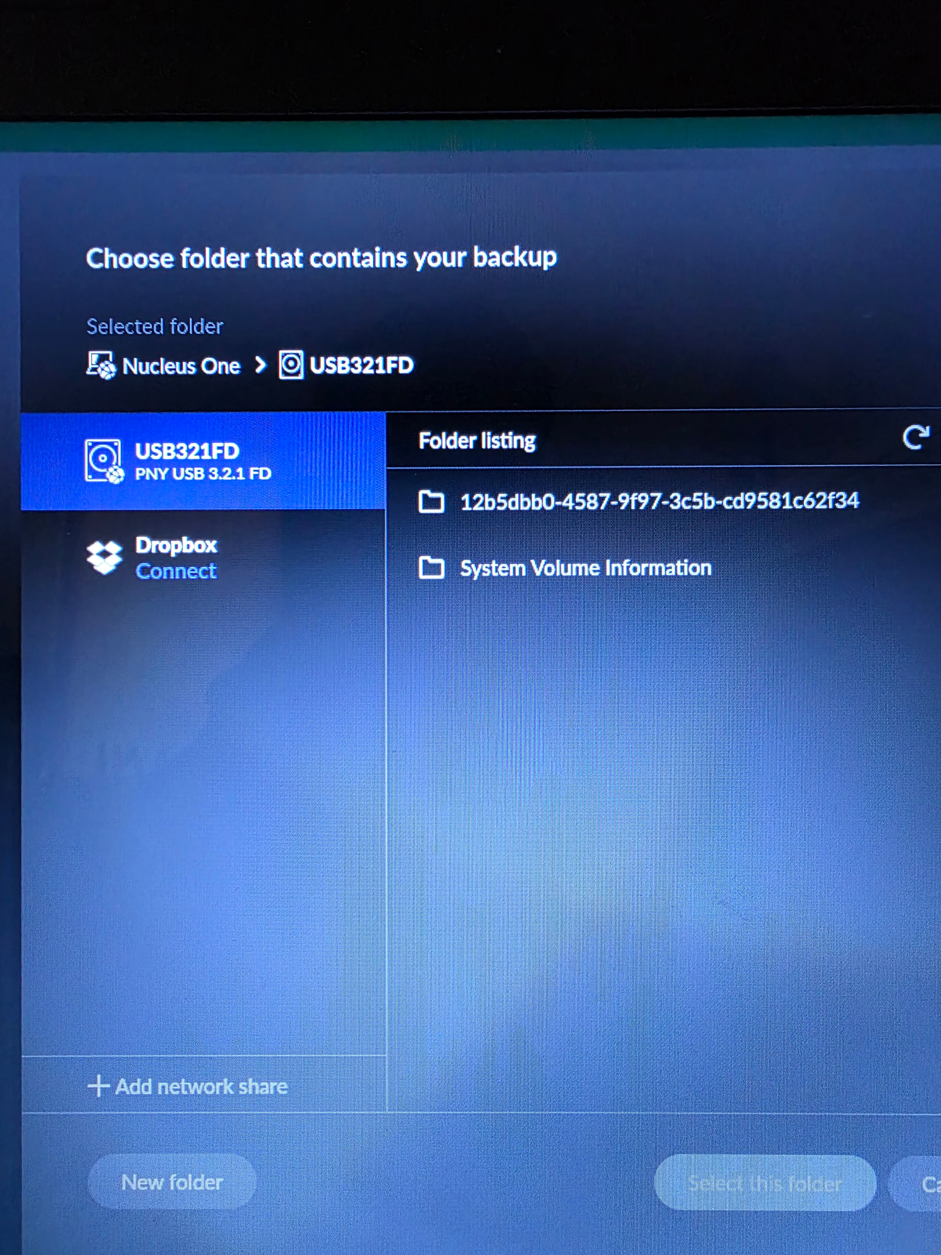

Let us take the big drive out of the equation for now. Your backup is small, so we can move it with a cheap USB stick and get the restore done, then sort out your music storage afterwards as a separate step.
Important, and please read this line twice: do not format your WD Elements 14TB drive. That would erase all of your music. The only thing being formatted below is a small spare USB stick.
Please do this:
  1. Find a spare USB stick you do not need anything from. 8 GB or larger is plenty, your backup is well under that.
  2. Plug it into your PC. In File Explorer, right-click the stick, choose Format, set File system to exFAT, and click Start. This erases the stick, which is fine, and it is the format the Nucleus One reads best.
  3. Copy the whole RoonBackups folder from your D: drive onto the stick. Copy the folder itself, not just what is inside it.
  4. Unplug the WD Elements from the Nucleus One and set it aside for now. Plug the USB stick into the Nucleus One instead.
  5. In Roon, connect to the Nucleus One and choose Restore from backup.
  6. When the browser opens, find the stick and click RoonBackups once to select it.
Please tell us what you see at step 6. Once your library is restored on the Nucleus One, we will reconnect the WD Elements and point Roon at your music, and that part is much simpler than what you have already done.

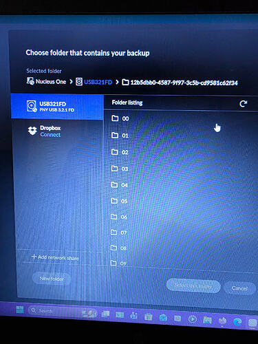

Hello.

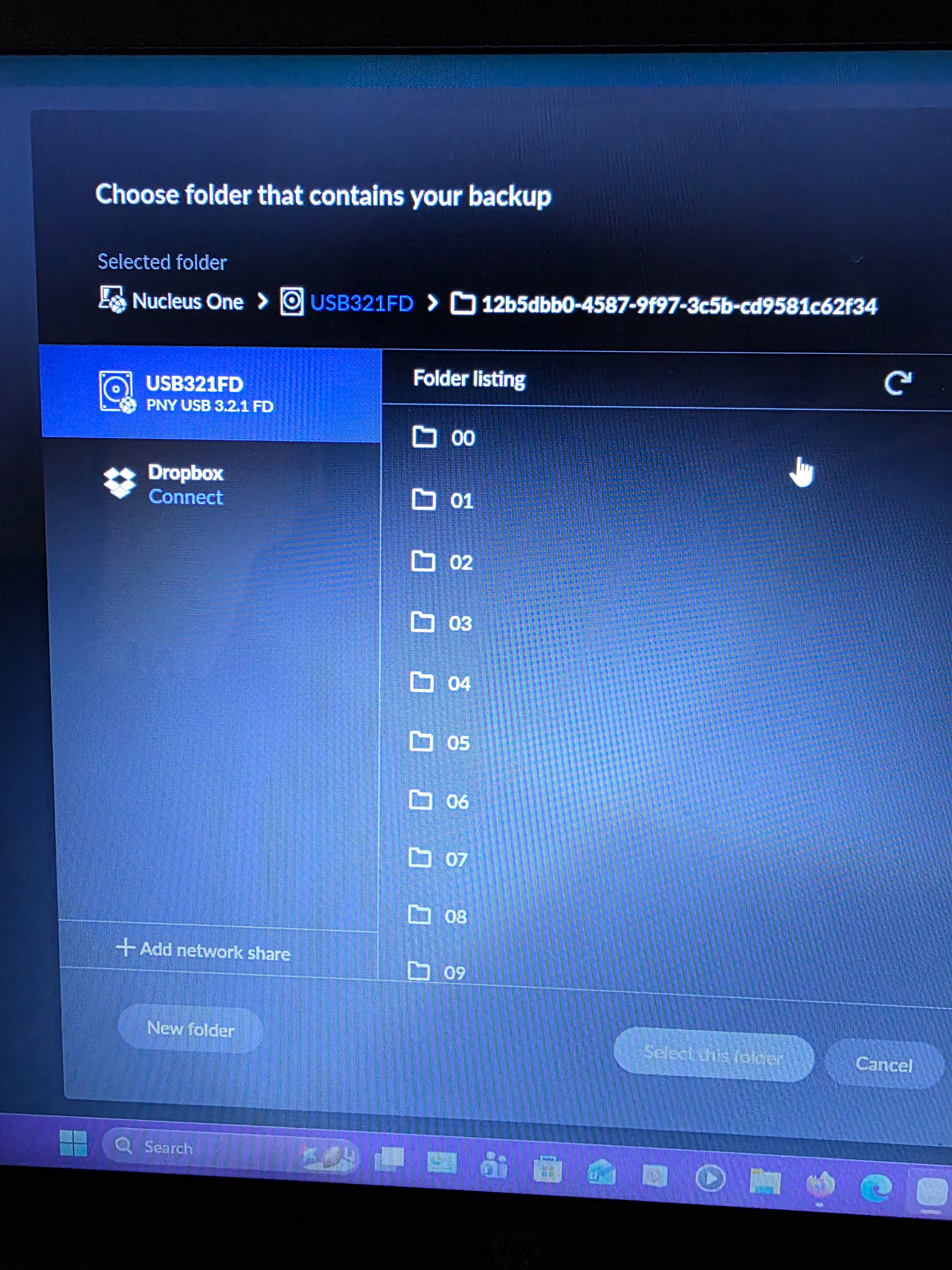

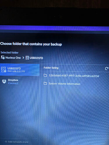

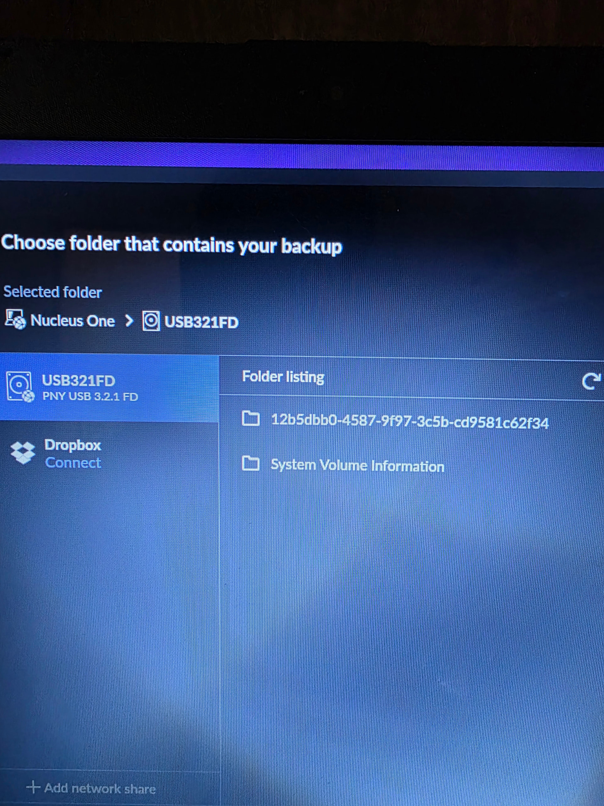

I followed the steps. I got to where I plugged the usb stick in the back of Nucleus One. I clicked restore and back up. Then it takes me to the next page. I clicked select folder. I get a message “no back up found”. But in my usb stick it shows the folder. I did as you said in the beginning choose format to exFAT before copying. It took about an hour to copy of what I just (backed up) into the stick.
Not sure why nucleus one doesn’t see it. Look at photos.

Brian
Hello.
I followed the steps. I got to where I plugged the usb stick in the back of Nucleus One. I clicked restore and back up. Then it takes me to the next page. I clicked select folder. I get message “no back up found”. But in my usb stick stick shows the folder. I did as you said in the beginning.
It looks like you haven’t copied the RoonBackups folder and it’s contents, but one of the partial backups contained in the folder. You must copy the RoonBackups folder to the USB drive.
