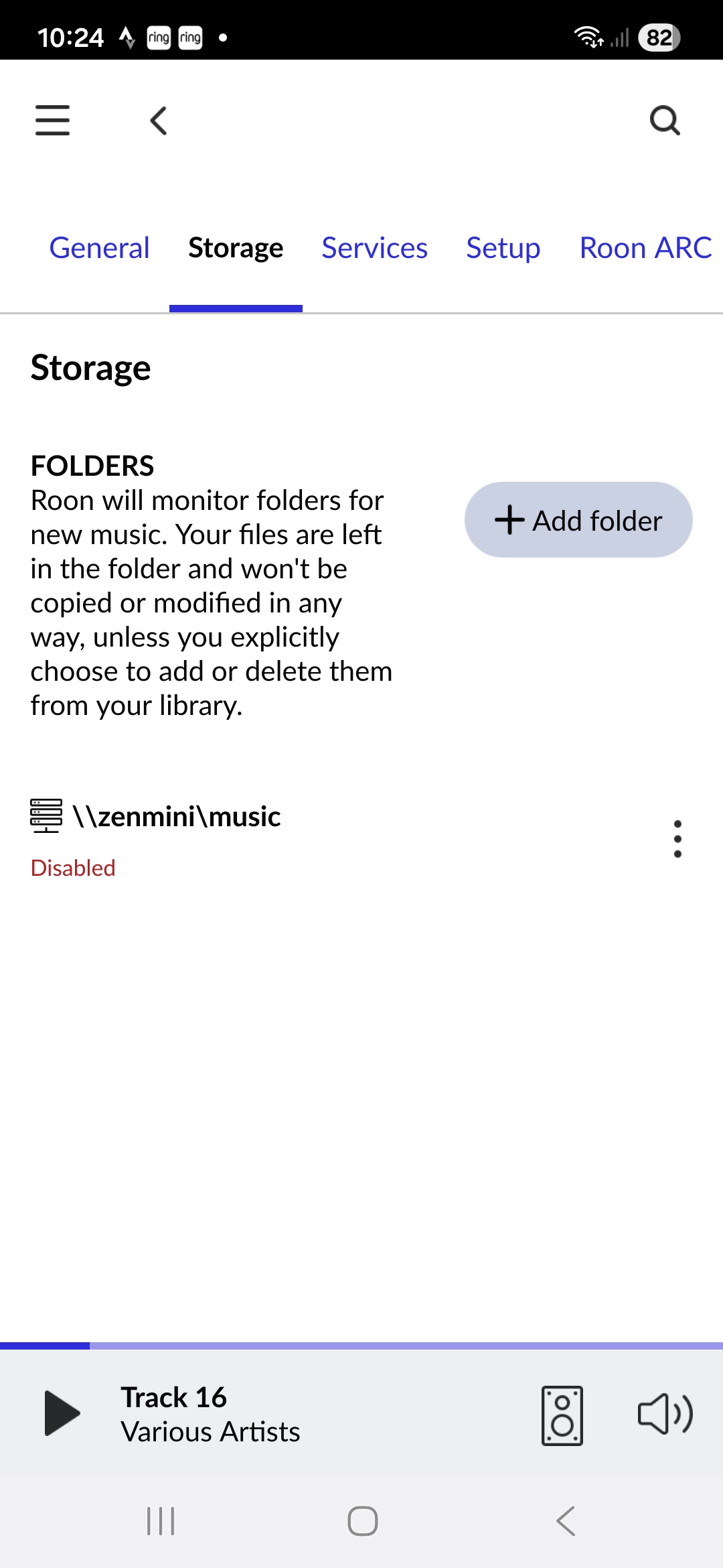

· Good morning. I have recently purchased a nucleus one to replace my aging Xen mini mk 1! It all jyst worked until recently update. All is good with streaming tidal and I set up the old zen as a nas so my ripped cds play fine for that. However I bought ssd card and have carefully installed this in the N one. I previously backed up the library to the new drive pre install. The N 1 doesn't see the drive despite a couple of re boots.

Have you first formatted the SSD drive using the Web Administration Interface of the Nucleus One? See:
You MUST first format the drive - you cannot put your local files onto it first and then install it into the Nucleus One - it won’t show up as your screenshot clearly shows.

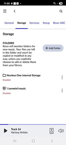

Thanks Geoff. Successfully formatted. Took a bit of fiddling to find the WAI but got there eventually. Is there an easy way to transfer the library on the Zen onto the new ssd hd now installed in the N 1 over network?
