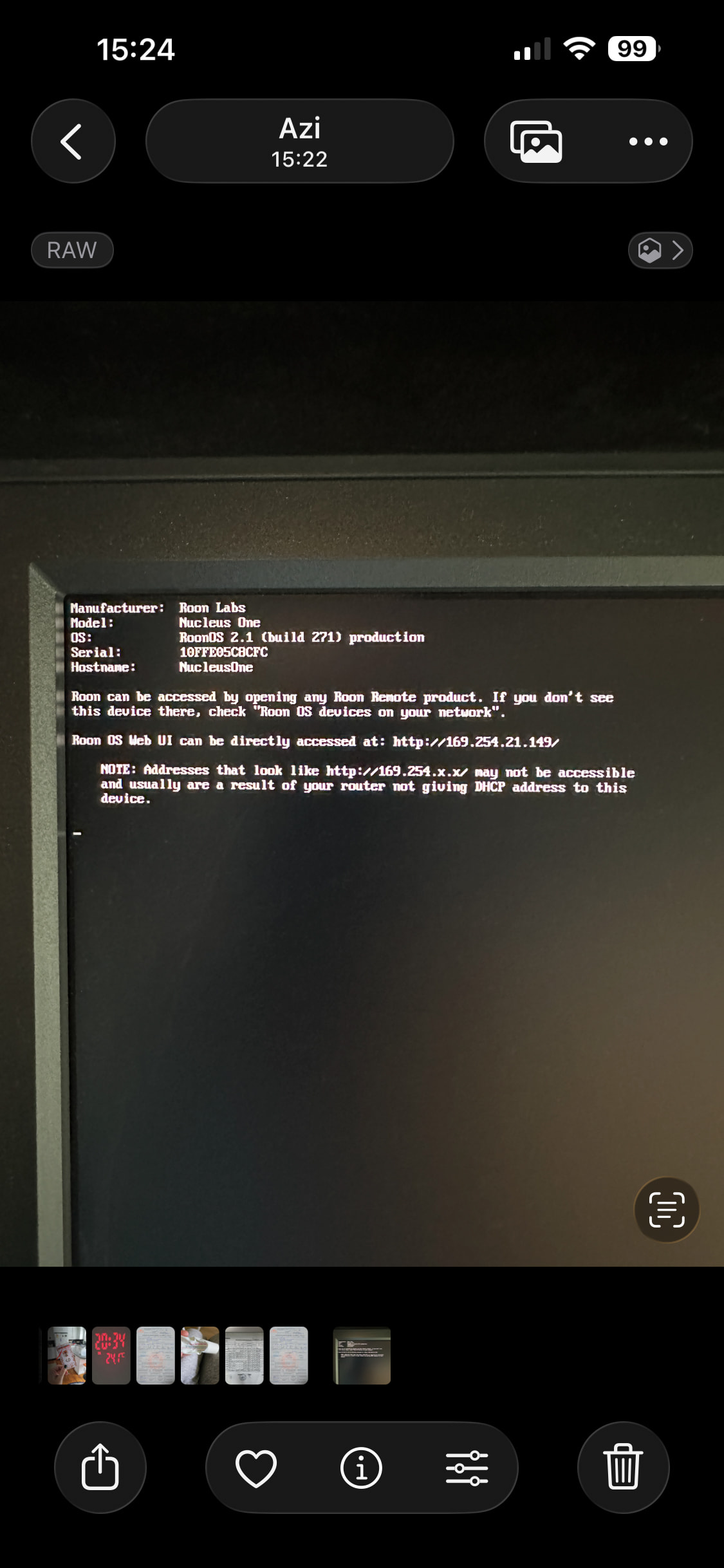

Please connect an HDMI monitor to the device and share a photo of what displays on the screen.

Are you able to access the Nucleus web administration page if the unit is powered on? Please also try the HDMI test shared above to see if the unit has a working network interface. Share a screenshot of the diagnostic output here. You can connect the Nucleus to any TV/monitor via HDMI to see the diagnostic screen.

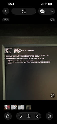

No, I’m not able to access the Nucleus web administration page. I already try the HDMI test and I have already sent it.

Thank you for providing the HDMI output.
Looking at the HDMI screen, we can see that your Nucleus is booting up properly, but it is not receiving an IP address from your network. This explains why it is no longer visible to your remote devices.
