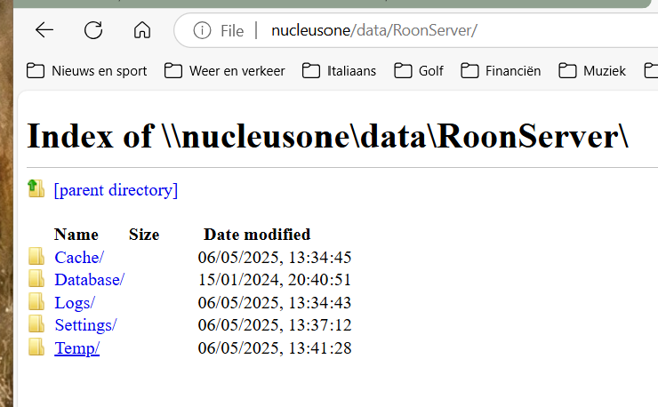

although the Nucleus One works in my network, I don’t see it in Windows Explorer under Network, so I have to use the \ to see it but then I cannot copy the logs into a zip-file because it is called a local file:
The normal functions for directories or files in Explorer do not work…

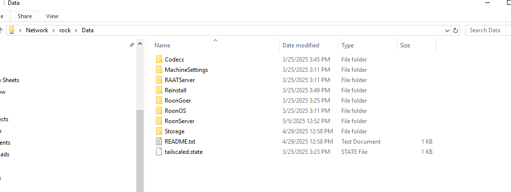

You should be looking at it under File Manager not a Web Browser. Below is my ROCK Data directory as viewed with File Manager.

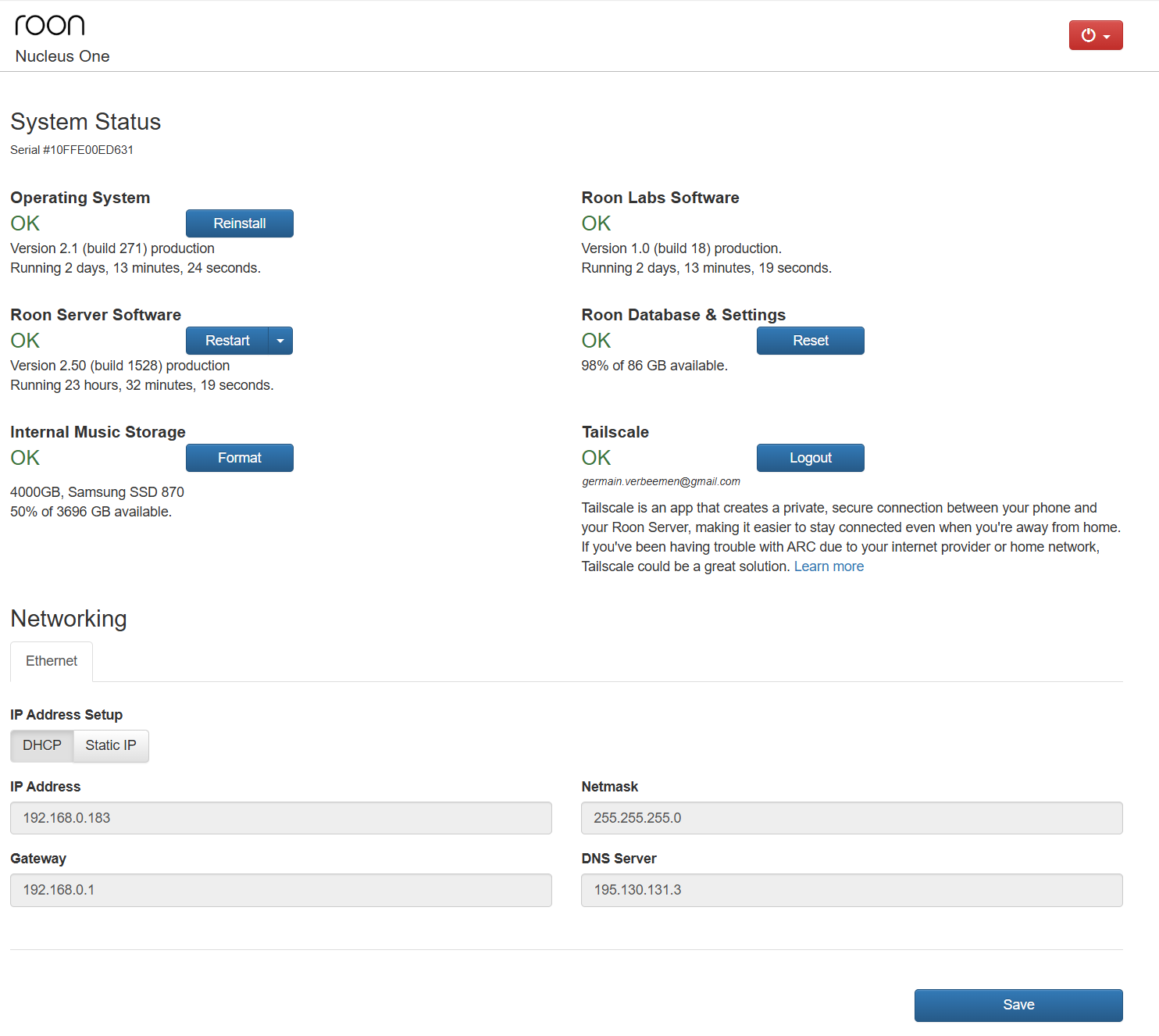

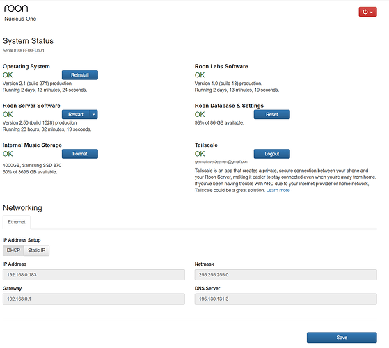

Can you share a screenshot of your Nucleus Web Admin Page? If any error messages appear there, they may help point us in the right direction.

Hi Daniel, This is the Web Admin Page, looks normal?
