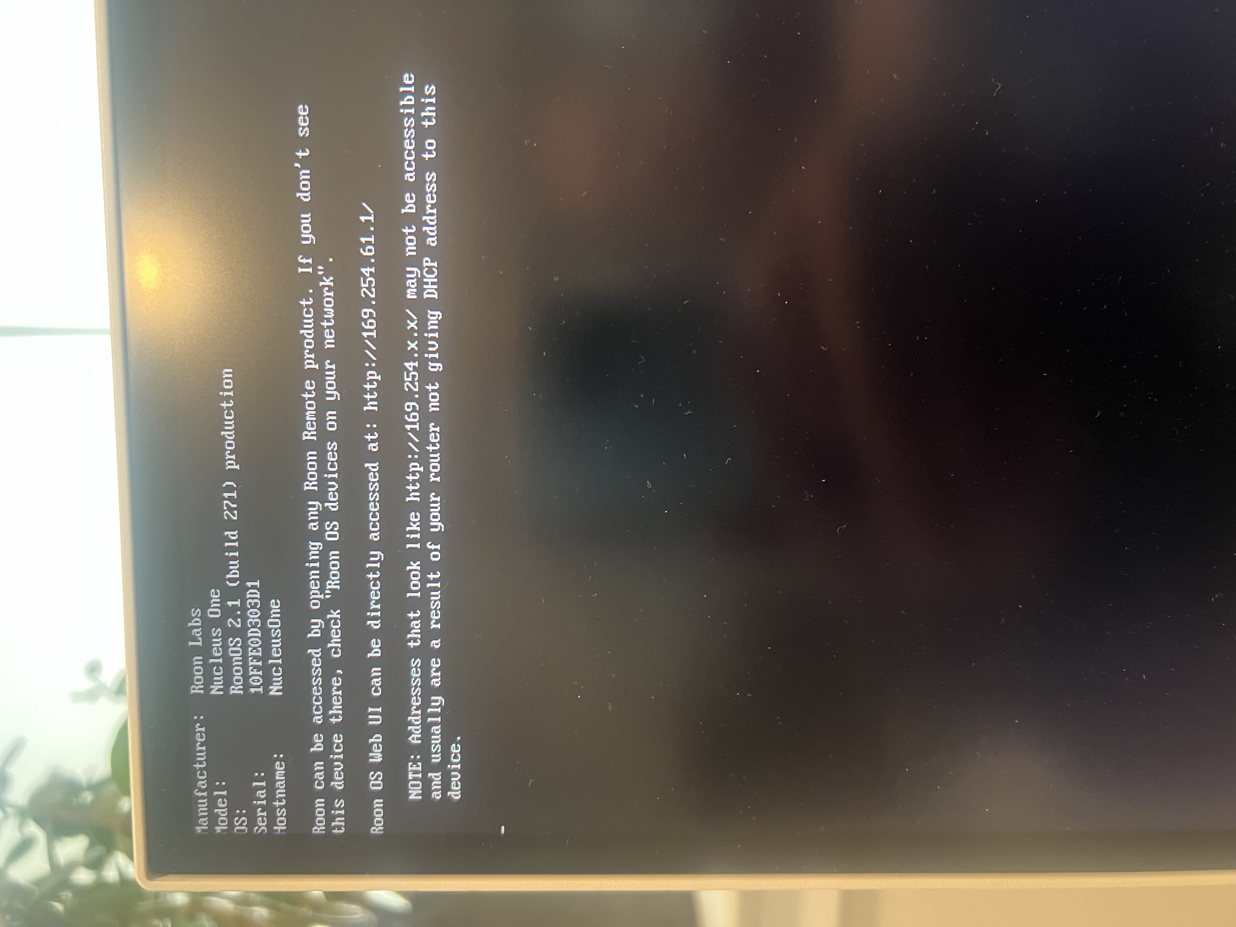

· "Roon OS Web UI can be directly accessed at [https://xxx.xxx.xxx.xxx/](https://xxx.xxx.xxx.xxx/)" and the address starts WITH [http://169.254.XX.YY/](http://169.254.XX.YY/)

Hi, I live in an apartment that uses Xfinity, has a router in my apartment, as well as ethernet ports across the apartment. Some weeks ago, the Nucleus One server stopped working. I have tried every possibility that is listed on this website. I would appreciate some step by step help to figure out what is going wrong. The server cannot be located no matter what I try.

Thanks for the screenshot and the extra network details, that helps narrow this down.
The address shown on HDMI is a self-assigned IP, which means the Nucleus One is not getting a proper address from the router. Since you have already tried alternate Ethernet ports, a different cable, a USB to Ethernet adapter, and a network settings reset, the next thing we want to check is whether Xfinity Constant Guard is enabled on the apartment network. We have seen that setting interfere with connectivity in some cases.

I typed resetnetwork as you suggested and still I cannot connect from other Roon devices.
It tells me that the Roon OS UI can be directly accessed at http://169.254.8.2/
But I don’t know how that helps me. I want to use the Nucleus One as my core and not my MacBook Pro.
So what should I do now?
A 169.254 address means that the Nucleus couldn’t get an IP address from your router. The most likely cause is the network or router, e.g., a misconfiguration or fault.
