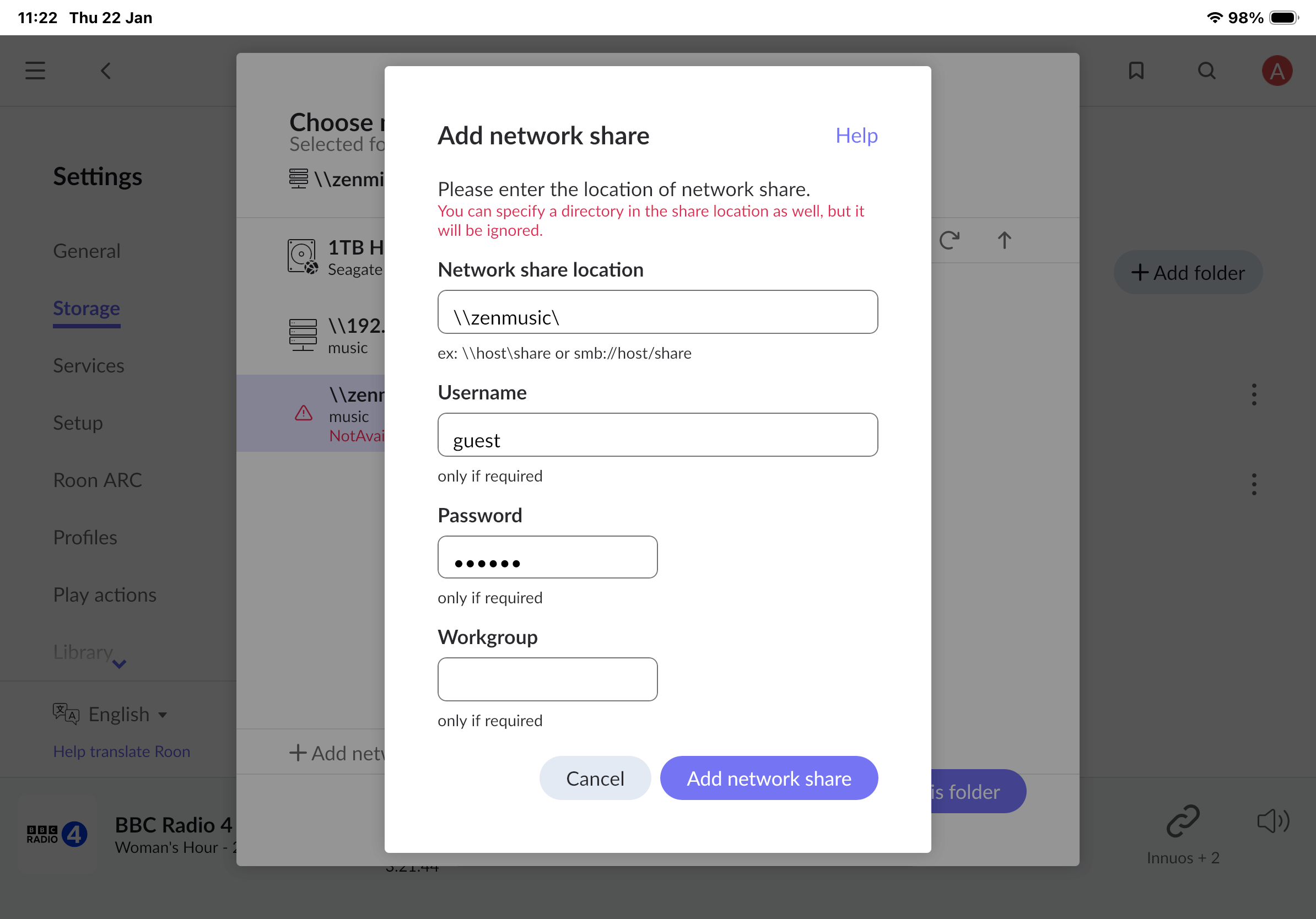

· I am using a Nucleus One as my main Roon server. I am using Roon Bridge to access my Innuos Zen Mini Mk 3 music server and ripped cd library. We had a power cut on Tuesday January 20 at 02.57. The directory to the music library \\zenmini\music was lost in the storage file. The Nucleus could no longer find the music directory. Innuos advised entering \\ZENMINI-MK3-06276\music. I also tried \\zenmini\music and entering the Innuos user name and password when adding the network in Storage. Neither storage folder addresses worked. Please can you retrieve the music folder as Innuos has stated, 'This is ultimately a matter of configuration with Roon running on your Nucleus - there is no underlying issue with the Innuos, so yes I would suggest contacting Roon or the dealer you purchased the system through'.

Hello @Adrian_Lamb,
We retrieved a diagnostic report and can see that the device was previously connected via the IP address 192.168.1.222.
We double-checked, and it appears your Zen Mini is indeed active at that address. Please try connecting using that IP.
Alternatively, if you prefer using the hostname, please ensure you are using the correct format: zen-mini-mk3-06276.
It appears you may have been using “ZENMINI-MK3-06276” which is a little improper spelling.
Please let us know if this works for you.
Thanks.
