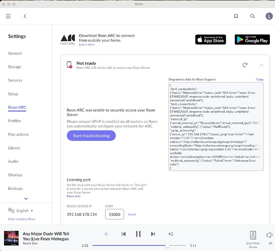

ARC:

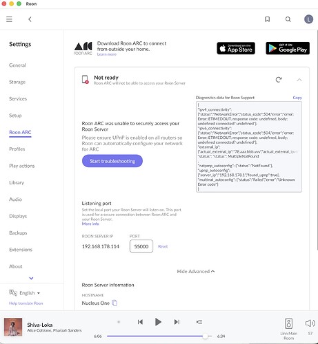

- In the Roon App on the Mac, I go to Settings - Roon ARC. After a while i get an error message “Not Ready” - see Screenshot 3.
This also worked fine previously with the Roon server on the Mac.
Again, I do not know what to do next.

ARC: Here is the screenshot requested

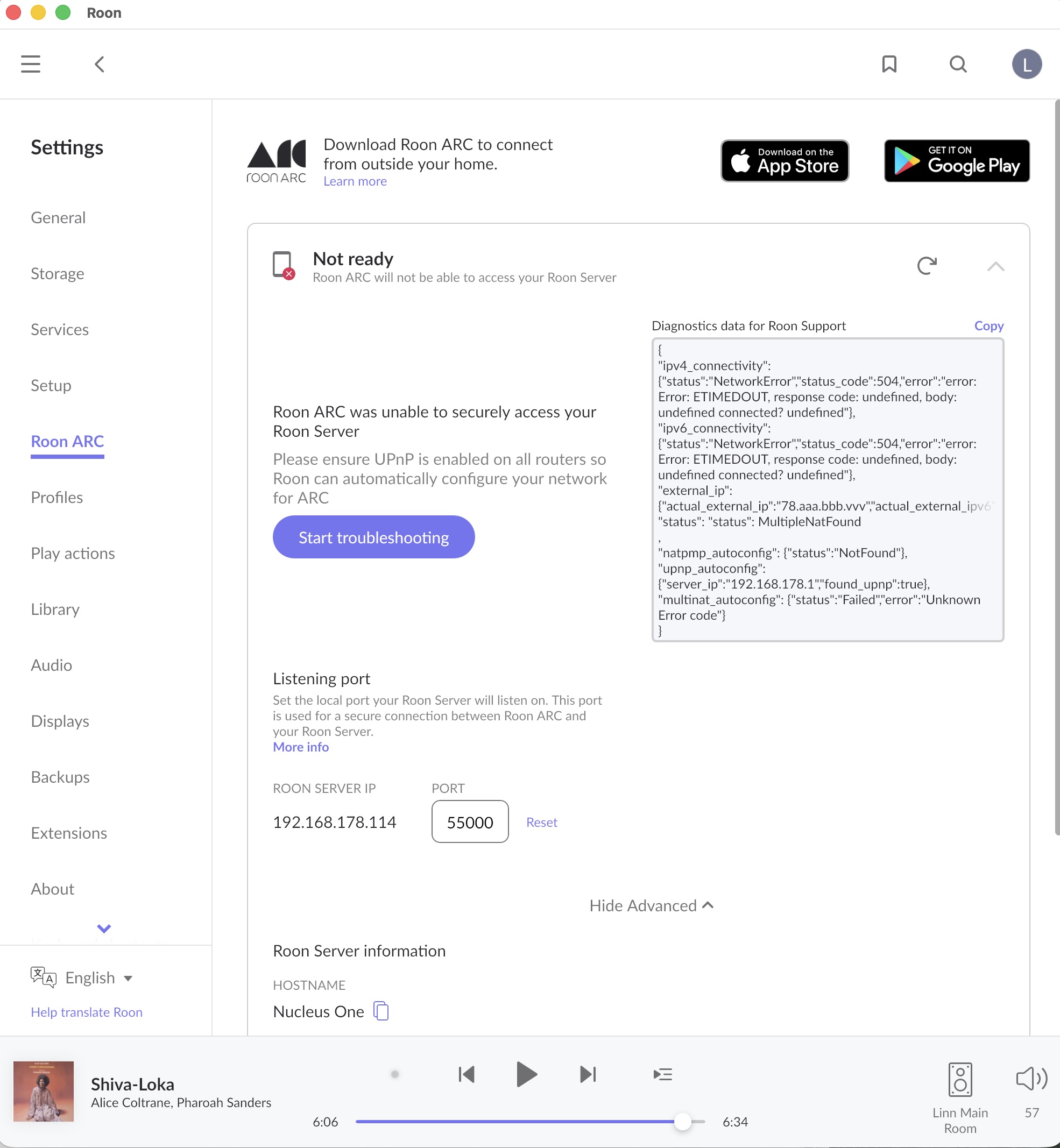

Hi Connor, thanks for getting back to me. I did manage to set up the access to my library on the NAS on the network, once i figured out the correct file path. I still haven’t figured out the correct path for my Music folder on my Mac though. And the ARC issue is odd: it seems to be working, i can access my library on my iPhone even though i still get the error message (see screenshot) in the Roon App, under Settings.

Are you over wifi when things appear to function normally?
Based on the arc error code you’ve share in your screenshot - this error indicates UPnP is available on the router but is failing for reasons not reported by the router or identified by Roon. In most cases, this means a firewall, VPN, or security software is interfering with UPnP.
Solution:
  1. Restart your network hardware and update router firmware.
  2. Try to set up manual port forwarding in your router.
    • Make sure the IP/Port matches in any port forwarding rule you create.
  3. Toggle UPnP on/off in your router settings before attempting to autoconfigure again in Settings -> Roon ARC.
  4. Double-check to make sure you don't have any VPNs, Firewalls, or other network filtering software blocking Roon.
Additional Notes:
Routers with outdated firmware will oftentimes not allow UPnP to run until the firmware has been updated. Similarly, certain VPN or proxy server configurations will cause this message. This message will also appear when enterprise-grade networks have certain filtering in place or are blocking UPnP despite it being enabled on the upstream router.
Let me know if the above help, thanks Luc!
Hi @Luc_Wagner,
We wanted to reach out to see if you still required additional assistance with this issue. What do you currently see in ARC Settings under the server and cloud connection status (green light, red light, etc.)?
Hello Connor,
i still have the same problem, ARC doesn’t work when i’m away from home. I’m afraid your troubleshooting explanations are a bit too technical for me.
Is there an other way you can help me ?
Thanks
The error message indicates you have “MultipleNATFound”, which can be a number of things. It means your device is sitting behind 2 NAT devices like routers. This could be because you have 2 in your house, it could also be because of your Internet Provider.
Make sure you have a Public IP address, if not, your Internet Provider probably has given you a CGNAT address. a Public IP address might cost more depending. I would contact your ISP and ask.

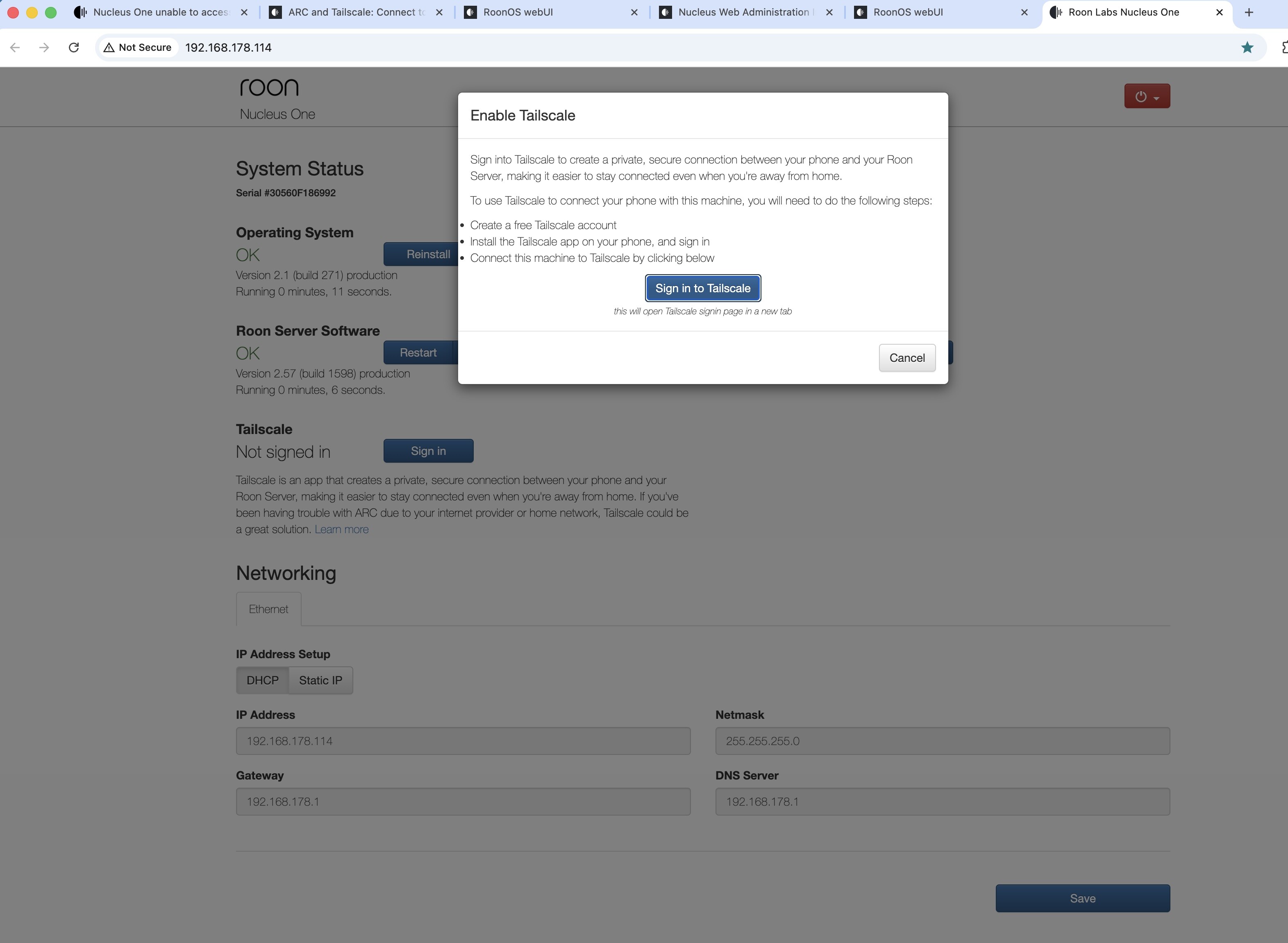

Another options would be to run Tailscale scale on your mobile device and activate it on your Nucleus. Tailscale is a VPN and that will get around having to setup Port Forwarding in ARC since you’ll be using Tailscale instead.
Here is the FAQ:
I would still contact your ISP to verify that you are indeed have a CGNAT internet connection as a first step.
Hi,I do not have a public IP address. I’d like to mention that ARC worked fine before when i was running the Roon server on my Mac. Only after installing the Nucleus One it didn’t work anymore (so the Nucleus One sort of defies its purpose). I use a FritzBox to connect to the internet at home. There’s a router behind the FritzBox to connect all my devices to the LAN. Both the Mac and the Nucleus One are connected to it. So if ARC connection was possible before with the Mac, why is it not working with the Nucleus One, as they are connected in the same way ?
I also tried Tailscale, by downloading it to the Mac and to the iPhone. When trying to sign in from the Roon Nucleus One admin page, a window pops up as in the attached screenshot. But then after clicking on the “Sign in to Tailscale” button, nothing happens !
What should i do now ?
Thanks
(This stuff is complicated, and the instructions are not terribly helpful …)
Sorry, forgot the screenshot
