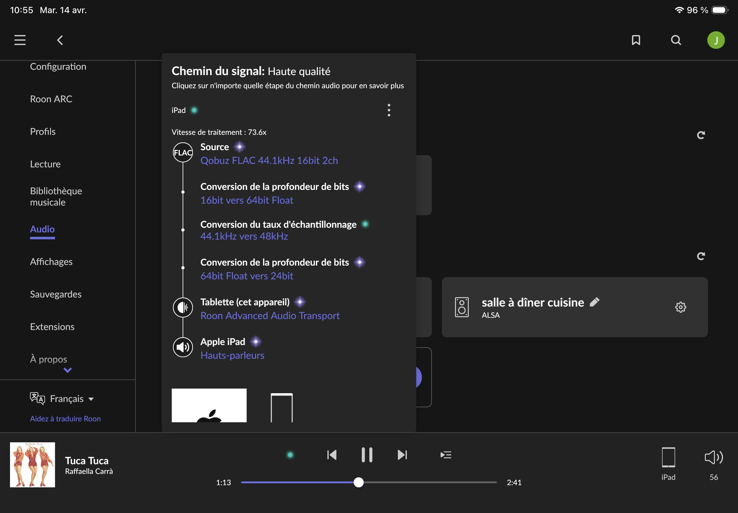

· My Roon App doesn't recognize my DAC audio sources. In fact, they are visible on the screen and enabled but no sound will come out of them. Meanwhile I get the sound on my iPad or my computer if these sources are enabled. It seems that the Nucleus One doesn't connect to my 2 DACs even if they are enabled.
This happened since I last opened my application and got the last update.

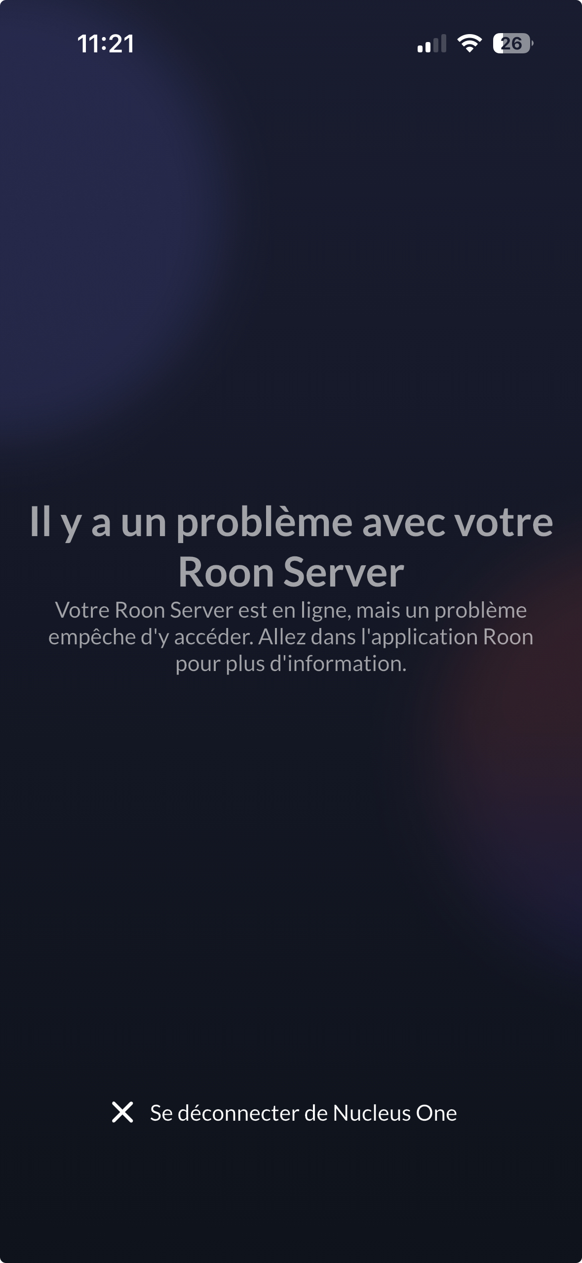

Also, the Roon application says that ARC can securely access my Roon Server. But when I open ARC on my phone, it says that my Roon Server is on line but a problem prevents ARC from accessing it.

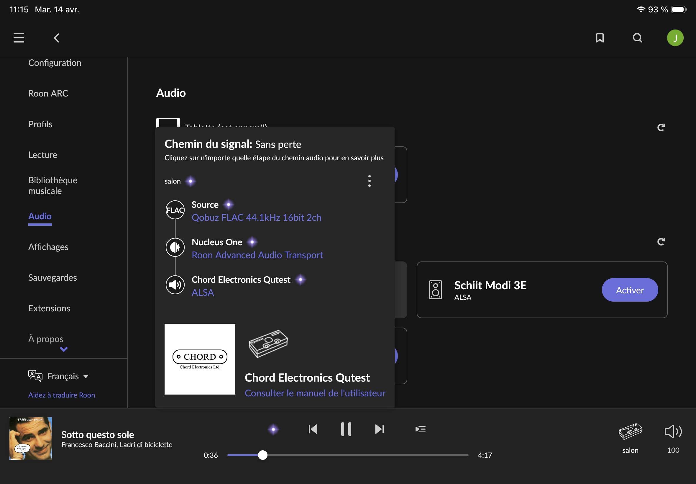

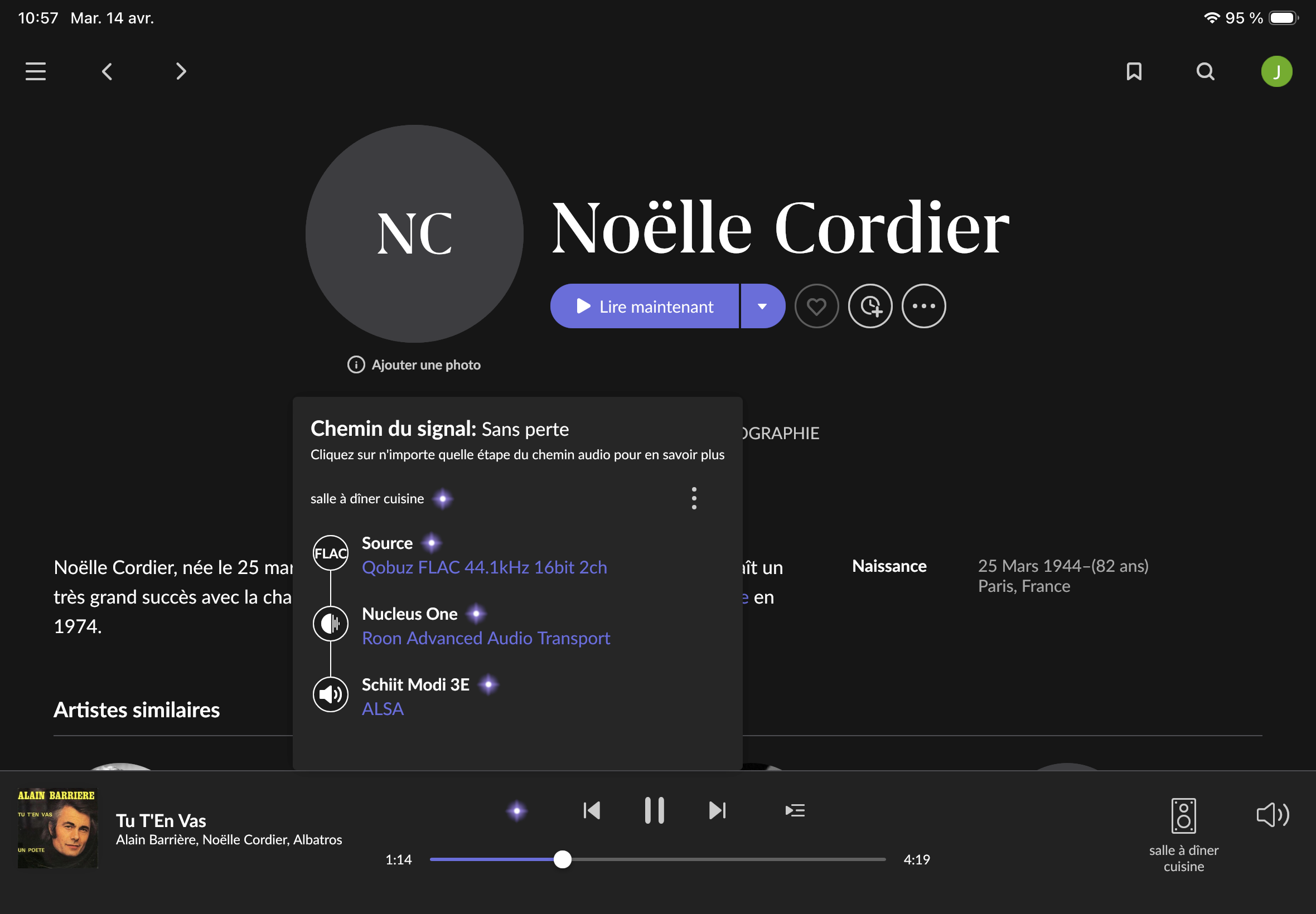

Can you please share a screenshot of your signal path when the issue occurs? Here is more information on the signal path:
Thank you!
Hi Benjamin,
I was reading the signal path document in order to share the screenshot you asked for. Then I stopped and decided to try again my system and see if it works or not. And, SURPRISE, it works now. First the iPad sound came out. Then the Schitt Modi DAC and finally, after numerous tries, at last the Chord Qtest worked too.
I have to say it took me reveral attempts before it all worked. But now, I’m in business. However, I don’t know what caused all this and frankly, if there is a way not to live this whole drama again, I’d like to know it and prevent it.
Thank you for the support and please let me know if you can help me to avoid such another episode.
Jacinthe
