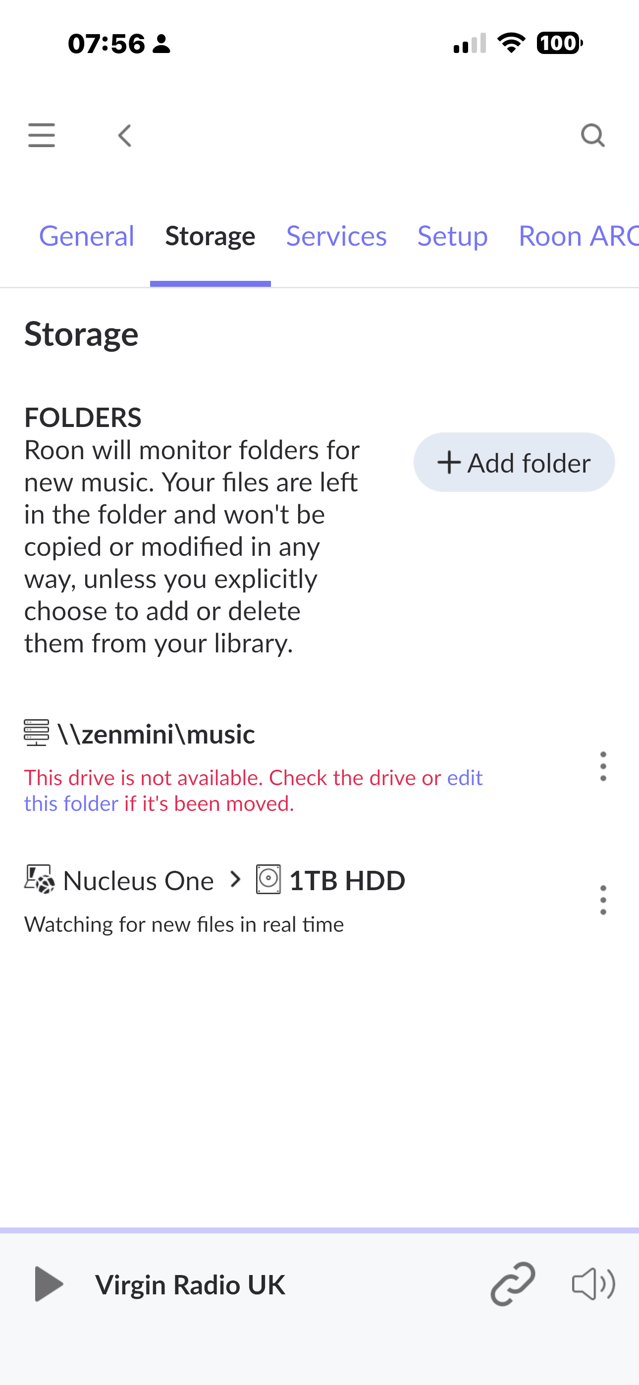

· I am using a Nucleus One as my main Roon server. I am using Roon Bridge to access my Innuos Zen Mini Mk 3 music server and ripped cd library. We had a power cut on Monday 02 March at 13.30. The directory to the music library \\zenmini\music was lost in the Roon storage file. The Nucleus could no longer find the music directory. Innuos advised entering \\ZENMINI-MK3-06276\music. I also tried \\zenmini\music and entering the Innuos user name and password when adding the network in Storage. Neither storage folder addresses worked. Please can you retrieve the music folder as Innuos has stated, 'This is ultimately a matter of configuration with Roon running on your Nucleus - there is no underlying issue with the Innuos, so yes I would suggest contacting Roon or the dealer you purchased the system through'.

We’ll watch for your response. Please also share a screenshot of the dialog window within Roon Settings → Storage when you attempt to add this network share.

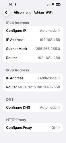

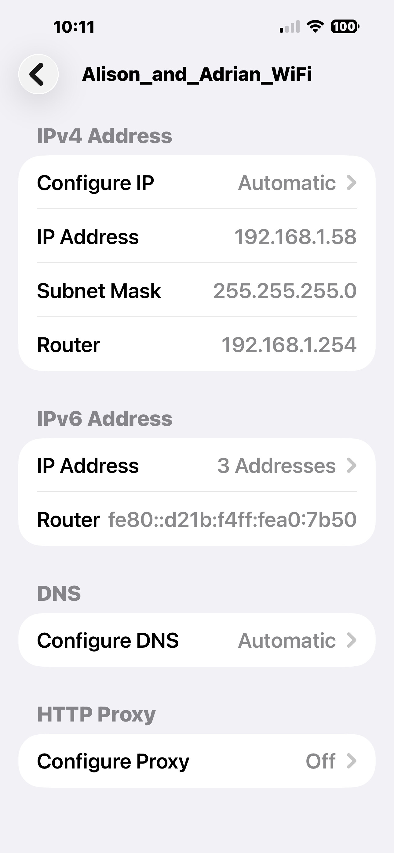

Innuos informed me that the IP address of the zen Mini is as attached. Thanks Adrian Lamb
This is the network router ip address
@Adrian_Lamb ,
Can you please try to edit the path of zenmini in Roon and use IP instead of host name ?
