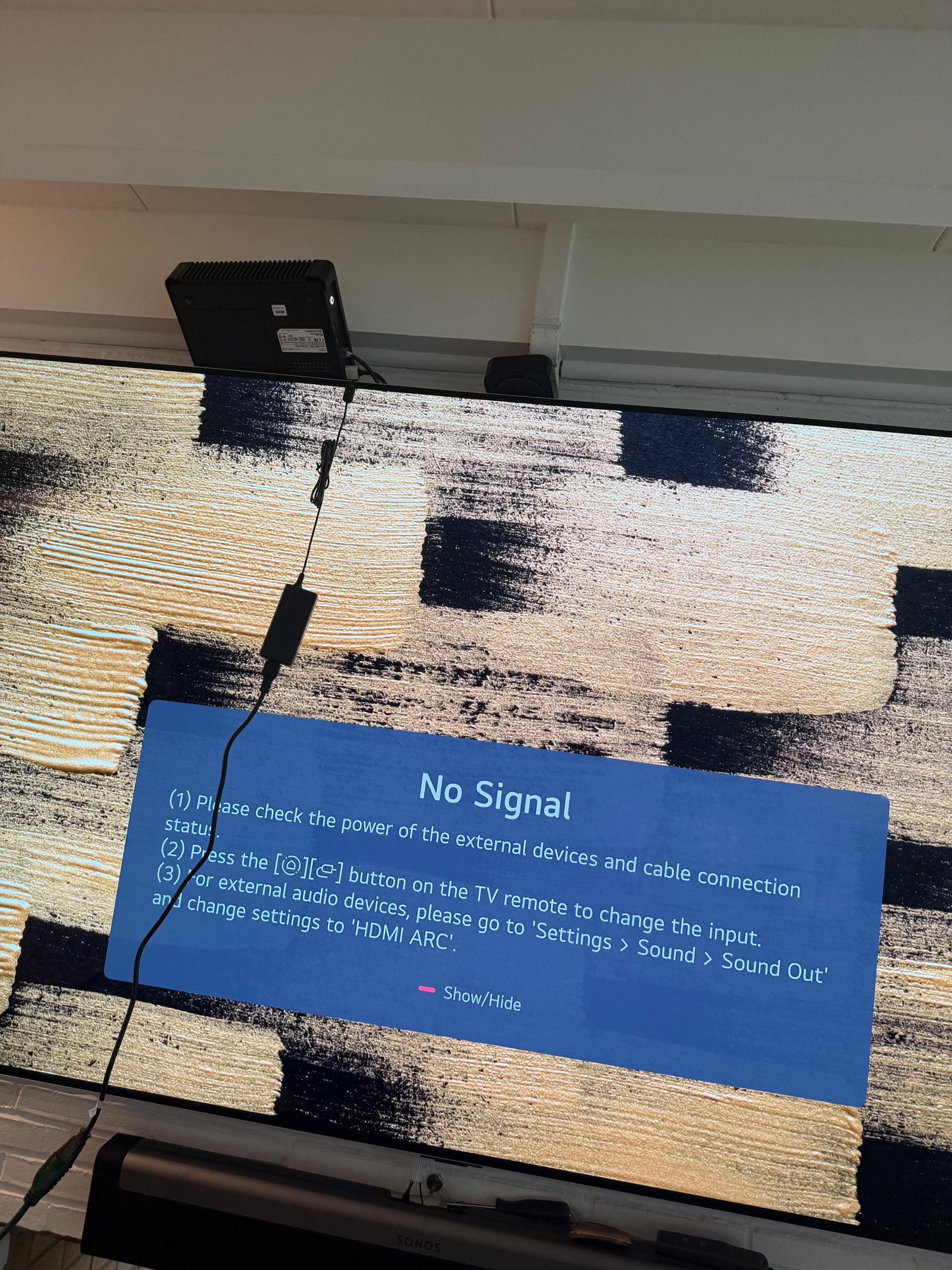

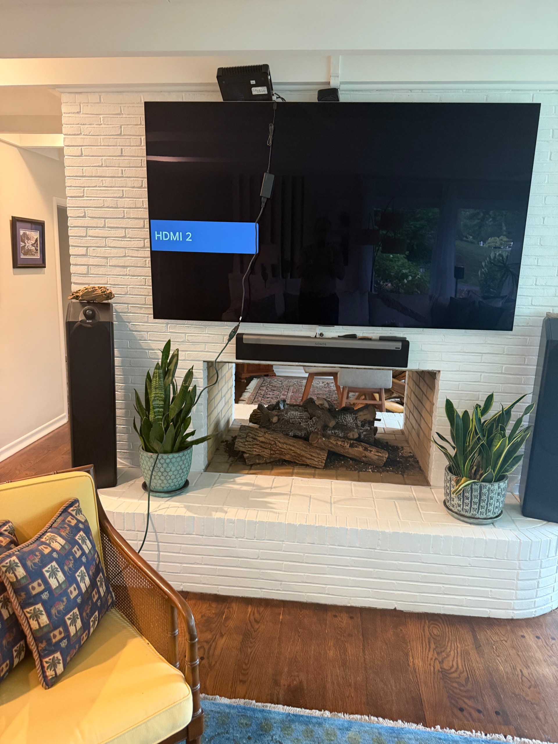

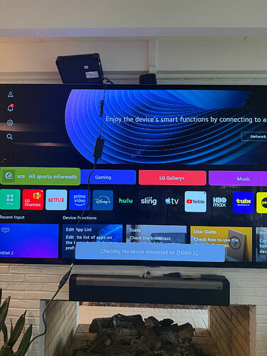

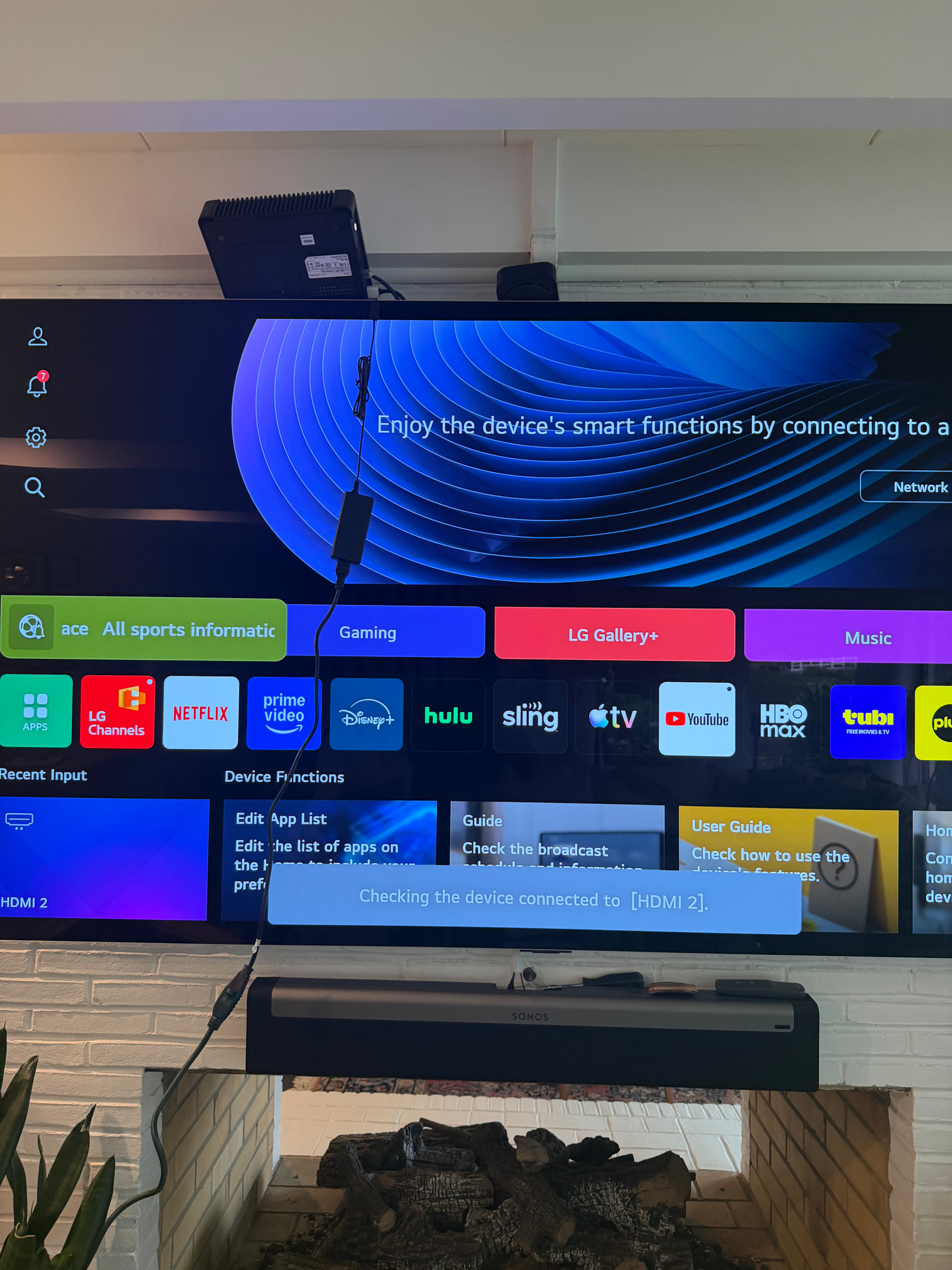

This is the best I know how to do my HDMI test. The room is hooked to my TV, powered and the TV does not recognize the unit as a source. Any other recommendations would be fine, however, I am tired of this and there’s something defective with this unit and I want a new unit. I’m tired of not having my music through Roon. It worked just fine and then it didn’t.
