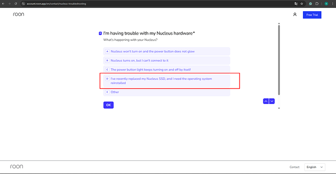

After completing the recovery process using the guide provided by @Geoff_Coupe, please open a new request with our RMA team so they can remotely reinstall the Nucleus operating system.
To do this, please start a new support request via the Get Help button, select Nucleus hardware issue, choose your Nucleus model, and then select:
“I’ve recently replaced my Nucleus SSD, and I need the operating system reinstalled.”
